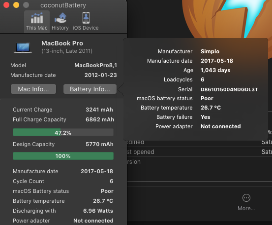

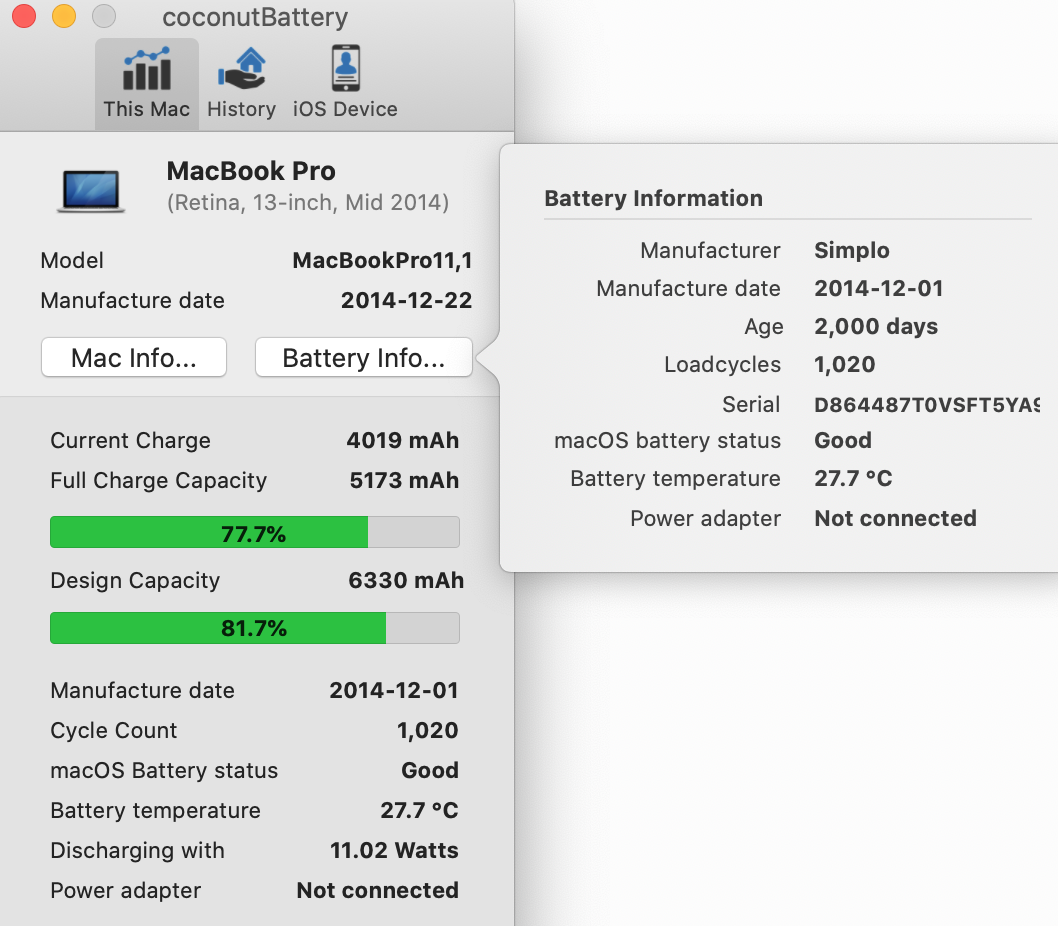

Branded “Simplo”? Maybe?
I don't think that's an issue.
What is interesting is someone earlier noted that every Simplo battery shared the same serial in coconut battery. Yours shows the same one. I wonder if it's possible that there's some kind of bug in the reporting, though, rather than them being fakes with the same serial?

Decided to check out Coconut Battery. The Apple battery I finally took out of the box after sitting for a few years has been working well. I have noticed it doesn't drain as fast when the lid if closed or open and using. I was surprised to see this poor health status. I am going to ignore it.
Yeah, mine reads 100% design capacity, but poor health. Maybe that's tied to the charge being 47%.
That's weird. It shouldn't because that doesn't determine the battery health. Give it a good 10 discharge cycles and see what it says then.
Hopefully it's not an indication that the design capacity reading is faulty. That happened to one of my batteries. It read 100%, but it was behaving like it was 50%. It kept reading 100% but then one day it collapsed right down to 40% and just kept going lower.
Yeah, I’m not going to think twice about a reading from coconut battery. The eyeball/user test is that it’s working quite nicely.

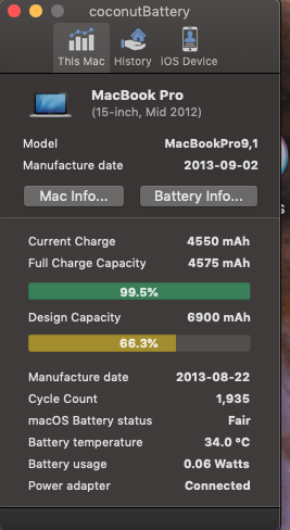

I bought my 15 inch Mid 2012 MPB new in fall 2013; today I am at over 1900 cycles. Although I leave my MacBook always plugged in, I am going to chance the battery as I am worried about possible swelling and want to keep my MPB running for at least 1-2 more years (I just do web browsing and very basic music productions).
I would like to get a real Apple battery, however, I hear mixed things if Apple even has them (i.e., an Apple employee in December told me it's no longer supported and to buy a 3rd party one but some people online say you still can) and with COVID I have no idea when I'll be able to go into an Apple Store. Also, would Apple even do the upgrade if I installed non-stock hardware (i.e., an SSD and more RAM) into my MacBook?
I ordered a battery from OWC that I plan on installing in the next few days once my 16 gigs of RAM arrive. As long as the battery allows me to use my MacBook for a couple of more years without the fear of possible swelling from an old battery, I'll be very happy. I'll update you guys on my experience.

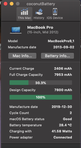

Thank you for your reply! I was bored today so I decided to put the battery in anyways; I followed OWC's guide on Youtube. I'm charging it back to full now after draining the battery and letting it sit overnight. CoconutBattery says that my battery was made in very late 2019, so hopefully I got a good one! So far my MPB is running about 20 degrees cooler. We'll have to see how it goes...
I planning on rarely using my MPB on battery power, so as long as I get 2 more years without swelling, I'll be a very happy camper.
