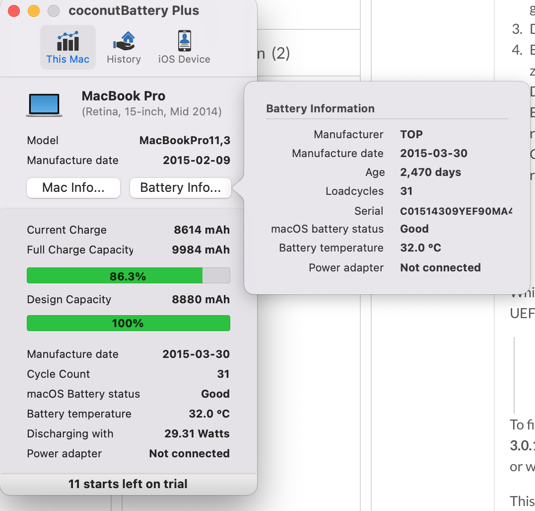

im looking for a replacement battery for my mbp late 2013 (11,3). I see that you bought the exact battery model I would need.
How has been your experience so far with this Rewa battery? Any cons?
startergo
macrumors 603
Sep 20, 2018
5,021
2,283
So far so good. This was the only battery from many tested that did not come failed on delivery.
Reactions: dbgt

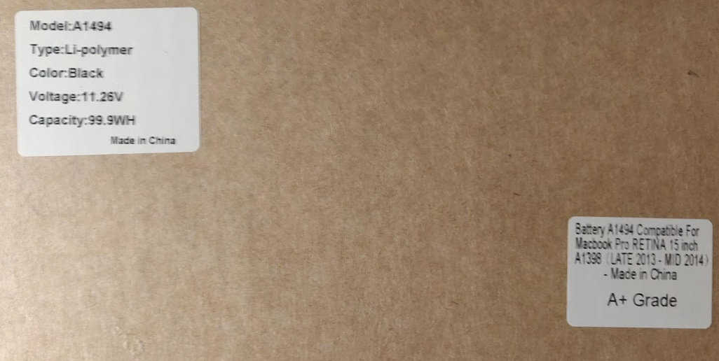

Also @JPack since you appear to be quite familiar with the supply chain side, I noticed that the rewa batteries for the retina macbooks are A+ (compatible materials) as opposed to the S+ ones (original materials) on their iphone battieres. Does this indicate that for the rmbp batteries, rewa's batteries do not use original cells (i.e. LG or whoever makes them for Simplo) or BMCs?
