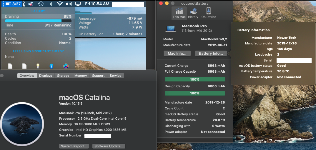

Thank you for your reply! I was bored today so I decided to put the battery in anyways; I followed OWC's guide on Youtube. I'm charging it back to full now after draining the battery and letting it sit overnight. CoconutBattery says that my battery was made in very late 2019, so hopefully I got a good one! So far my MPB is running about 20 degrees cooler. We'll have to see how it goes...
I planning on rarely using my MPB on battery power, so as long as I get 2 more years without swelling, I'll be a very happy camper.
That’s good news. I’m sure it will perform well for a year and then maybe in year two you will notice a faster drain. I am on my fourth battery counting the original. I just want to be able to sit on the couch for a few hours wire free. So far, my current eBay Apple OEM battery is the best yet, but the funny part is coconut tells me it’s failing or something like that. It’s got like 10 cycles on it.

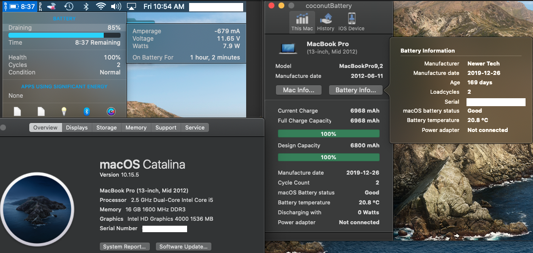

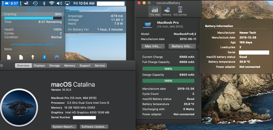

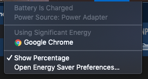

With my OEM Apple battery it used to show the status when I would click this; I assume not showing it is normal for 3rd party batteries?
My new (1.5 years old) replacement battery from Amazon is coming up as service battery. It really is discharging quickly and I just attributed it to these machines not managing power well.

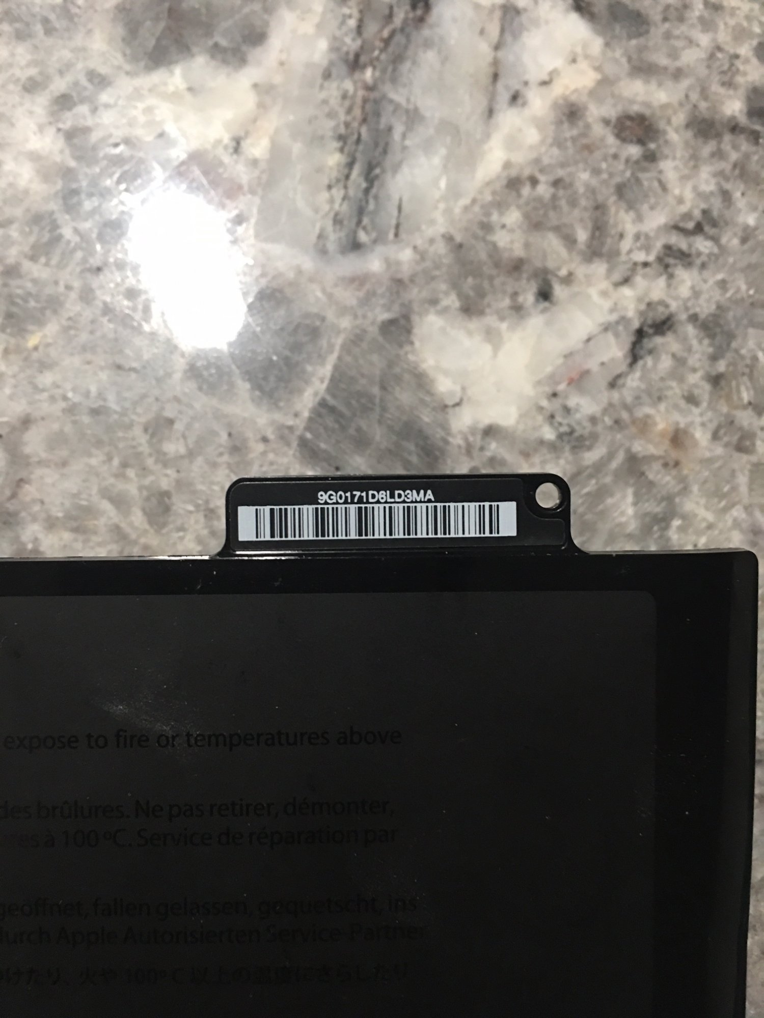

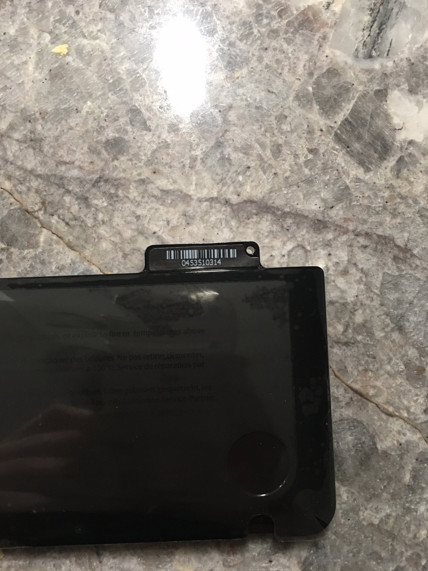

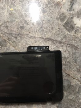

I recently fell for the new "oem" battery crap too. I bought a $70 "OEM" battery just like Hallux and LarryJoe33. It is NOT OEM.

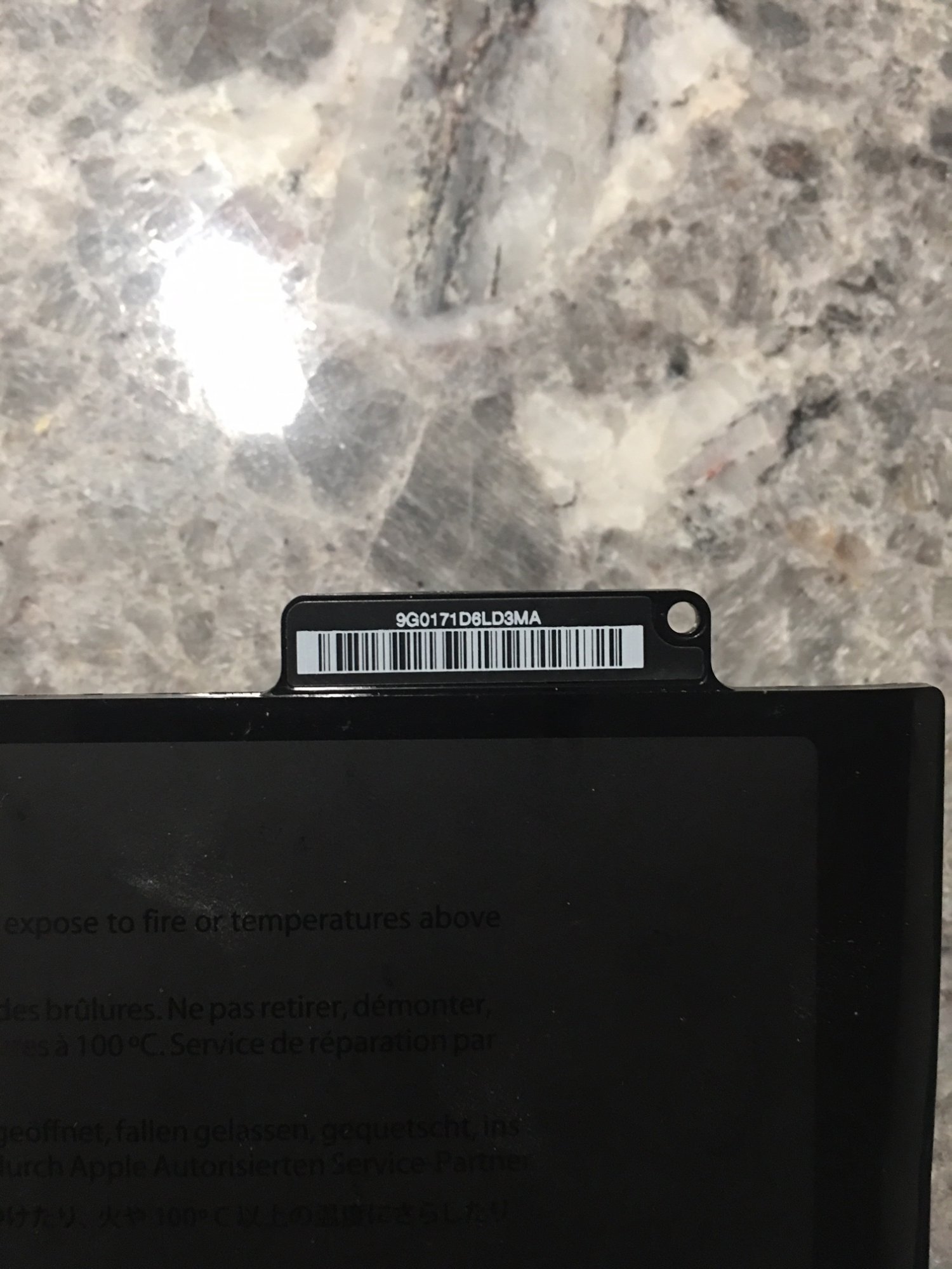

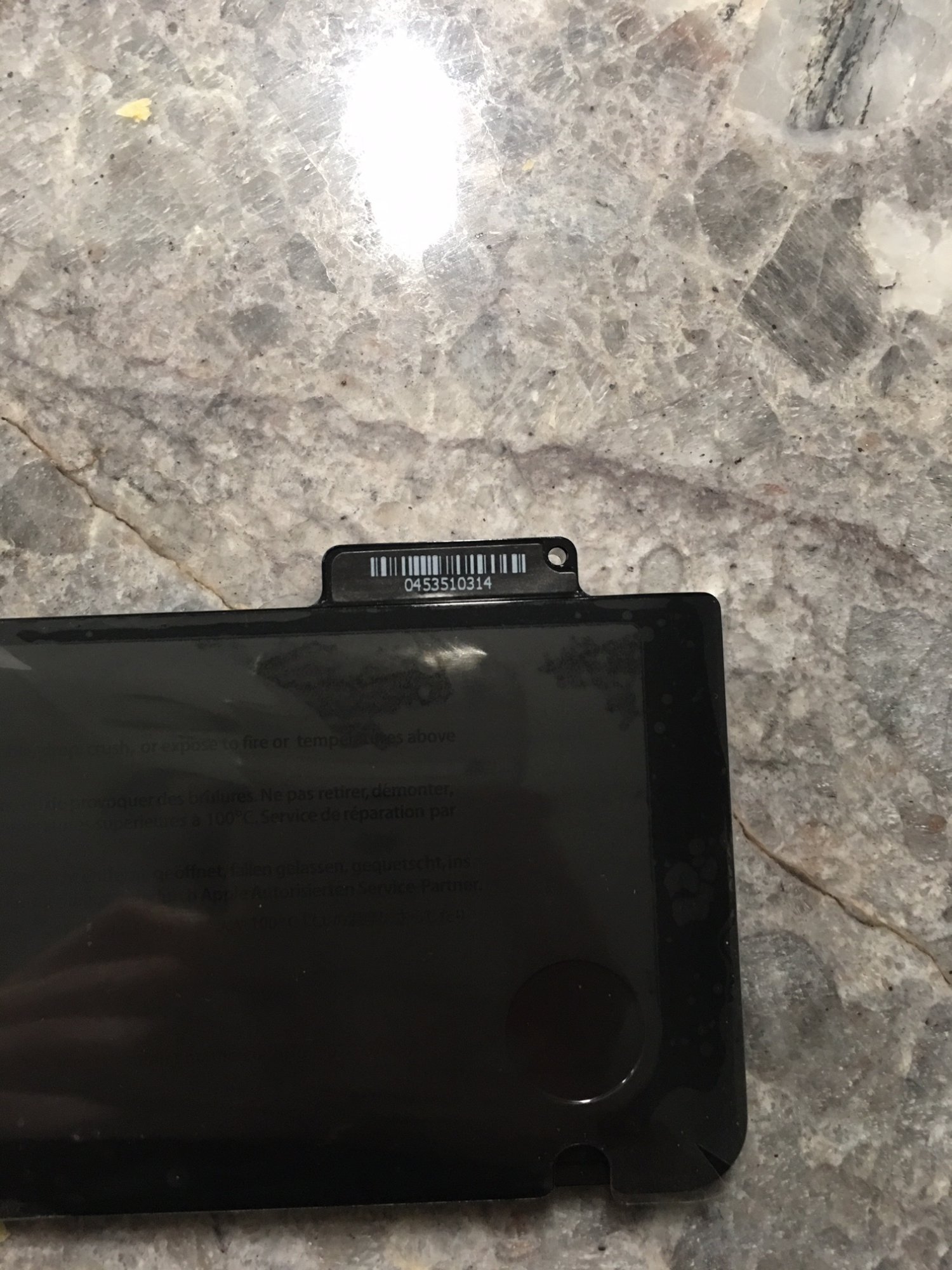

It certainly LOOKS the part, and is a 1:1 match to apple, BUT there is a dead give away: The serial number sticker.
The fakes ALWAYS have a stretch font for this little detail and it looks fake.

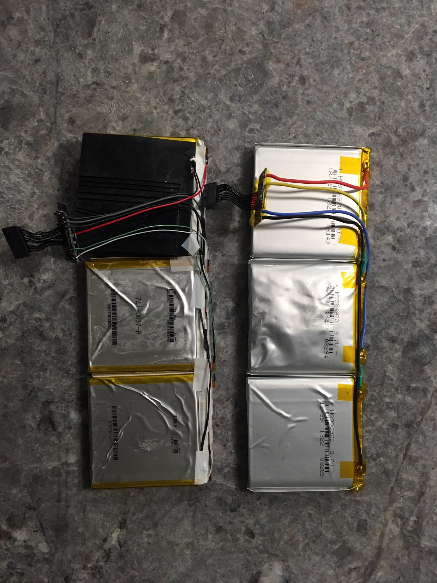

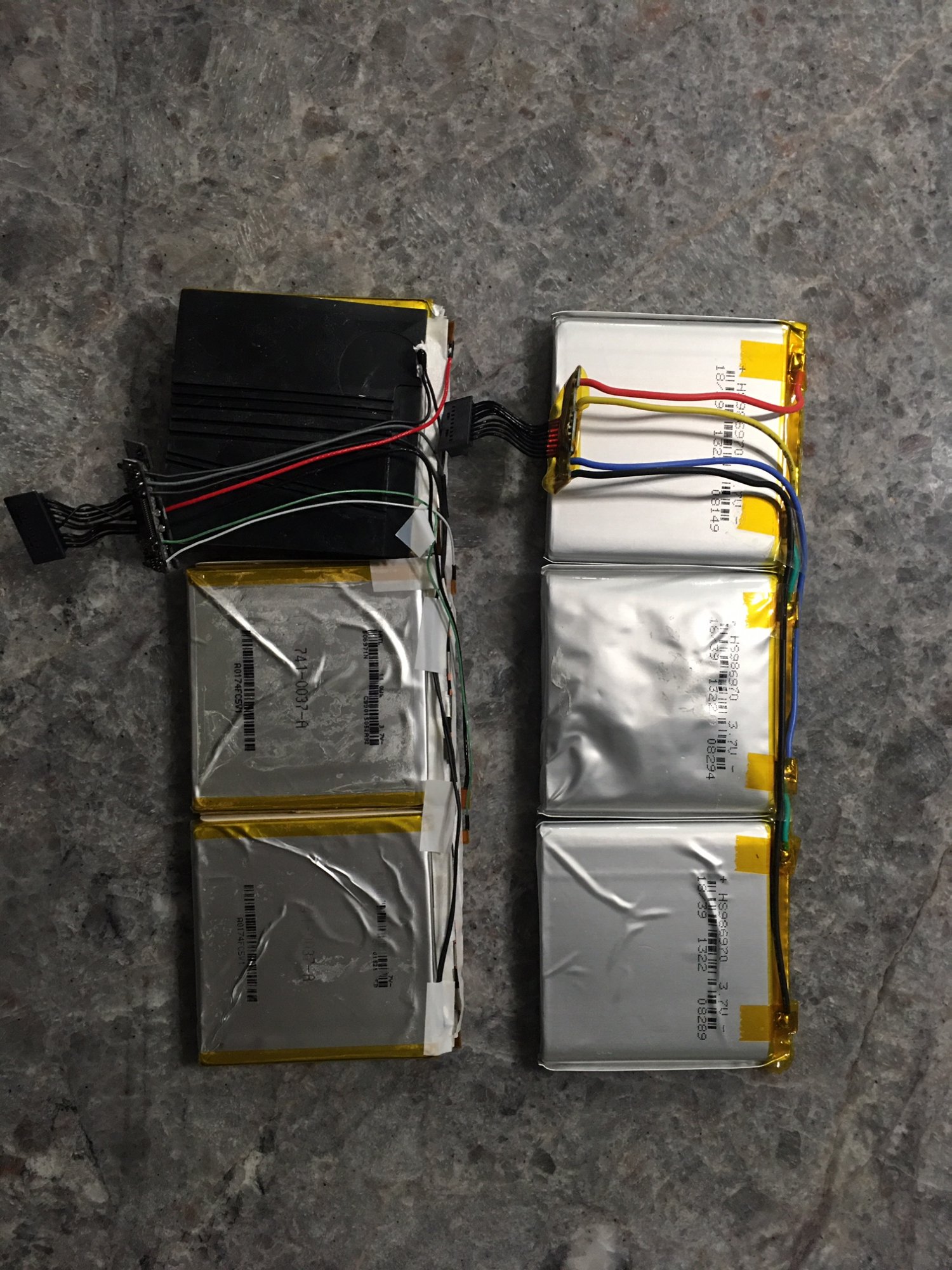

I tore a dead OEM battery apart and my new "Oem" battery which lasted a little over a year and swelled. The guts tell the full story. The fake? rainbow colored wires! capton tape on the controller board which is green, not black.
Well, check out the pics. Pretty self explanatory. The FAKE DOESN'T HAVE A BMS!!!!
The barcode with the white dropbox is OEM. The other is fake.
If your barcode sticker doesn't have a white dropbox and a nice crisp font, its NOT OEM. Used or OWC is the only way to go.
I threw my money in the trash but thankfully caught the swelling before it ruined the MINT NEW palmrest, and bottom lid on my beloved mbp 13.
I should of bought the OWC in the firstplace. At least it doesn't swell.
Oh, my new "OEM" battery lasted....9 charge cycles before swelling....
I sincerely regret selling my 10 year old USED battery that at the very least held over an hour of charge and didn't swell...10 years later

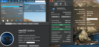

So I tested out the NewerTech battery and am getting about 4 hrs of use with Firefox open with multiple tabs/windows. Do you know if this sounds about right or is it too low? Would an original Apple battery give me more battery life? I don't know why I'm just extra skeptical about 4 hrs...
I do have that feature, but sometimes I prefer the tactile response of clicking.
It's really hard to tell what a new aftermarket battery should yield vs. a third party battery. My gut tells me it's the same. It really depends on what OS you are running and what is running in the background. Apple has built in so many icloud sync processes since you bought you MBA, in addition, even Firefox is more demanding now vs. the early simple clean code. But to answer your question, I would be happy with 4 hours for what I do. I can't imagine getting more than 5 hours.
