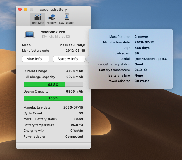

My 2-power battery which I bought in 2019 seems to be doing reasonably well.

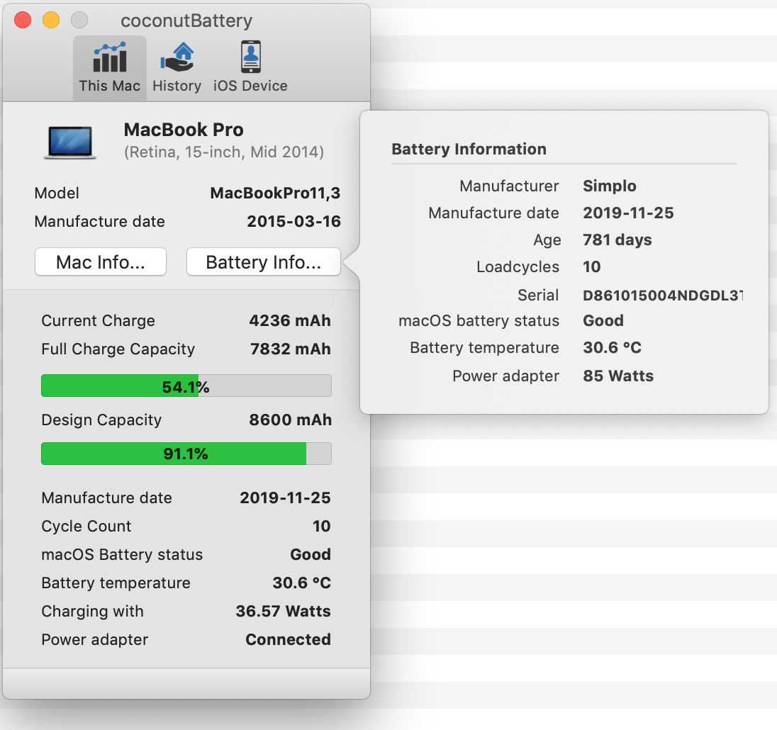

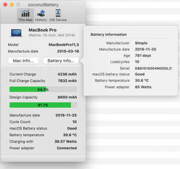

hmm, read back to your post and screenshot from a month ago or so. I'm seeing a lower full charge capacity than when I put it in 5 days ago (8630, I think).
Best test is to use it on battery continuously and see how long it lasts. Also inspect the discharge rate.

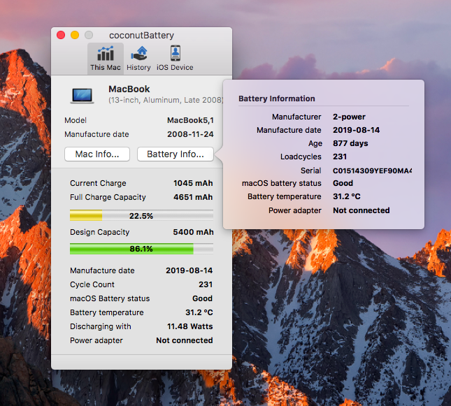

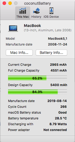

My 2-power battery is losing around 4 mAh every charge cycle(not sure if it is by design) but I guess all things considered you can call it a graceful aging.

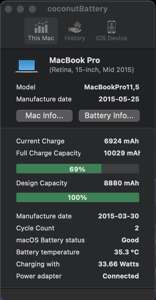

I recently had to replace the battery on my 15" MBP Mid-2015 so ordered A NewerTech battery from MacFixit Australia. I previously had one from iFixit which I installed myself a few years back. I was a bit impatient the first time round and promptly mangled the protective back plate of the touchpad. Nothing serious at the time.
This time round, however, the touchpad protective back plate managed to stay stuck to the iFixit battery and it totally came off as I disassembled the battery. I decided to leave it off as there was another plate so I just assembled the NewerTech battery on it and put it all back together. Touchpad still works nicely so I'm not worried.
After calibrating the battery and firing up the Coconut Battery app, it tells me that the battery was manufactured on 30th March 2015, and my MBP was manufactured on 25th May 2015!!! :oops::oops::oops:
Battery seems OK though, but without the touchpad protective back plate, it might be the last battery replacement and once the battery gets tired, it'll be off to silicon heaven 😭
