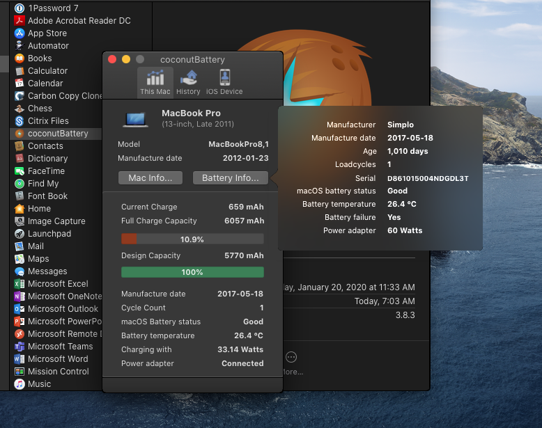

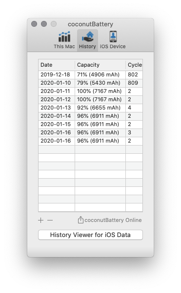

I just installed the eBay battery from seller omg_1971. I've noticed some strange anomolies that confirm that it is likely not genuine, despite the fact that it seems to be a good quality fake (at least as aesthetically, can't speak to function quite yet).
First, if you go back and look at the coconut battery screenshots for the eBay batteries in this entire thread, they all have the exact same serial number D861015004NDGDL3T. In my case, the sticker on my battery does not match this number either (see pics). The NuPower and other batteries seem to have unique numbers, so this is suspicious to say the least.
Second, I had the strange situation where my loadcycle count randomly reset itself from 4 to 2. I'm still waiting to see what happens next with that.
Lastly, I've had a couple of sudden shutdowns at around 66/67% (the percentage it arrived at when new, coincidence?). After that, if I turn the computer back on again, it seems to continue functioning and discharging at a normal rate (and not shutting down again until empty).
I've communicated with the seller about all these things. I'm still in the battery conditioning and calibration stage (trying to full charge and run it down for a full 5 cycles per the sellers instructions after contacting through eBay). I've done one SMC reset. Will try NVRAM also. I also opened it back up tonight to make sure everything was seated correctly. Will continue monitoring and report back whether or not I end up returning this for refund or exchange.

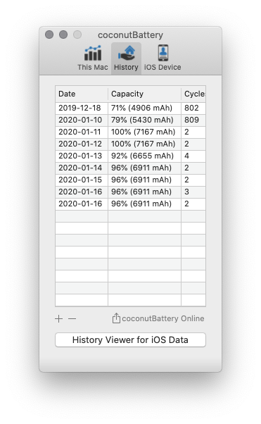

Yeah, pretty sure I'm sending this battery back. I've continued to have a few random shutdowns. The charge cycle counter has reset itself a few times now. I think I'm done messing around with it. I'll either try my luck with another eBay battery with ok reviews or else go for NuPower or iFixit. Frustrating.

I just shipped my eBay battery back to the seller. I reset the SMC and PRAM several times but nothing really would stick. It just behaved erratically in too many different ways, which made me uncomfortable it could damage something. I reinstalled my old original Apple battery with ~75% health and 800+ cycles and all the problems disappeared. Aside from the shortened time on battery power, it still works fine.
I did manage to find a seller with some old stock Apple batteries that I might try (pricey though). Otherwise I'll try my luck with other cheap batteries like Egoway or Temark, or else more expensive alternatives like iFixit or NuPower.

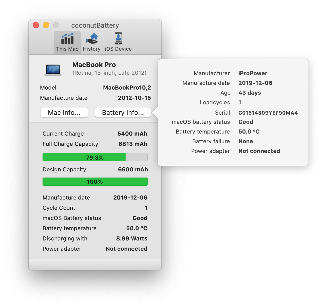

I have a MacBook Retina 13" (Late 2012) running Catalina. Battery was having issues. Apple Store said its $199+tax for a new battery. The trade-in value for my MacBook is barely $250. So I got an "iProPower" from Amazon for $75. Just installed it today. *fingers crossed*
You probably should be more concerned with the temperature of your immediate environment. No battery will last at the 50 degrees C.
So forgive me for not understanding this, but the top 2 readings are your old battery? You binned it after 800 cycles or am I not understanding what Coconut is saying here?
That's correct, the 800+ cycles is my old battery, then starts the eBay battery counter.
Just to update this thread, I ended up trying another OEM Apple battery on eBay that was advertised as "pulled from a new machine." But it had 400+ cycles and all broken tabs. I returned that and bit the bullet to buy this new Apple OEM battery (I had ~$40 in eBay bucks to bring the price down). It is legit and the real deal. It came in a sealed Apple box with instructions and sticker. The capacity so far is amazing and I'm seeing none of the strange issues as with the eBay fakes. The age of the battery is 1400+ days and it was fully discharged upon arrival (which sounds about right for new old stock). I've put it through about 4 full charge/recharge cycles to condition it and it seems to be doing really well, showing 7400mAH at the highest reading.
