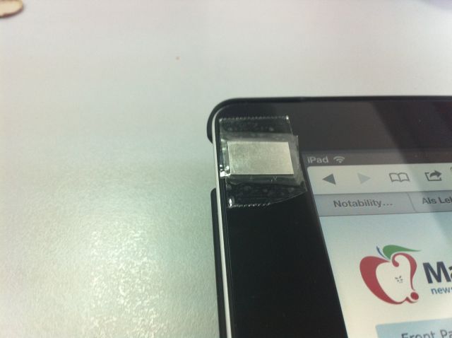

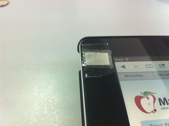

Point is that the cover does not hold tight in place. So when I walk with it, or simply handle it, I can hear the iPad switching ON and OFF frequently. I don't get that with the original iPad Smart cover. I guess when the iPad is in my rucksack the same happens.

I guess when I hold it were it opens it should be OK. Holding it at the hinge will trigger the problem.
For the meantime I will work on my iron-sheet-solution and will improve it with black tape to have it less visible.
If I could get hold of an e-magnet I would try to re-pole the side magnets.

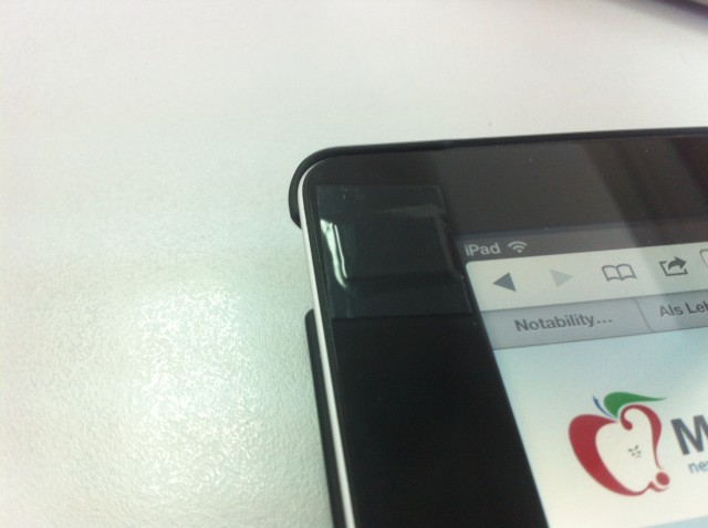

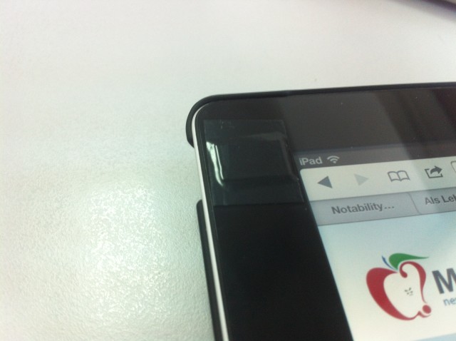

For optical reasons I changed the transparent scotch tape now to shiny black electrical insulation tape. The hold is now about the same as the Apple Smart Cover. The tape is not in the visual LCD area and bothers me less then the constant ON/OFF switching.
For potential imitators: I used tinning sheets. Make sure the material is really magnetic! Thickness is 0.20mm. Since the material is not 100% rust proof, and as a scratch protection I put some ultra thin wrapping film under it, and then the insulation tape on top. Gladly I have a metal sheet shear next door. Otherwise it's difficult to keep the material flat while cutting.
Great little tip, thanks for letting the rest of us know. I guess it's something to consider if that really bugs my wife. So far she's loving the case, and I can see why. I'm waiting for my black Y++ myself heh. It really seems to be the best compromise amongst all the options I've seen....certainly more stable and useful than the folio cases and also includes all the smart cover options.

Unfortunately same here. With the 'metal plate fix' I did it works EXACTLY as wanted.
However, one small point... first I thought my try with the extreme low quality transparent scotch (It wasn't 3M/Scotch, was some cheap stuff) tape would leave a mess on the LCD. But no! The glass seem to be very anti-dirt and the tape does not stick to it very well. So after I changed to the black tape it's the same. It sticks, sort of, but it can move around a little. Maybe I need to make it round the edges...
BTW, the iPad has 2 magnetic N in the left corner (between corner and home switch) - were the cover has N too (N & N doesn't attract). The opposite iPad corner has nearly no magnetic force.
