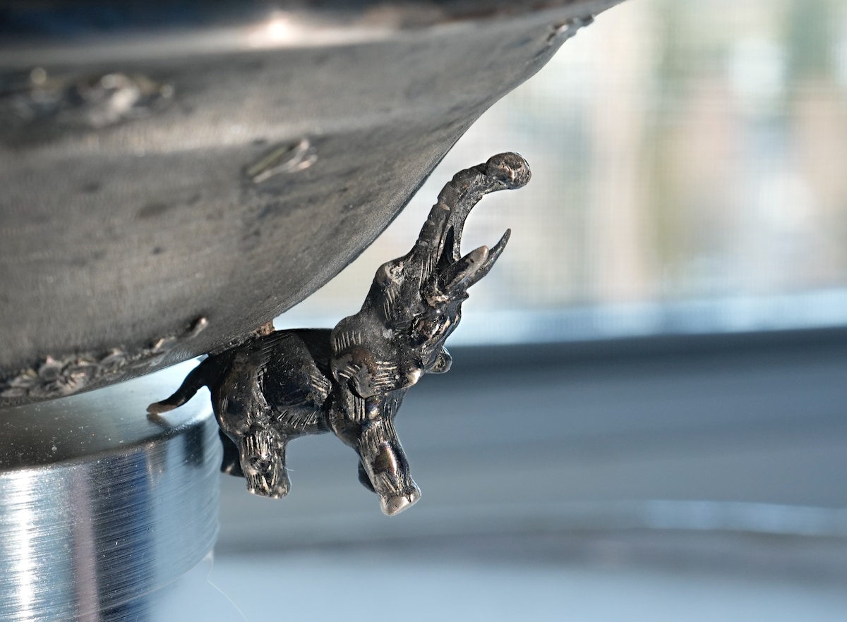

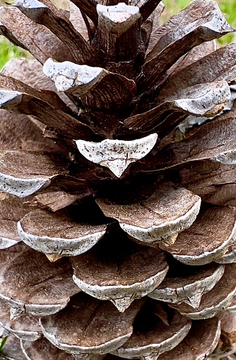

Are you getting close enough in to the subject that the phone switches over to macro mode? This doesn't seem very macro-ish?
I like the elephant. The photo creates mystery, because one has to imagine the size of the elephant and what it is standing on.
My only point about the elephant photo is that as a macro challenge, one should get as close to the subject as possible.
I like the juxtaposition and double meaning here. 🙂

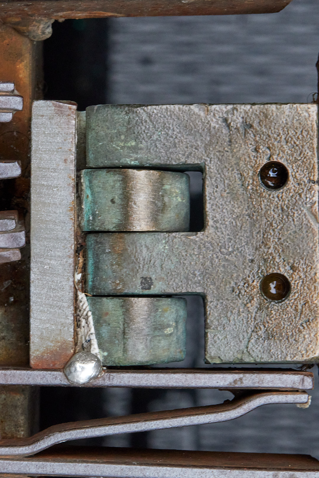

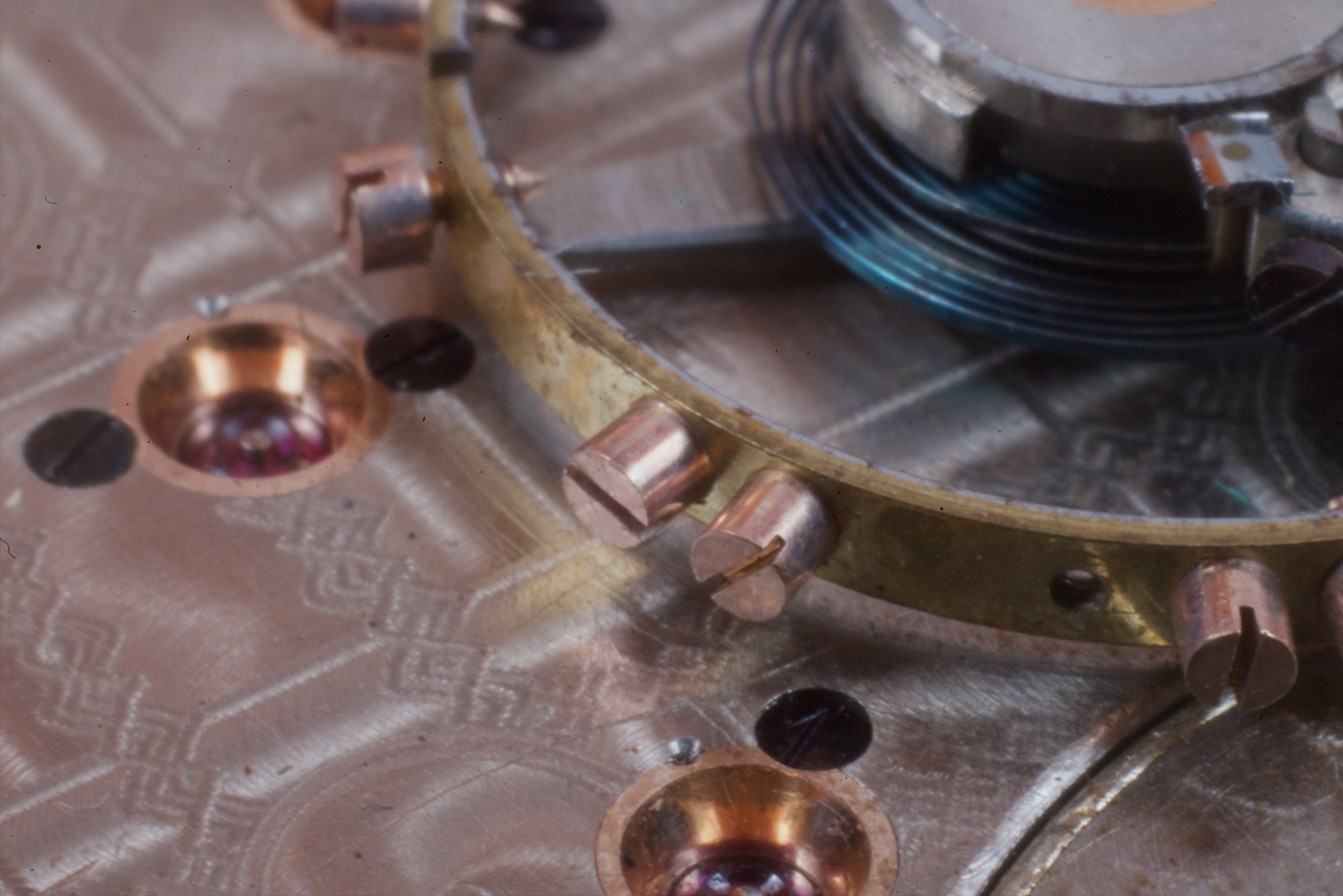

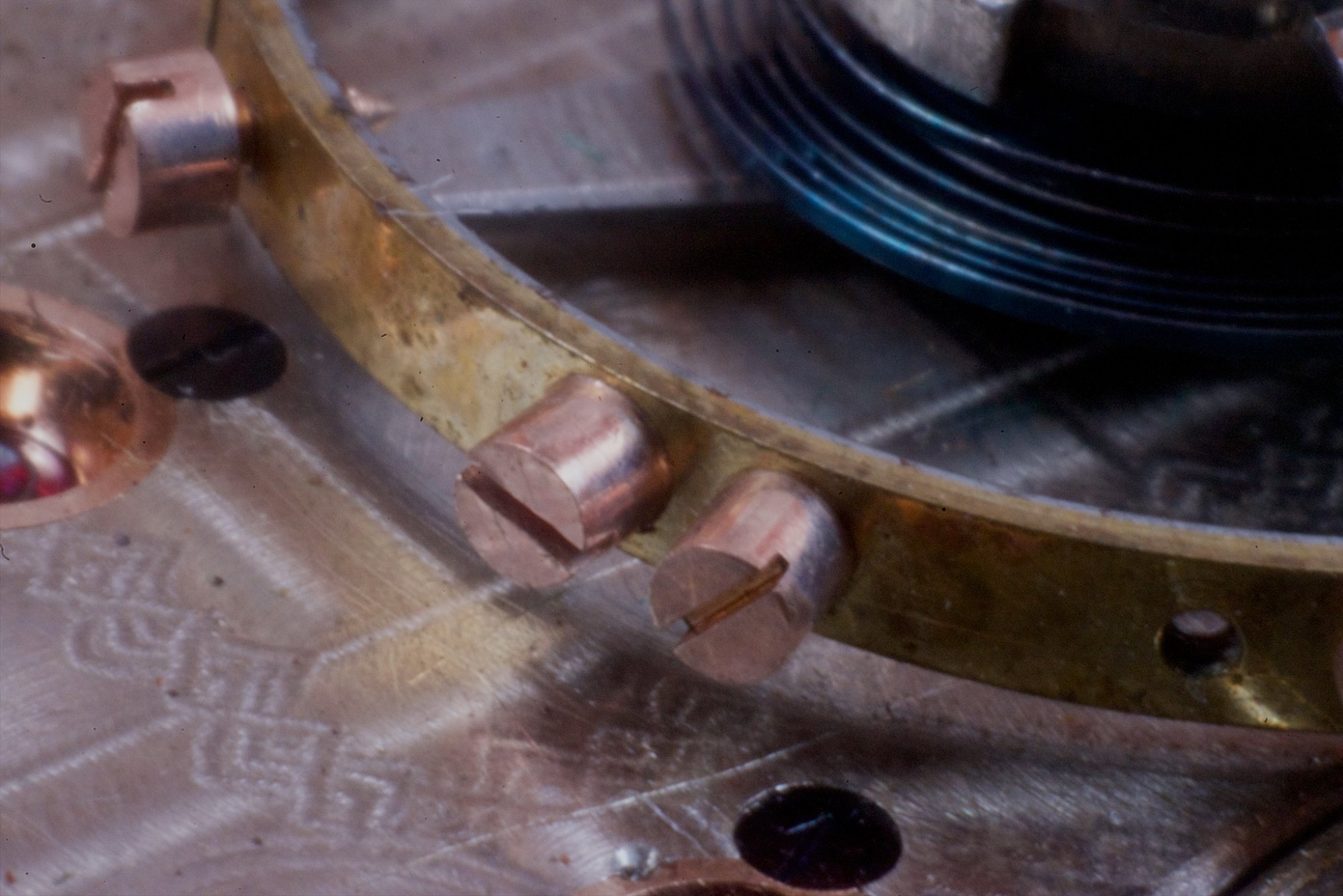

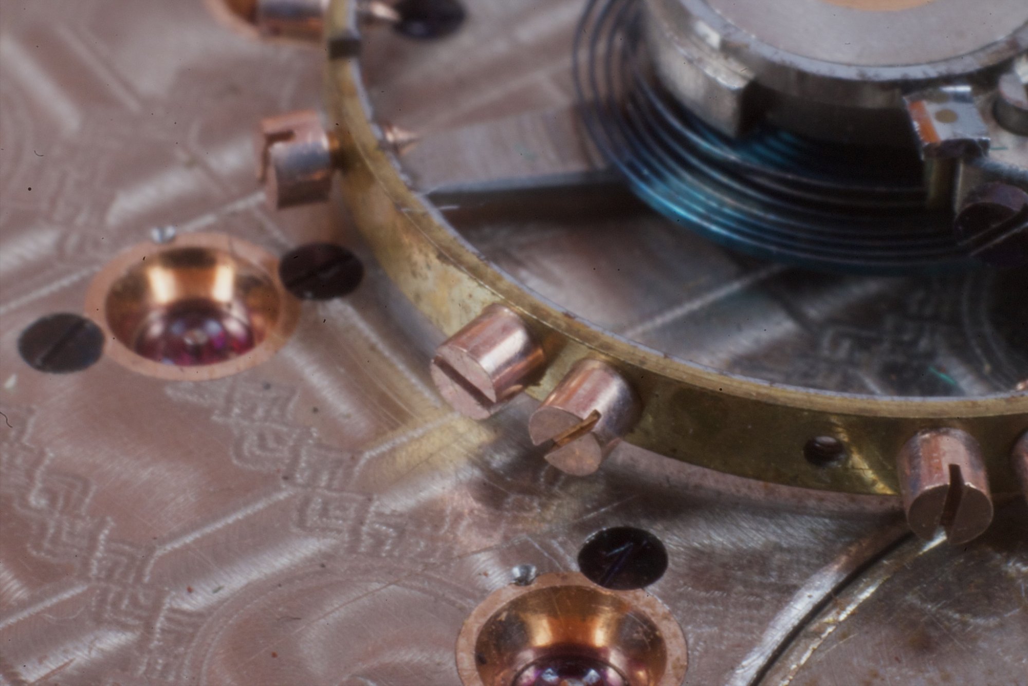

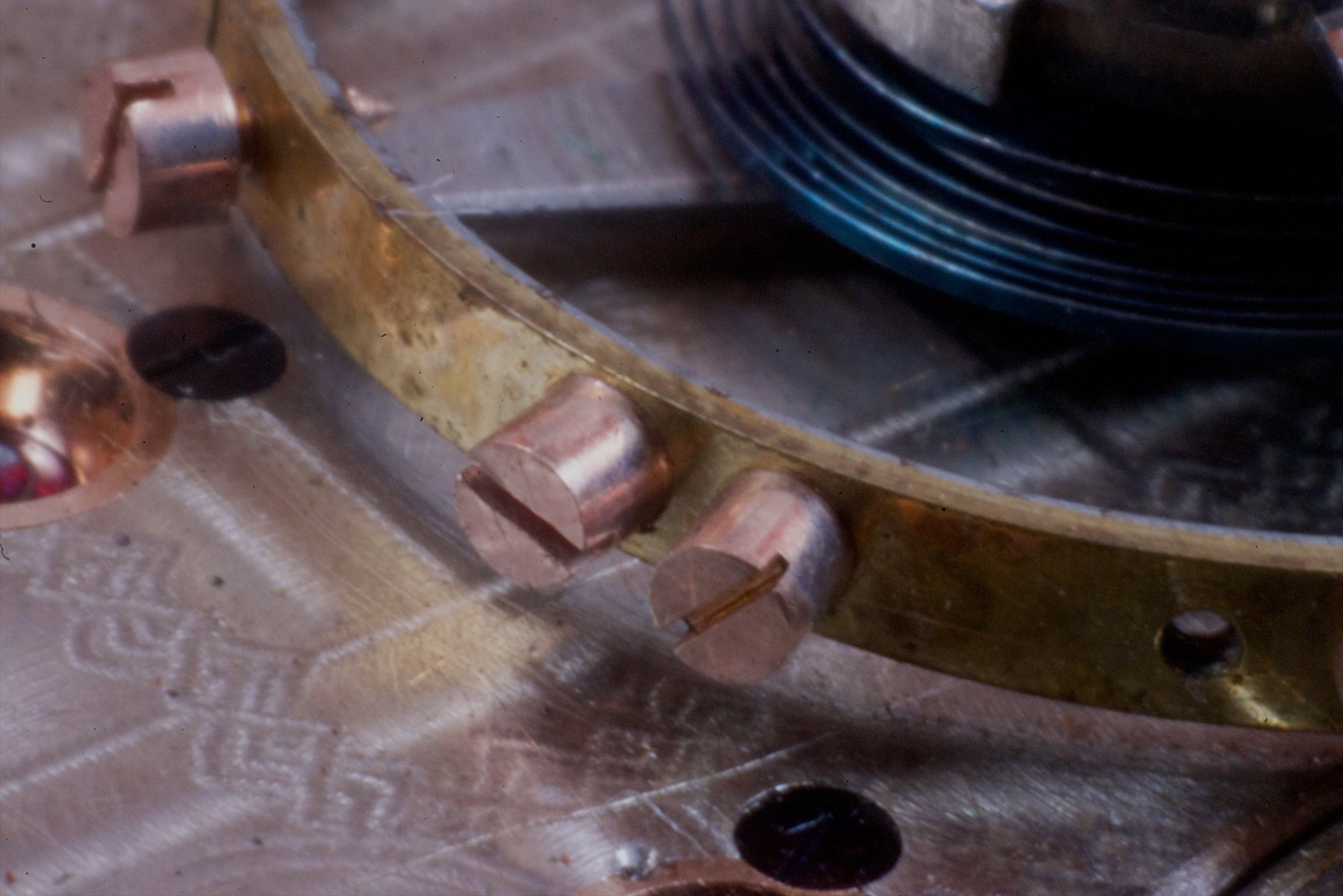

Here are two that I think have room for improvement, but mostly were me pushing the limits of what I have on hand.

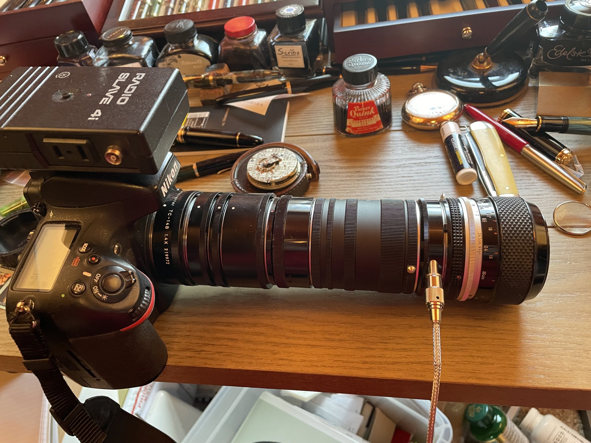

These were all taken on my D800 with an ancient 55mm AI-converted Micro-Nikkor-P f/3.5 lens, my personal favorite macro lens. I have a bunch of Nikon F era(probably 60s and 70s) macro accessories. The one thing in storage that I'd love to pull out are my PB4 bellows, which in addition to having a lot of extension do incorporate stop down by a cable release for easy full aperture viewing.

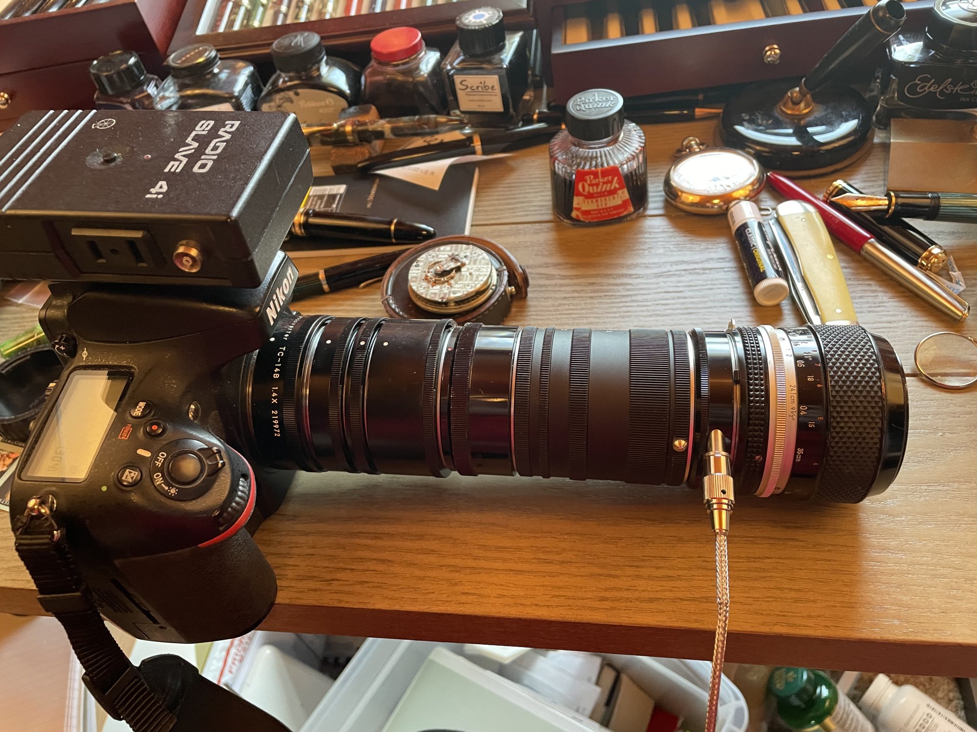

Here's my full stack to get to this one-
PB-11, 12, and 13 rings stacked, which are 8mm, 14mm, and 27.5mm respectively(49.5 total extension). The Nikon tubes are nice in that they keep full aperture viewing. On top of those is a generic set of tubes that measure 60mm to me. Then I have an M2 tube, which was shipped with the 55mm Micro lenses and is 27.5mm to allow them to go to 1:1(the built in helical is 27.5mm). The generic tubes lose stop-down coupling, so to that stack I added an E2 ring, which allows stop down by a cable release(or rather push/lock the release for open aperture focus, release for stop down). It's also a 14mm tube.
This is a total of 151mm of extension. Adding the helicoil racked all the way out gets to 178mm, which I think should put me in the 2.5x lifesize range, but I really need to measure focal plane to subject to calculate exactly(if you really want to get exact about this, and forgive me if this has been mentioned, but your camera should have the Φ engraved on the top plate to get exact plane, and magnification is measured from here to the point on the subject in focus).
Lighting is by a couple of strobes. I need to get a stronger power pack out, as I had to raise the ISO to 1600 to get the exposure in the ballpark. The lens nominally was set to f/32, but I think that's an effective aperture of f/160? Forgive me for being fuzzy on the math.
Then, just to get fun, I stuck a 1.4x teleconverter on the back. As some back of the envelope math, if you place extension tubes in front of a teleconverter, you can treat it like the TC multiplies the effective length of the extension tubes by its magnification power, so this would give me ~250mm of extension, or nearly 4x lifesize.
Miraculously, I did this all handheld. It really should be done on a tripod with a macro focusing rail, and I'll try that later.
This also has the lens nearly covering the subject. Reversing should help with that, and it's something I'll play with later. I do have a BR2 reversing ring, which works with 52mm filter thread macro lenses.
And here's the full unwieldy set-up
I still am continually baffled as to how you know so much about all this stuff. You are highly technical. I'd be afraid to piece that many parts together for fear of shearing off at one of the junctures!

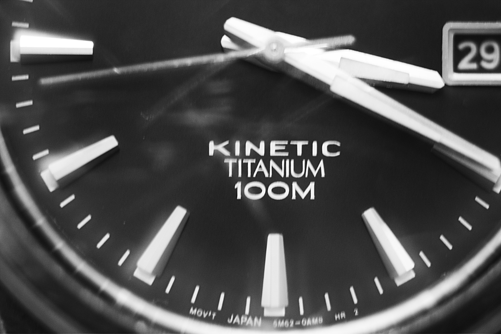

Is your subject part of a watch?

The close up of the watch reminded me to correct the date. It count only count to 31 for every month.
I honed in on the technical stuff because it interests me and I can(mostly) understand it. I just wish that I had even 1/10 of the artistic skills as you and several others around here!
This kind of macro(or really some people will say that once you get past lifesize you're into micro range) really lets me get into the nuts and bolts of how this stuff works. Even using a relatively modern camera, it also makes you get very hands-on and manual with making all the pieces work together.
Yes, it's the balance wheel out of an 1883 model Waltham.

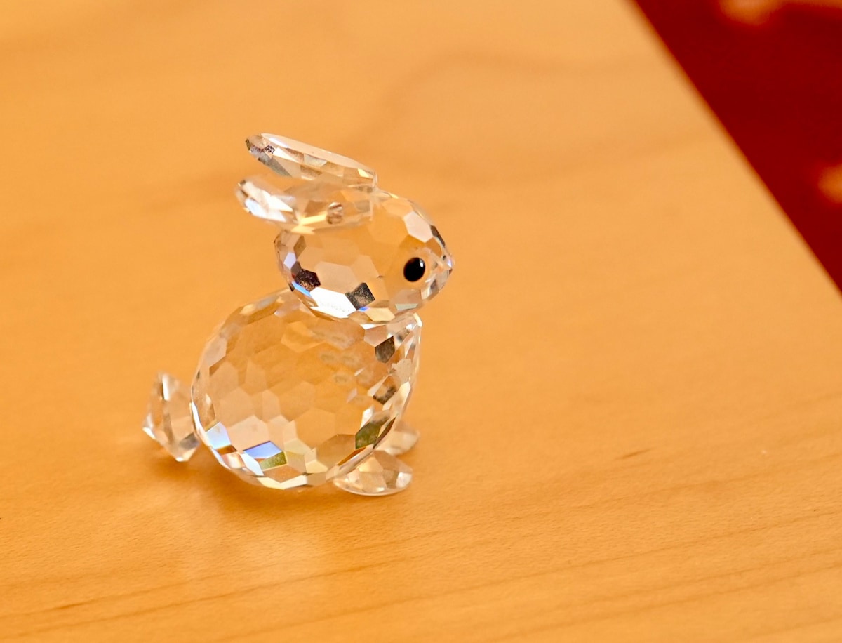

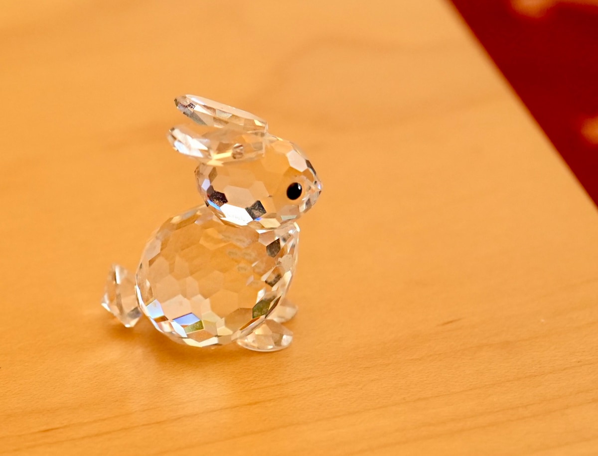

View attachment 2166698View attachment 2166697View attachment 2166696

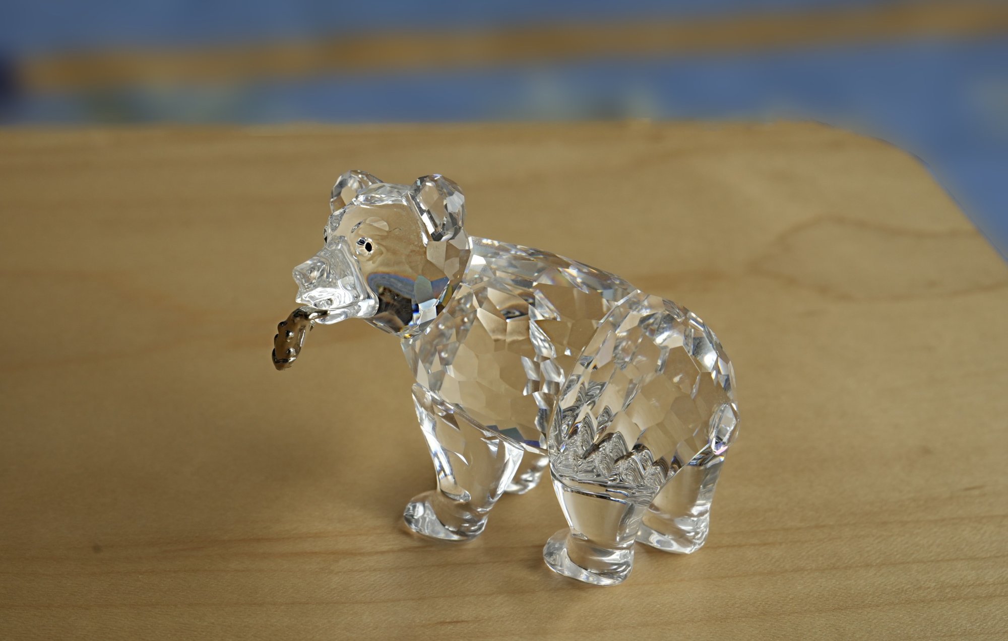

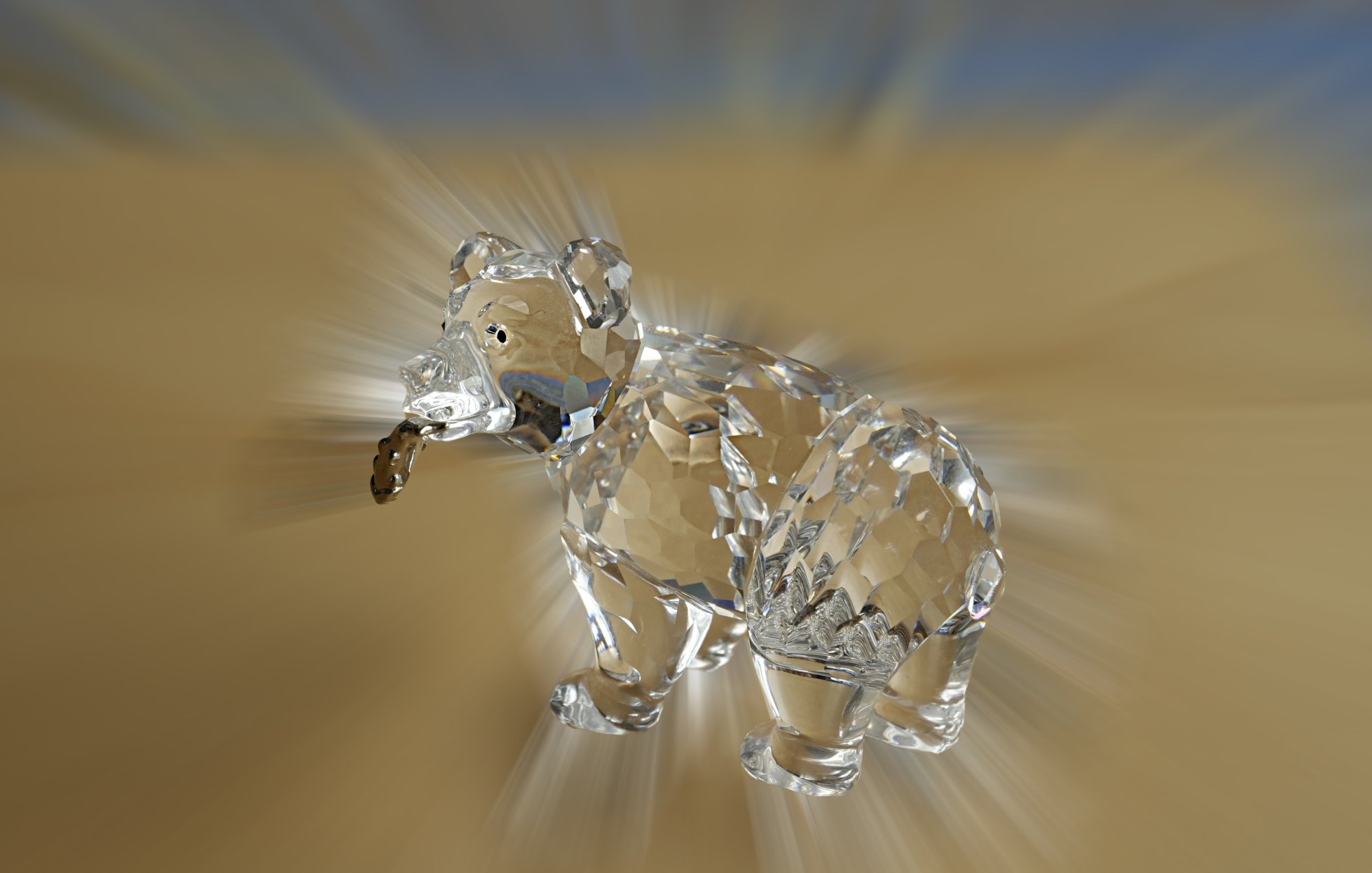

Mini Rabbit and mini bear in two versions with effect and without
CC welcome
Fun! I prefer the bear without the streaky things, but I like that you are experimenting with different processing.

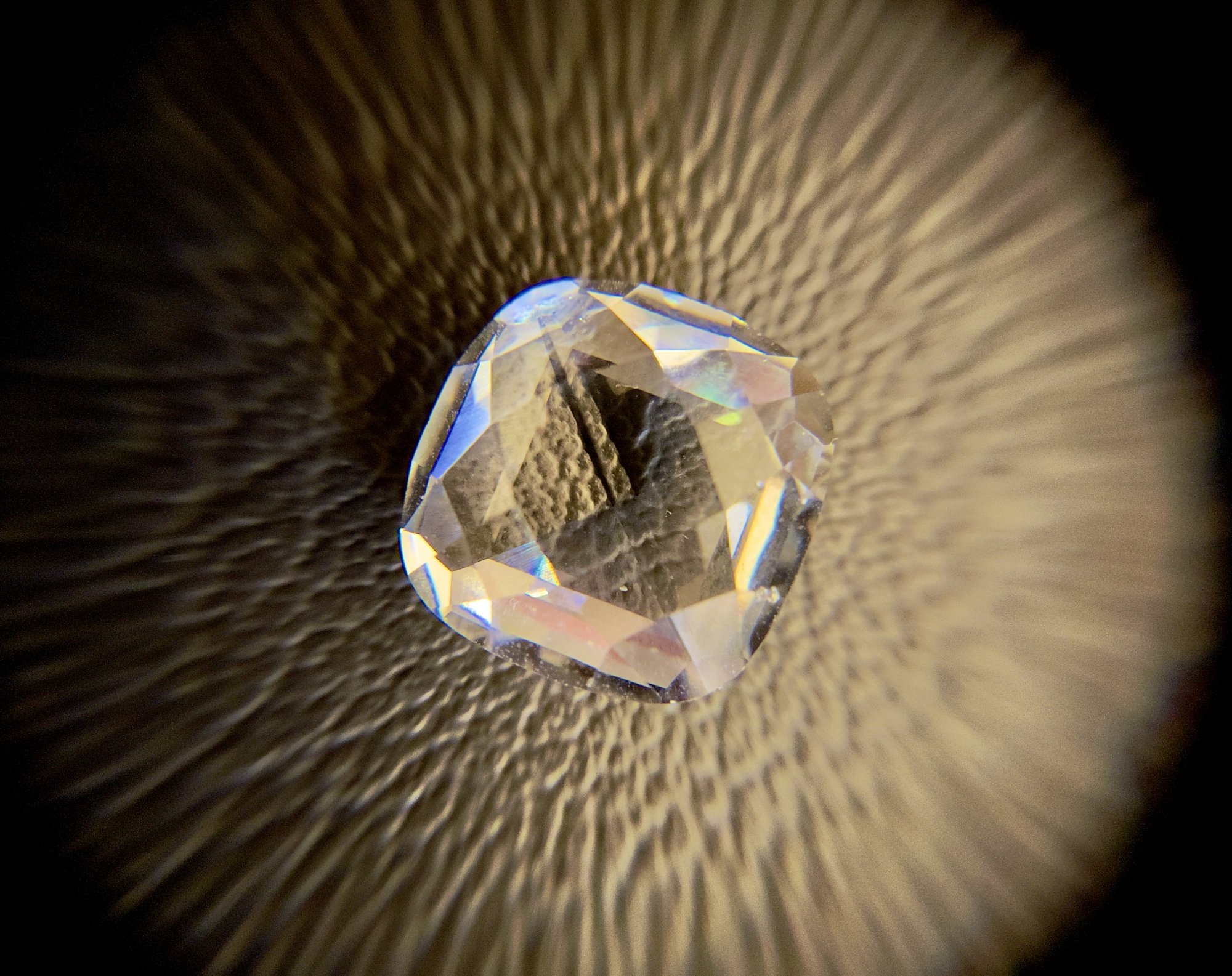

Oh, interesting technique. Inspired me to experiment a bit:
I'm already keeping an eye out for a suitable adapter for my camera… ;)

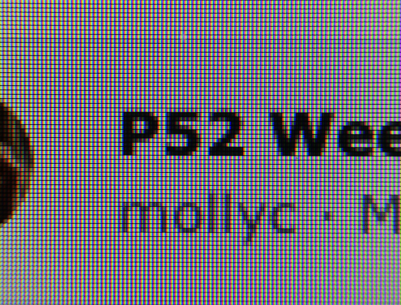

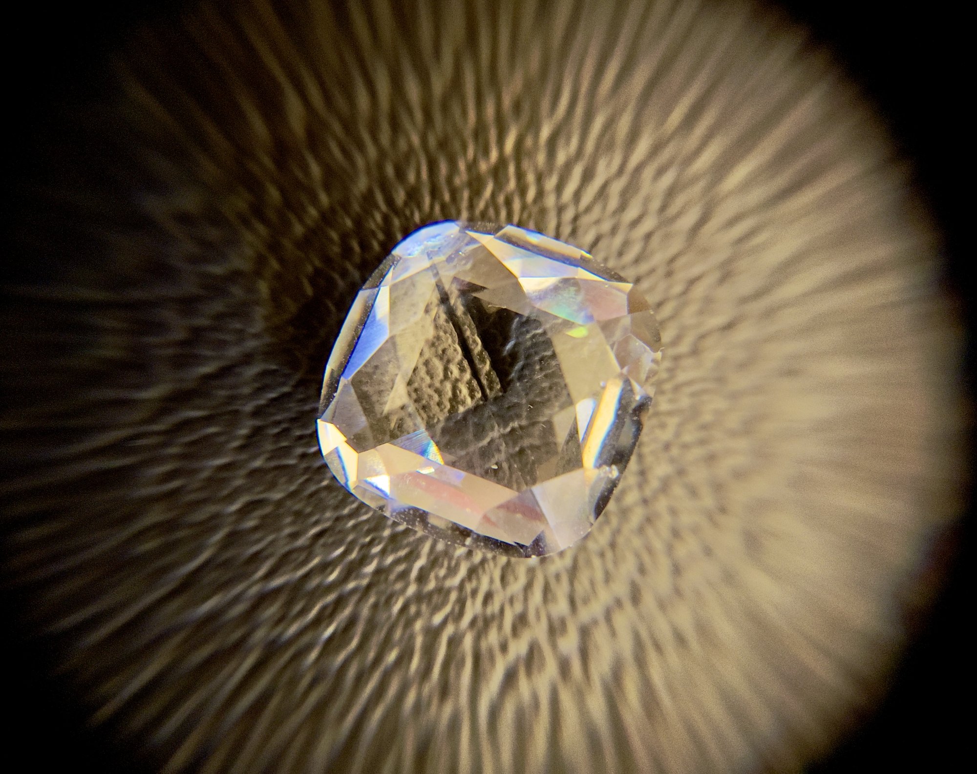

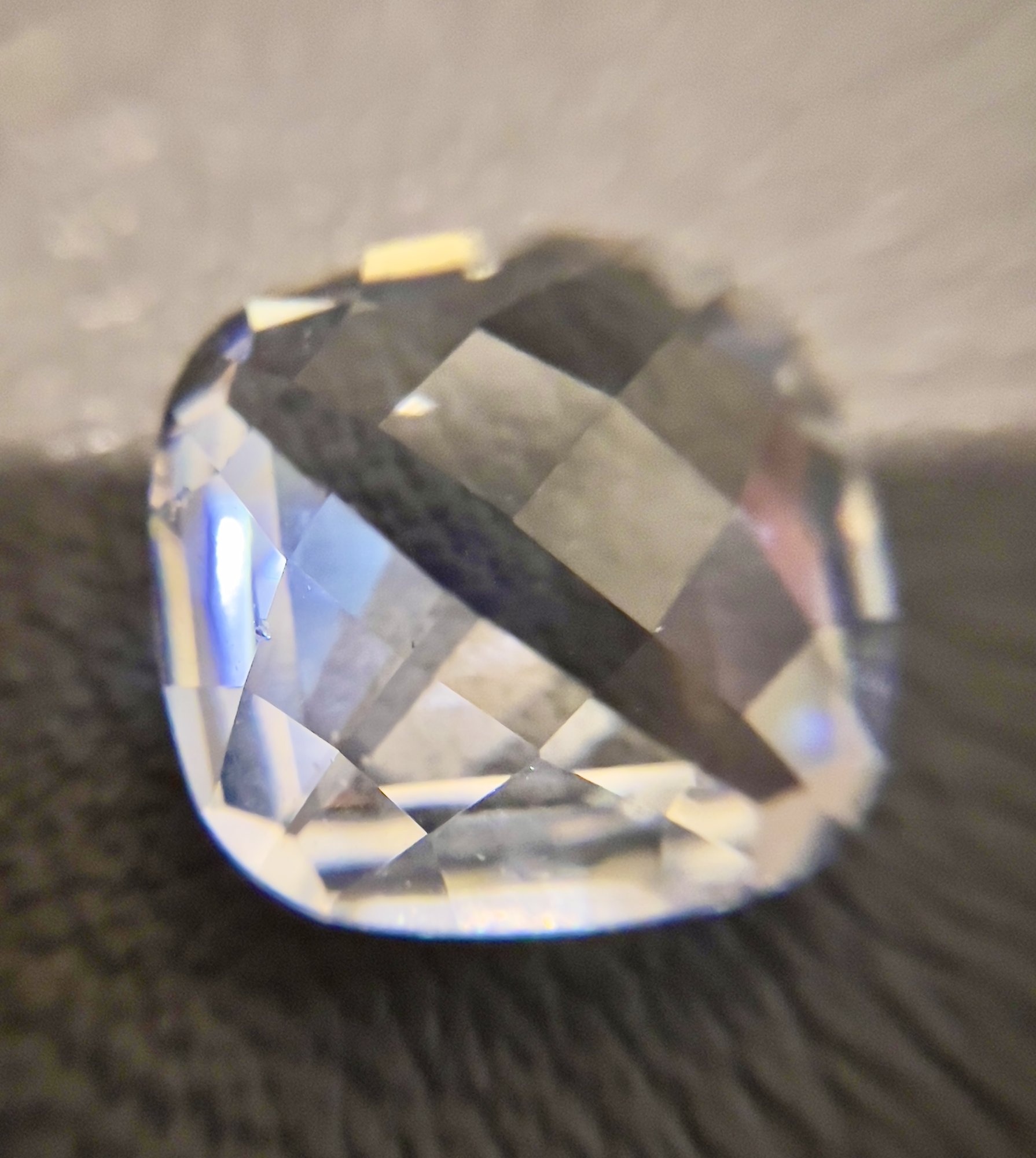

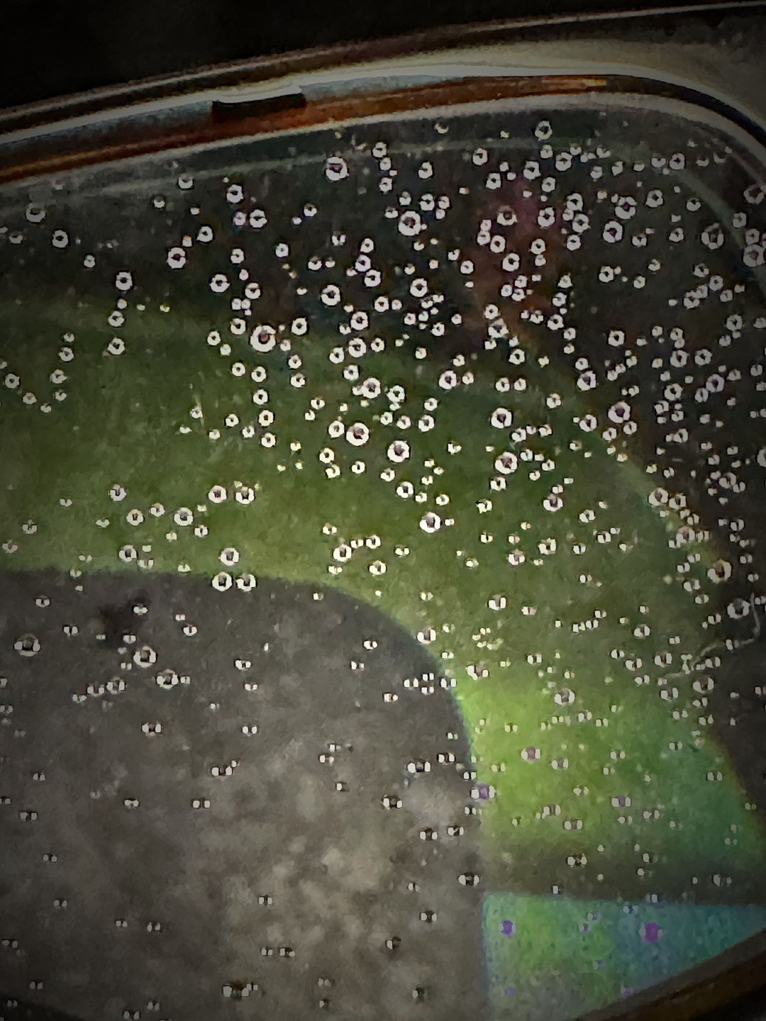

Wow, these are really clever! Did you take the second photo through the glass shown in the first?

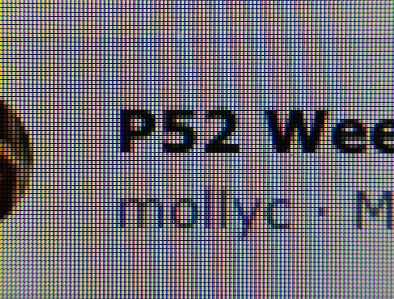

18X loupe on the .5X lens of my iPhone 13PM. Interesting.
18X loupe on the 1X lens of my iPhone 13PM.

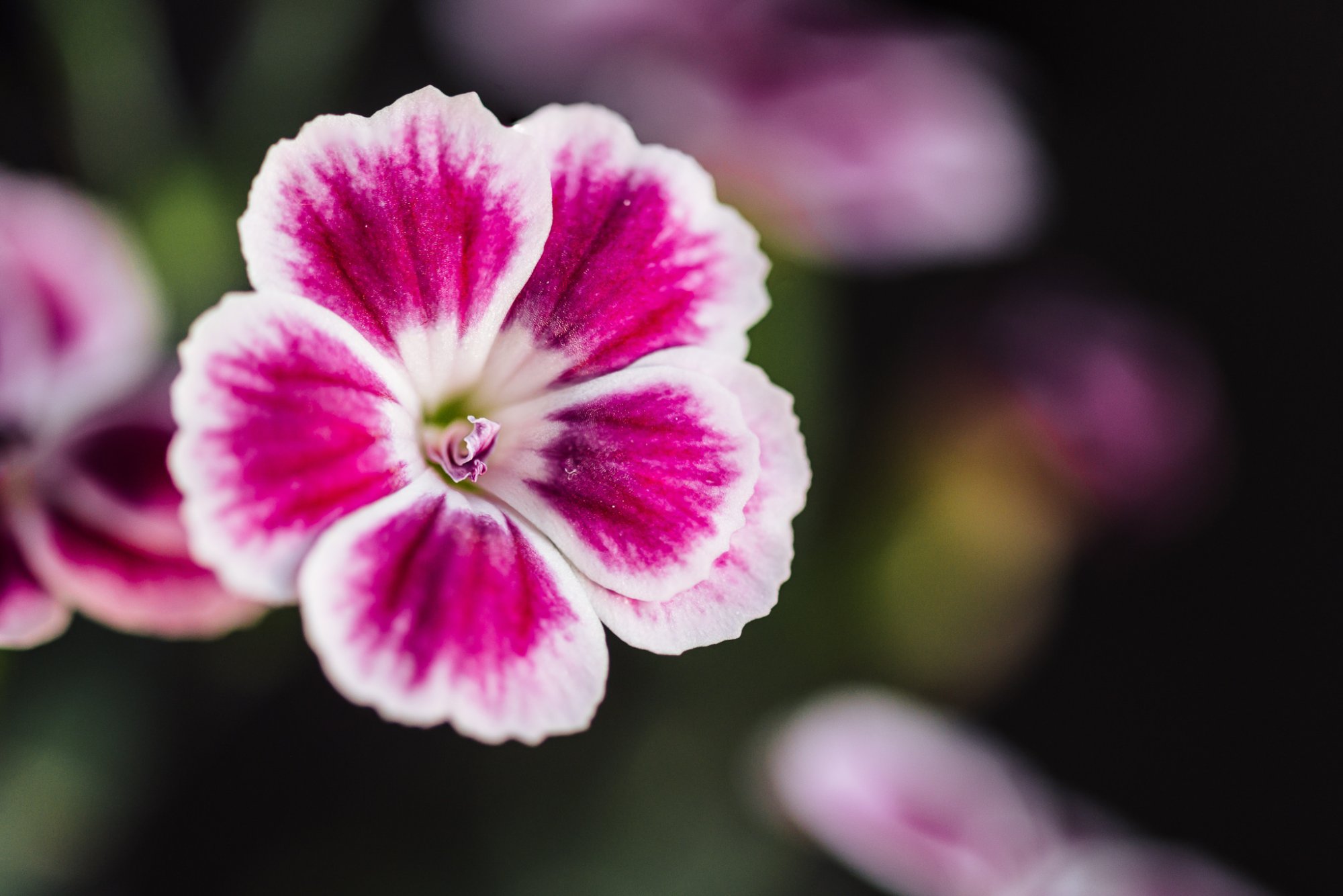

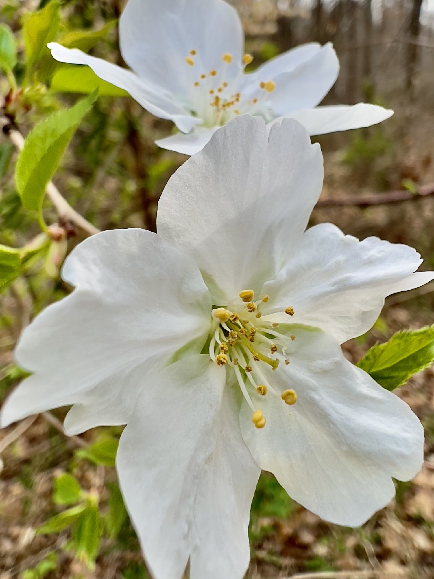

This is a stack of two different images with my 105mm macro.

Stacking your photos does it mean using two photos as they were layers?
yes. I caught focus in one but the composition was slightly off with one petal cut off, so I just blended two together. 🙂
No, it took it with this reverse freelensing technique. I tried a couple of more pictures of other objects this way. But as the focusing was a bit tricky, this was the one that did not come out completely blurry. But I'm intrigued enough to try this again with a proper adapter. These aren't very expensive as I found.
