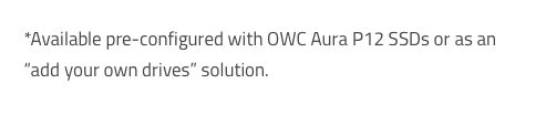

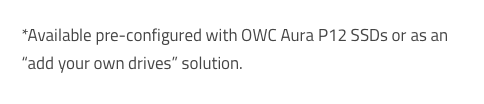

Bear in mind that OWC has no present plans to sell an empty 4M2. So when you buy one, you're going to get 4 x 256G NVMe drive in it, whether you want them or not.
Not sure @tsialex is "recommending" the OWC card, just mentioning it's compatibility. Believe the overall recommendation is still the HighPoint card since it has few (if any) blade restrictions for size and double-sided.

Saw that as well. The rep I spoke with this morning stated they clearly had no intentions of offering an empty one. He could have been mistaken, though you'll note there's no way to select that configuration on the MacSales website.
Anyway, I added it here because people are interested in this card and OWC hides it very cleverly that is a x8 card.
It's overpriced, but people wanting a fan less solution may go for it. HighPoint SSD7101A-1 frequent Amazon promos for $275~300 is a much better choice.
