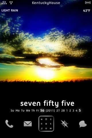

And I'm having a weird issue with the Kruse SB widget that I've never encountered before. I've got it set up in the "corners" version, with the temp in the top right, the conditions in the top left, and the calendar at the bottom. I'm using the correct (English) Wallpaper.html file and I've set the weather correctly using my ZIP code but for some reason, the temperature keeps showing up as 36 degrees Celcius. That's like 95 degrees Fahrenheit!? Trust me, it's about 60 F here in Kentucky...lol.
I'm not sure what the deal is. Here's the actual file that's on my phone...can someone take a look and tell me what I'm doing wrong?

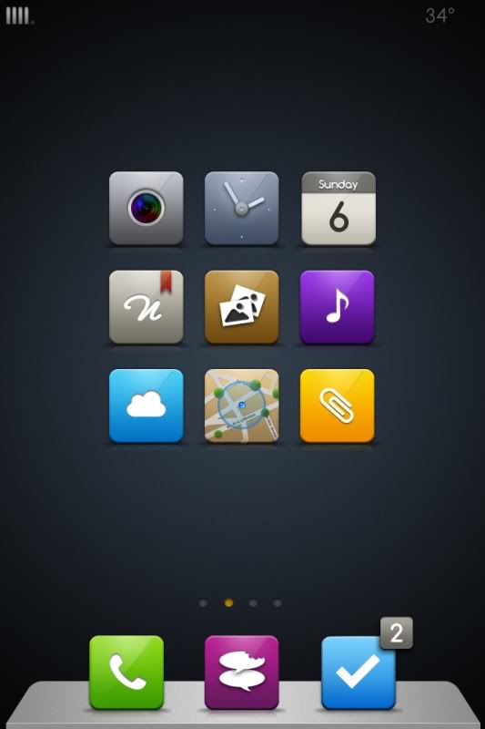

Here is my viP4 look :)
First is lock. Second pic is Home.

Paying tribute to my fav Brit by using O2 carrier logo (not sure if she's on that network or not!)!!!

By the way, that screen shot you posted above looks fantastic! I really like the icons and the subtle widget. Oh, and the O2 carrier logo in honor of LEXS is a GREAT touch! Very nice!

Thanks! That's the prestige theme w/ iflat II weather widget...

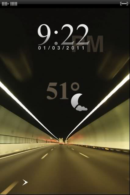

How do I change the format to MM/DD/Year? As well as moving the weather to the center? TIA
Also how would I change the font to match mine?
In your LockBackground.html, look for function calendarDate. Make sure that this line looks like this..
Code:
document.getElementById("calendar").firstChild.nodeValue = this_month_name_array[this_month] + "/" + this_date_name_array[this_date] + "/" + this_year//concat long date string
and not like this…
Code:
document.getElementById("calendar").firstChild.nodeValue = this_date_name_array[this_date] + "/" + this_month_name_array[this_month] + "/" + this_year//concat long date string
To center the weather, go to Private/Stylesheets/mini.css and change the position on temp and weatherIcon. I don't have the city showing in the screenshot, so if you do have your city showing, you'll have to change that too. Here's how I have my positioning set…
Code:
#temp{
	position: absolute; top:188px; right: 0px; down: 0px; left: 113px; width: 256px; height: 481px;
	font-family: Neutraface;
	font-weight: bold;
	color:#tan;
	text-shadow:#a1a1a1 0px 1px 1.5px;
	font-size: 60px;
	text-transform: uppercase;
	opacity: 0.4;
#weatherIcon{
	margin-top:0px;
	position: absolute; top: 220px; right: 0px; down: 0px; left: 159px; width: 320px; height: 461px;
	height:60;
	width:60;
Any further questions, please ask them in this thread…https://forums.macrumors.com/threads/1062491/
