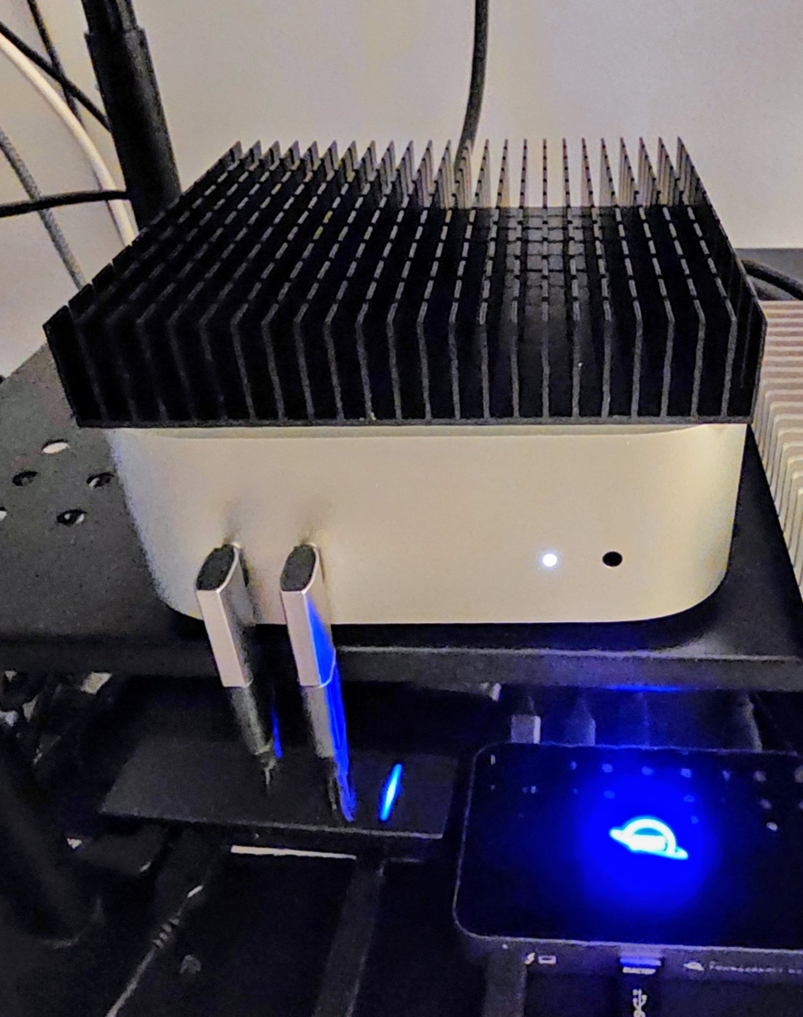

Do you have the part number of that heat sink? It looks perfect! Have you measured the temperature differences under sustained use?
I got it from amazon.ca. You should be able to find it on the.com site.
I just got it a few days and honestly it's so amazing. I wish I had got it right away, but better late than ever. I think I'm going to get another one for my OWC thunderbolt hub (which can run very very warm).
Before getting the heatsink, my M4 Mini would go up to as high as 105c when rendering video and the fan would go up to 1800 rpm. When I put my hand on the heat sink it's quite warm so obviously that means it's doing its job. And this fit fits the M4 mini perfect for size.
Now with the heatsink living on top of it, the Mini goes maximum 90c. So a 15 degree difference is pretty significant. And the fan will go 1300 RPM max when at 90c. Also when at idle the temperatures are at least 5c lower. Well worth the $16.
I would love to find some kind of thermal tape that I can stick to the mini. And I have no doubt that you would have greater results. But I want it so that's easy to remove afterwards so doesn't damage the mini.

I think thermal paste would be more efficient than thermal pads but it is up to you what you prefer. Both will clean up easily with isopropyl alcohol. You could even add a fan for more cooling! 😂

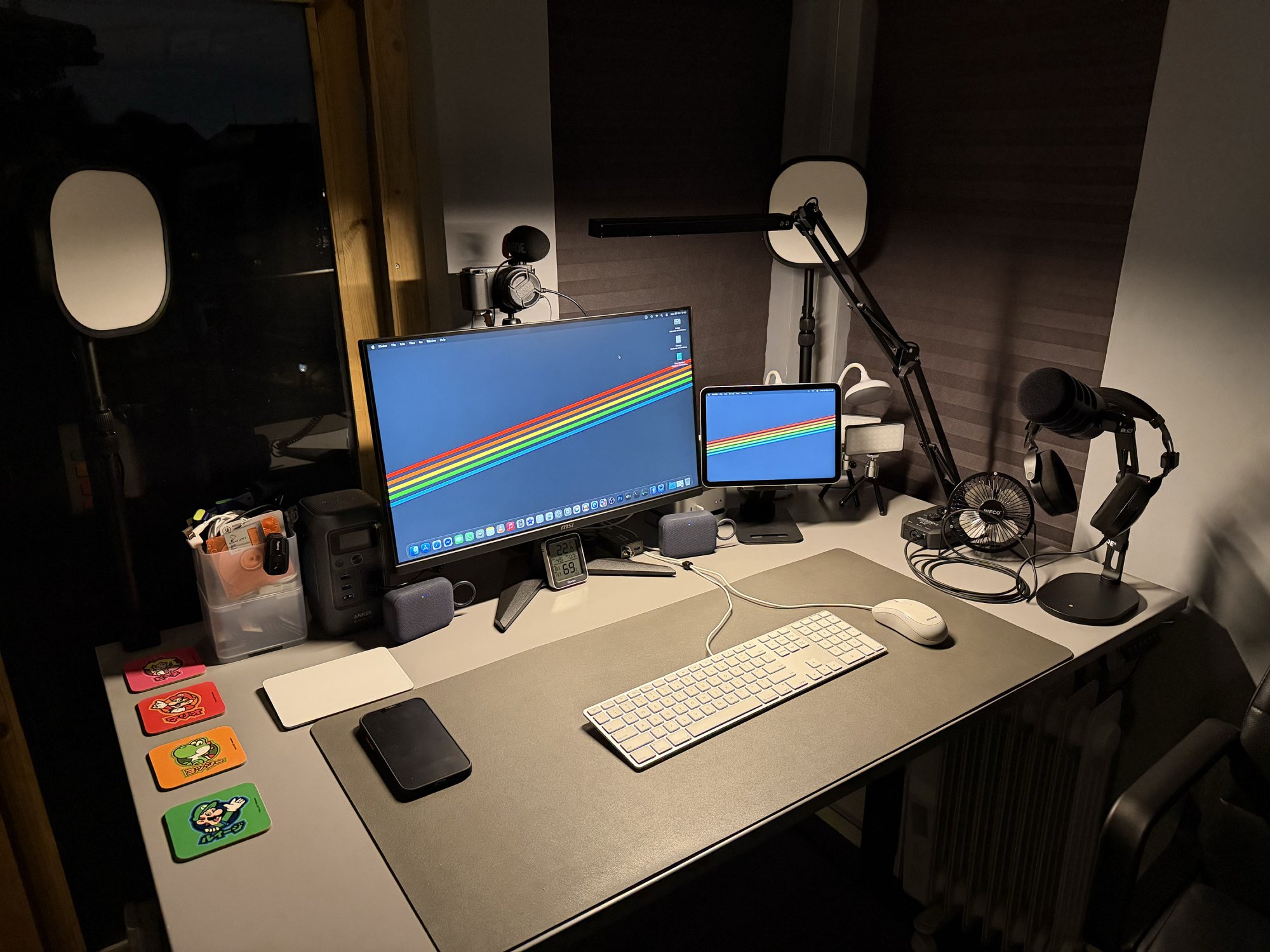

Here's my set up in my studio. The Mac mini is hiding behind the monitors. I have it on a UGREEN Mac Mini M4 Dock with a 1TB NVMe SSD. I've got a Zoom U22 USB audio interface for it and some RODE NTH-100 headphones and a nice RODE PodMic. The monitor is just some Acer thing but it is high refresh rate, so that's nice and I have an A16 iPad as a secondary monitor but I also use it to control my iPhones that I use for filming.

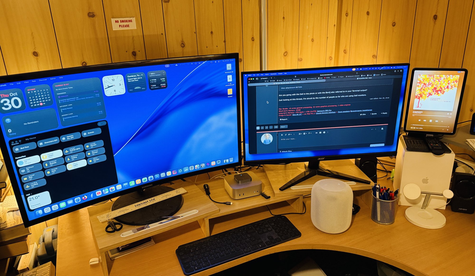

My current set up the iPad is an old iPad Pro which I now use for playing music through my HomePod. There is a PC under the desk which is connected to the small monitor. I use Logitech mouse and keyboard to control the Mac mini and the PC

Thermal paste on the mini? I thought thermal paste is very hard to remove over time due to it drying up?
I do have a strong mini clip on fan. Just not sure how to point it on the Mini. Im guessing from the front so it pushes the hot air out is the best. Straight down wouldn't have any benefit.
Isopropyl alcohol can clean just about anything. I would bet it would clean up thermal paste also. It's a conductive paste so a thin layer will do. If you use a fan, you just need the air to pass through the fins.
I think a better way to cool the mini might be to remove the aluminium housing. Despite it being a good heat sink, I would think the housing retains much of the heat because there is limited space inside. You won't know until you try.

What about the speakers? Those look nice but are they both connected at the same time for stereo sound?

Thanks. Im going to give thermal paste a try. I got a 8g tube and hope it's enough to cover at least 80% of the bottom surface of my heatsink. Im curious to see if I will see an improvement, I would think I should. I do have thermal pads too but it wouldn't be as effective plus it would likely use up the rest I have left so I went with the paste.

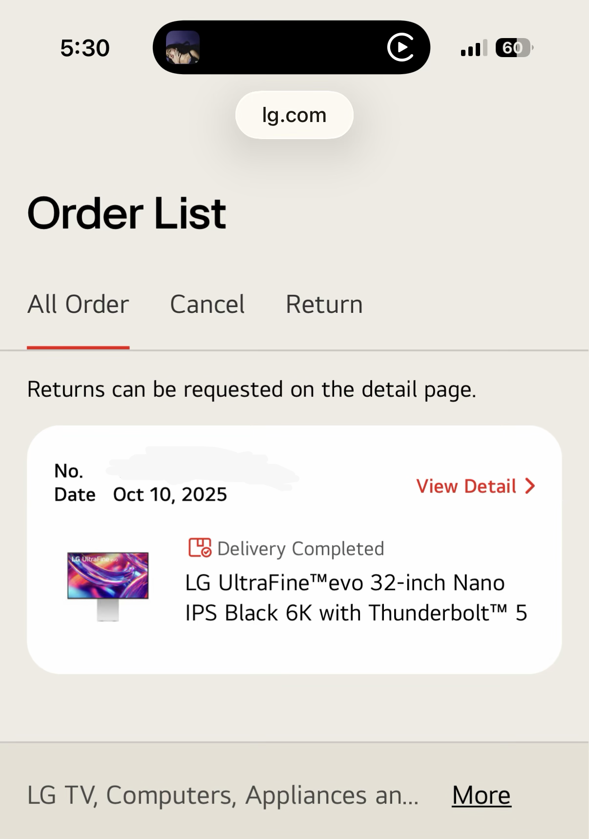

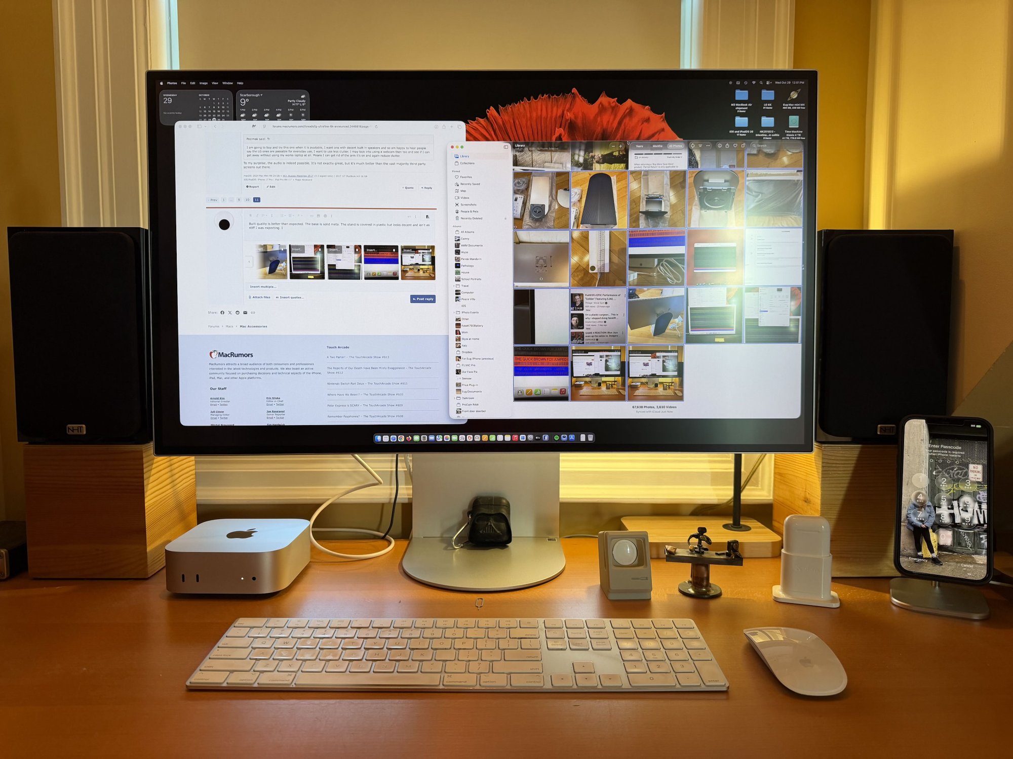

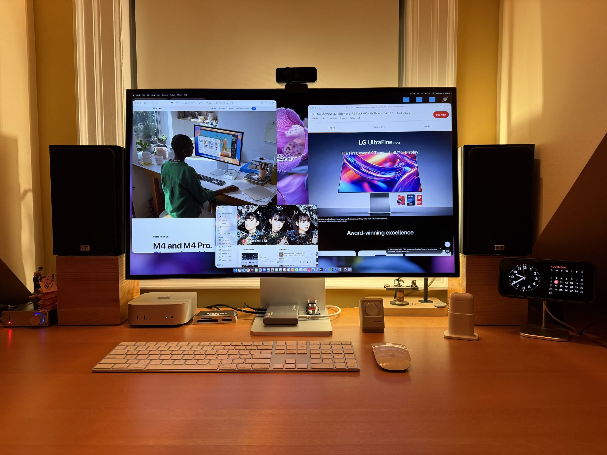

Updated setup, with new 31.5" LG UltraFine evo 6K 32U990A. I can't use its Thunderbolt 5 feature though, since I'm running an M4 Mac mini. It runs great though at 6K 10-bit HDR 4:4:4 with both Thunderbolt 4 and HDMI. I'm using the default 2X scaled 3072x1728 HiDPI setting.

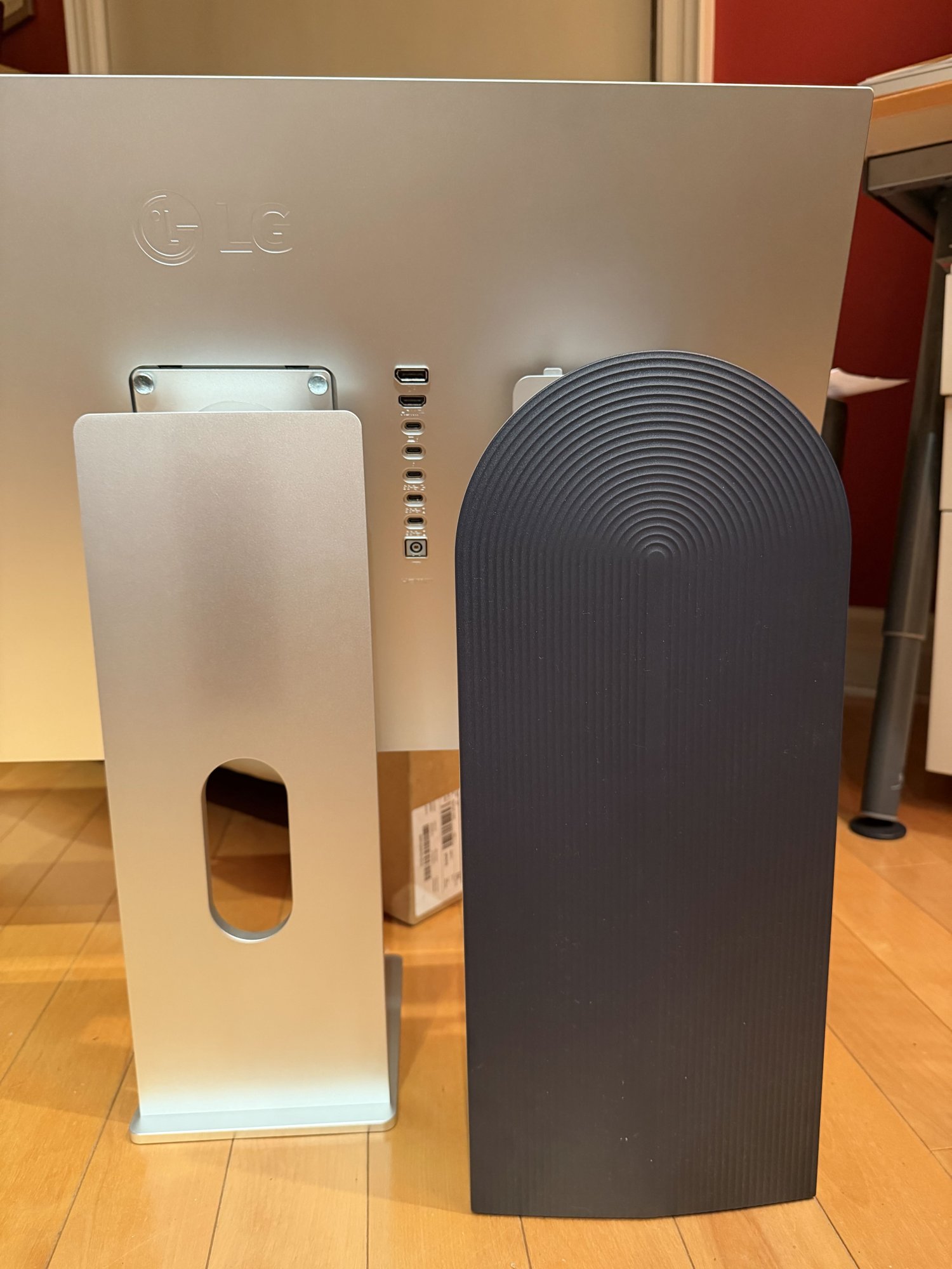

Updated with new stand, solid aluminum, and which allows me to lower the monitor more than the stock LG 6K stand.
Out with the old (blue on the right), and in with the new.
