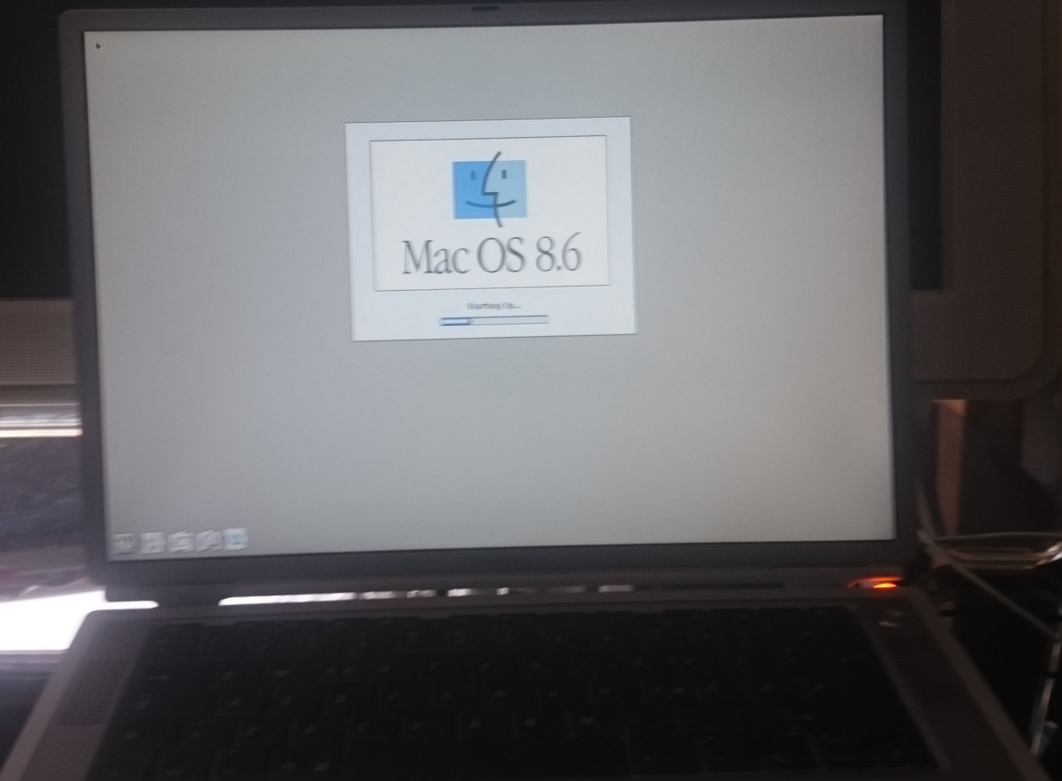

I removed the PRAM battery in my PDQ a few days ago and I've notice some strange issues. Sometimes it won't recognize the PCMCIA card I put in, even freezing up and forcing me to restart. Another weird thing I've noticed is that when I select "restart from the "Special" menu or press the restart key combination, the PDQ shuts down instead of restarting.
Does the PDQ require a PRAM battery to be stable or is this an OS 8 issue? Or maybe something else entirely?

It does sound like a power management issue which could have been affected by the PRAM battery removal. I would try the PMU reset key combo shift+fn+ctrl+power

I’ve tried that key combination a couple of times, but it didn’t seem to make a difference. I reinstalled 8.5.1 again today using Apple Software Restore on the PowerBook G3 recovery disc. I already formatted the drive in drive setup, but I selected the erase option in ASR just to be safe. I also updated to 8.6 just now (I was using 8.5.1 and 8.1 before) because I heard it’s more stable. So far it’s been good with reading PCMCIA cards again. I also found out with regards to restarting that I had to wait about a couple minutes after the Mac shut off for it to start up again. This issue seems to have gone away and restarting is back to normal.
EDIT: restarting is only normal if I have already done one restart since booting from a cold boot.

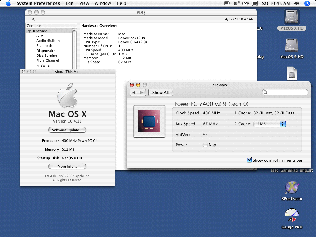

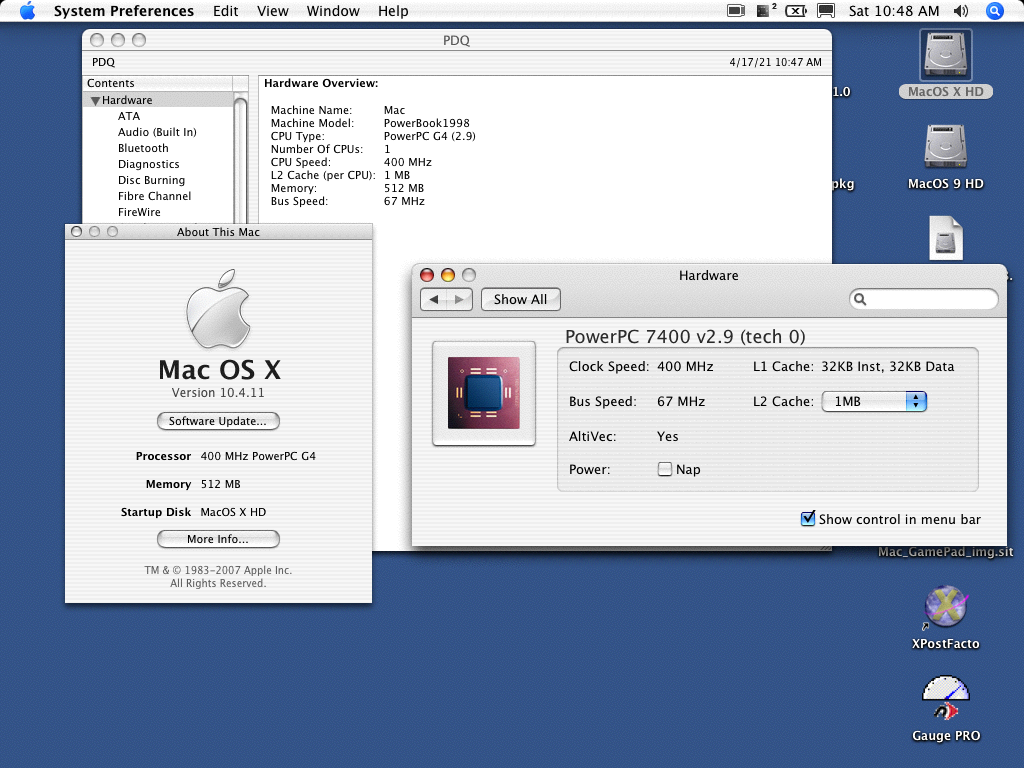

Hi all. Reviving a fairly old thread here... Anyways, just wanted to post that I successfully swapped in a G4 CPU on my original 266MHz CPU card. With the services of dosdude1, I am now running an XPC7400 (specifically XPC7400RX450SK) at 400MHz. The original L2 cache is running at 160Mhz (2.5 CPU clock divider) Woohoo! Things seem pretty stable, though noticeably warmer than with the stock G3.

a G4 7400 will run hotter then the stock 266Mhz G3 750, so that is normal and do keep it in mind that it does run hotter so if you can id look at improving cooling/heat sinking if possible :)
(I assume @dosdude1 has correctly adjusted the vCore to suit the 7400)

@randomdamage im very curious in OS 9 knowing these CPU upgraded OWR machines you will need some sort L2 cache enabler like you do in OS X
so im quite curious if the sonnet software works for it which you can find here http://dosdude1.com/files/macstuff/classicmacos/ce_install_v31.sit
in my experience with a 9600 and G3 beige, the sonnet OS 9 software will still work with even very non Sonnet setups like an Apple G4 ZIF in an XLR8 Slocket
so im very curious to see if it works with your DIY G4 PDQ :) and also im curious if it does, what does it display on startup under the loading bar
a Gauge Pro 1.1/Sonnet metronome and system profiler shots in OS 9 too would be very much appricated :)

Awesome, glad to see it runs well. My main concern was definitely the cooling, so hopefully it stays cool enough to continue running stably. Very surprised you were able to source brand new 7400s, had no idea anyone still sold them.
