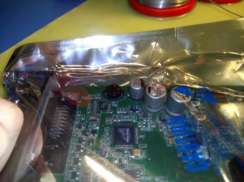

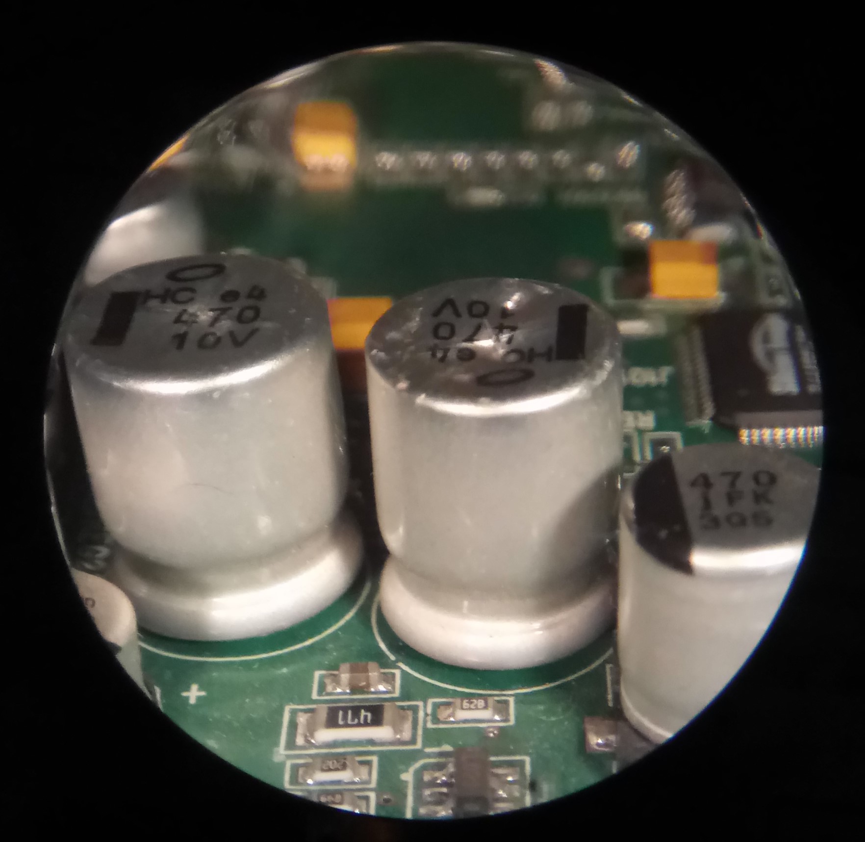

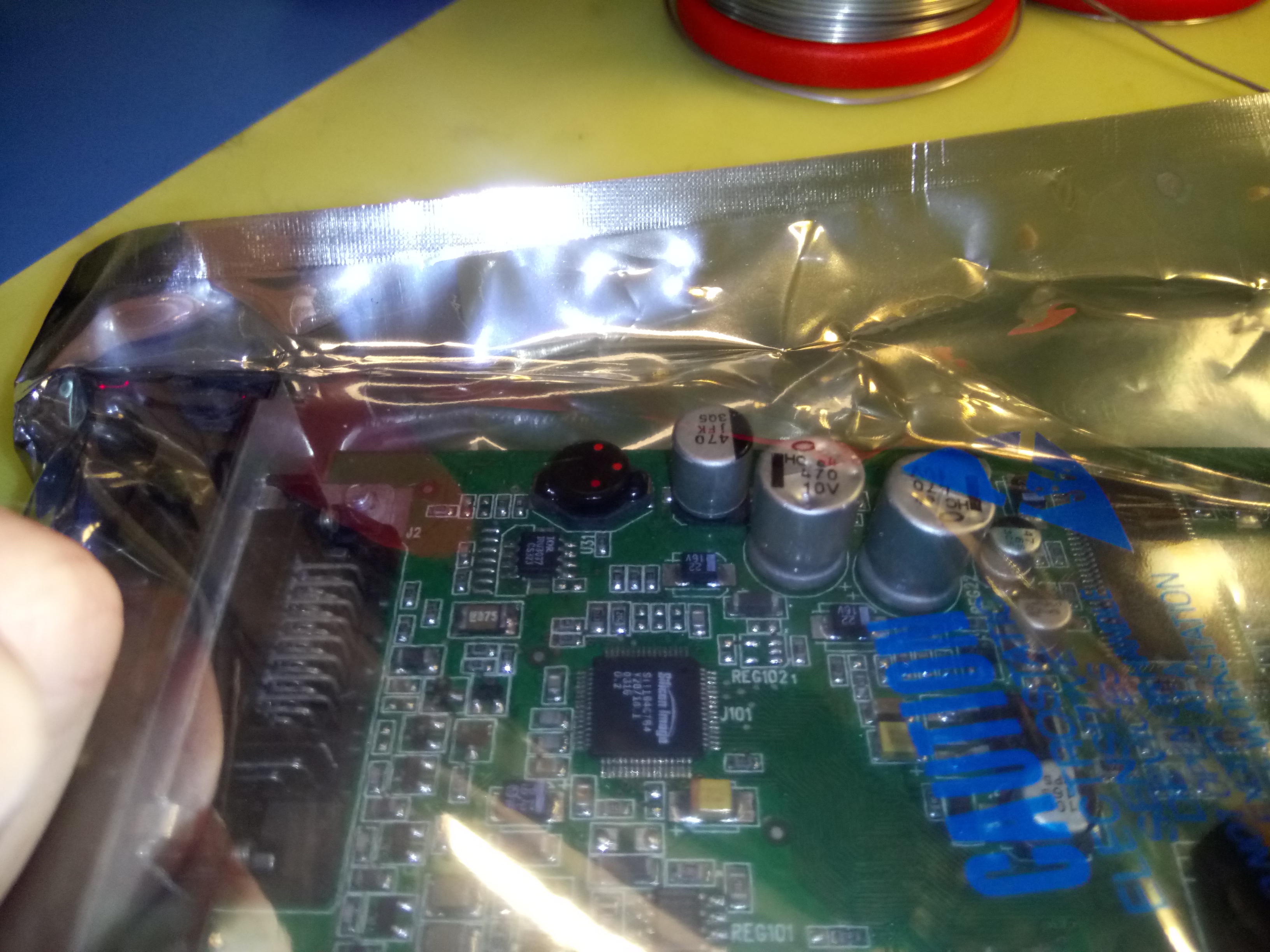

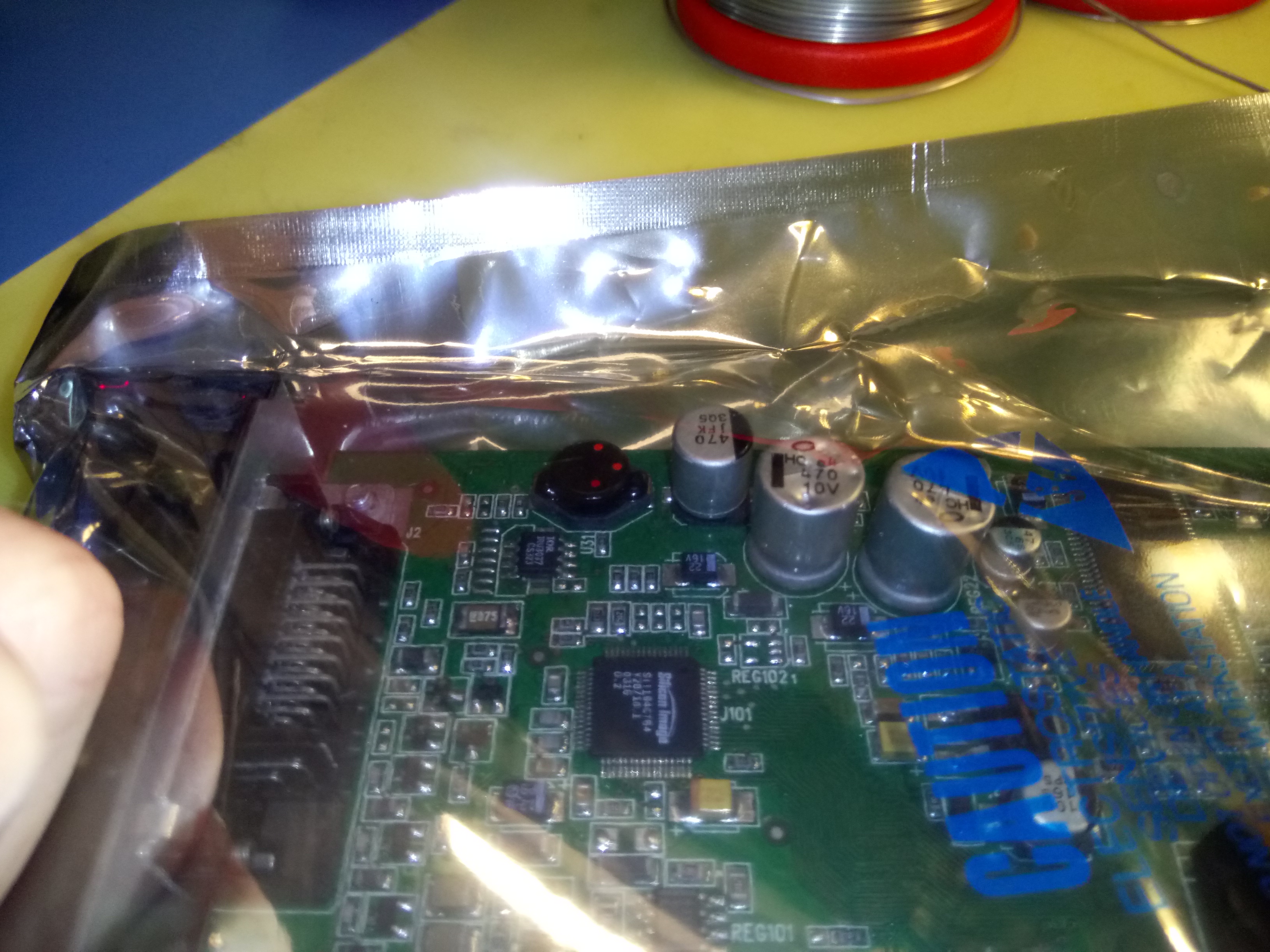

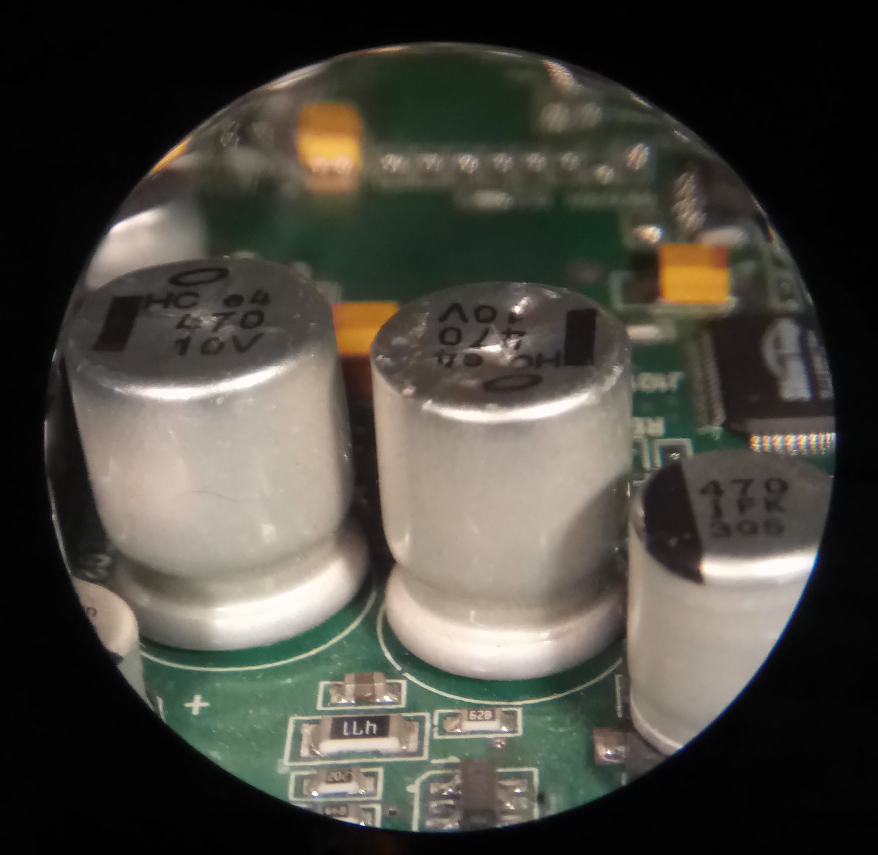

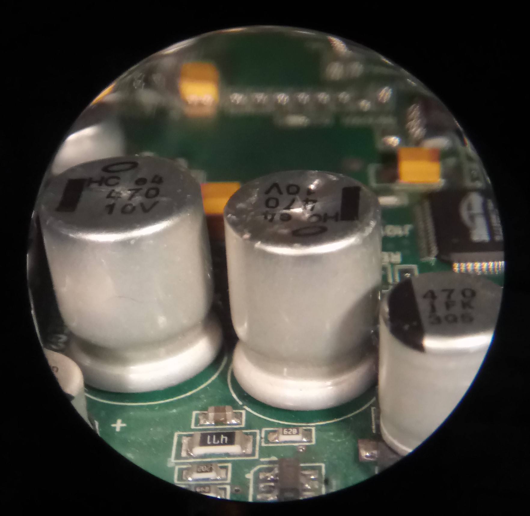

There's four 470µF capacitors that are a little taller than the rest of the components on the board, these look like they have been pounded with another PCB. Indents in the metal on top.
There's not a scratch on the two ESD bags it was placed in - so it's something that happened before shipping, piled up stuff I'm guessing. This was in the bottom of the pile.
So I'm a bit disappointed, seller thinks they're fine they have been tested "for several hours"...
But I ordered new low ESR 105 degree Panasonic caps with 6000h expected life time at the top rated temperature. So those should last far longer than needed.
I'm sure the emergency venting function will suffer from this. Haven't opened the bag yet, took a couple of images, shows pretty well on this cap:

The worst one has a crack in the security vent, it's likely dried up and **** for capacitance. I'm mostly afraid of a short though.
Hopefully it will work out fine when done...
... for free. Got my money back on this one, it's apparently good to be very descriptive and send a lot of images. Below a ruptured cap. Most likely dry.
