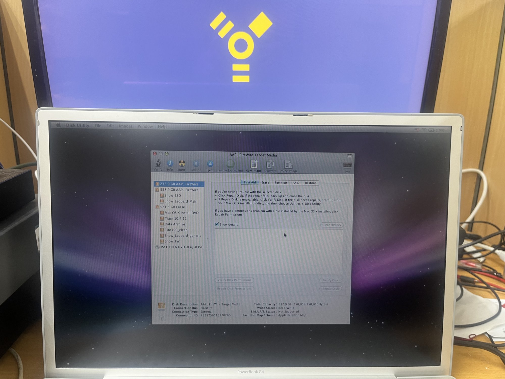

I booted the Quad into target mode and booted a PowerBook from an image of 10.5 installer, and opened DiskUtility: now, the top drive should contain a bootable volume and an empty volume, but none is shown. It was set to be the default at the moment.

@Matias_ Well, it is also not just the HDD – though that is obviously not doing well – since it does not boot without any internal drive either, same three beeps and fans. Regardless of what the primary issue is, looks like at least two independent components decided to fail simultaneously 🤦

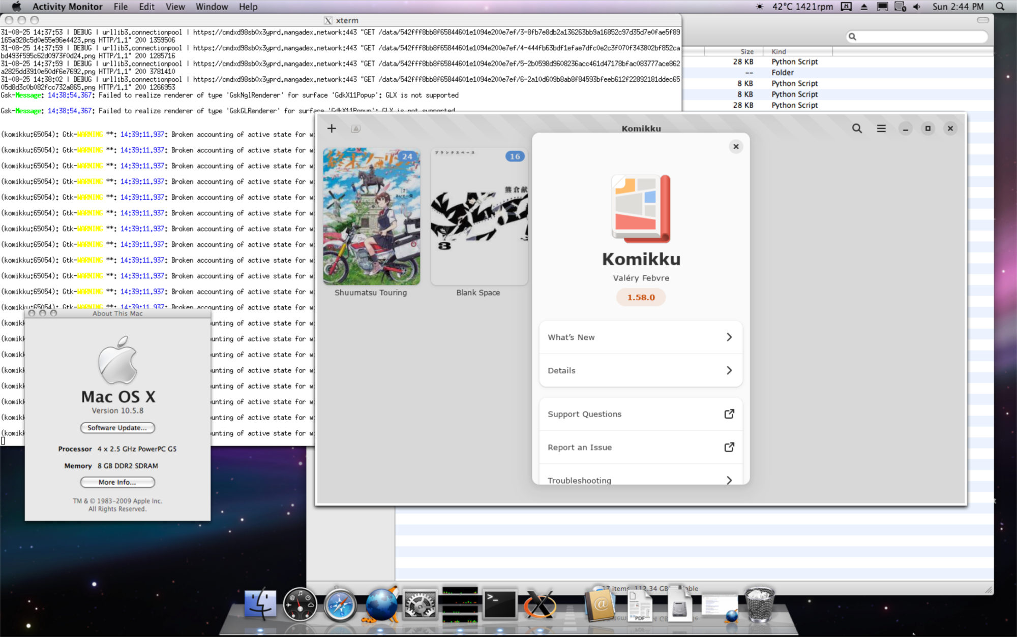

I have been playing with Komikku, a very nice manga reader for GNOME.
After commenting out all the webkit/webview stuff and disabling the (many) sources that needed it, it works pretty well. WebP is broken though (in GTK?), I don't know why.
This is an older version because I could not get newer versions to work due to old libadwaita. It might be possible to get newer versions to work by reverting this commit (?). It depends on some Python modules that are not in MacPorts so I installed those locally with pip.

Update. Provisionally it was a drive failure plus RAM. (I really hope no logic board issue, that would be a disaster.)
I am now running from SSD on two sticks of RAM out of 8, and for about an hour no panics, and I was able to reboot without a failure. Now I will try to install 10.6.8 from scratch (the copy I have installed on SSD had a wrong OpenGL, as I recall, which caused linking issues), and maybe by morning, if no KP again, I get a working installation. Not the way I wanted to spend Sunday night LOL

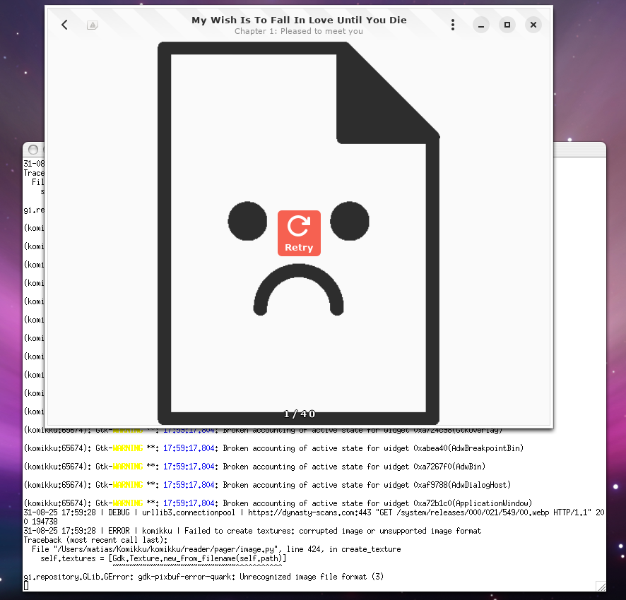

What are the symptoms? How broken is it?
The images are getting fetched but not displayed and I get some GLib gdk-pixbuf error that I don't understand.

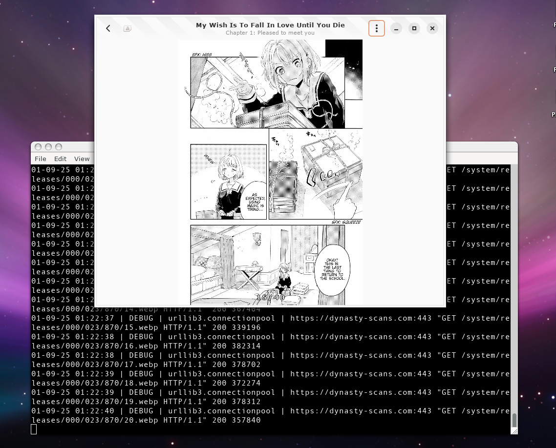

You probably need to install this: https://ports.macports.org/port/webp-pixbuf-loader
That was it, thank you!
