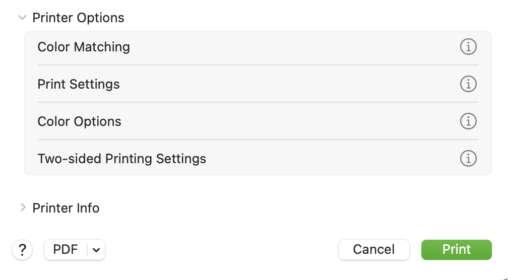

Once you've set up again, you won't see AirPrint in the "kind" field if the driver is selected correctly. Another easy way to know if you're using Epson's driver or not is that you get a lot more options in the print screen. When printing, under Printer Options, you'll get all these options (each with their own dialog) vs. more generic Apple options:

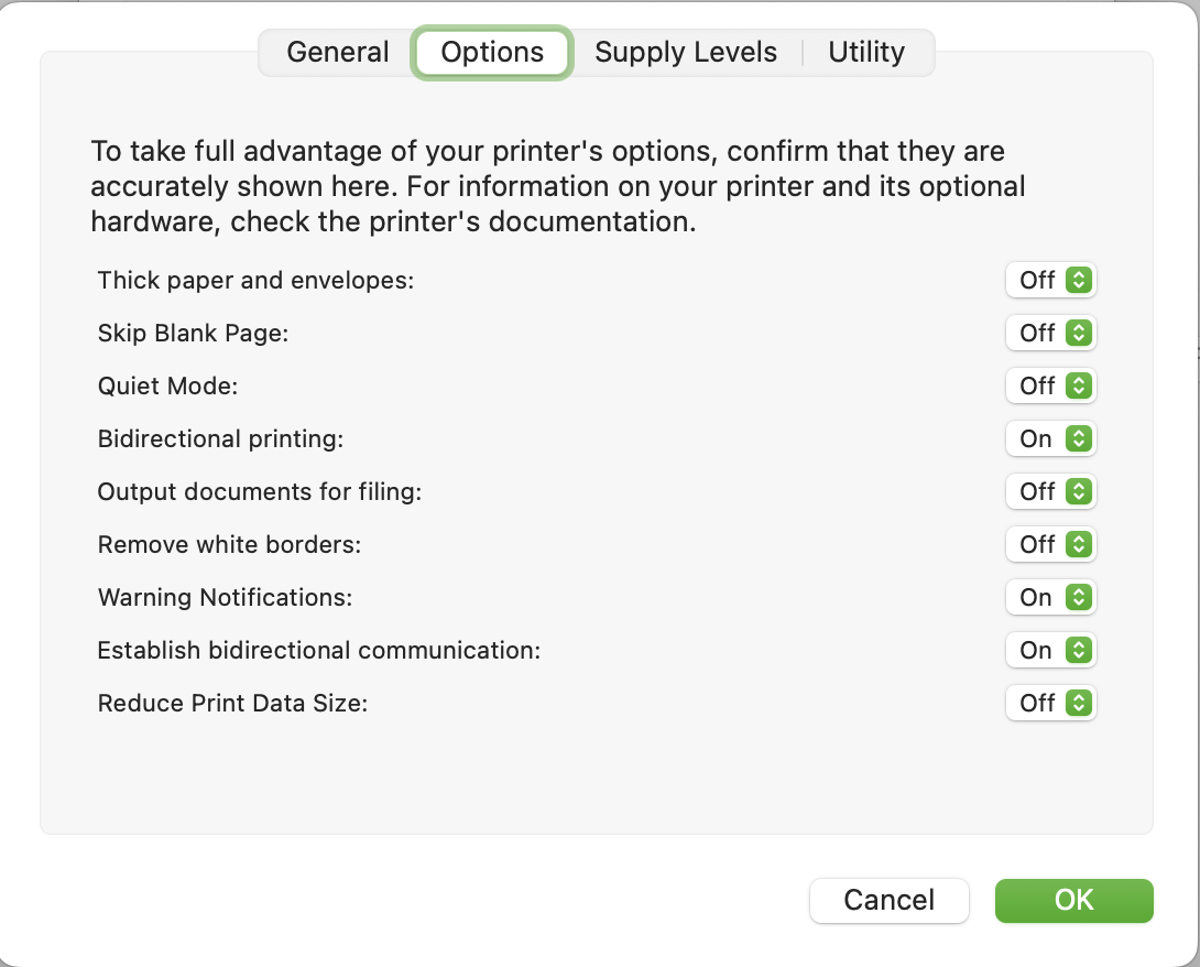

FYI, my Options tab looks like this:
