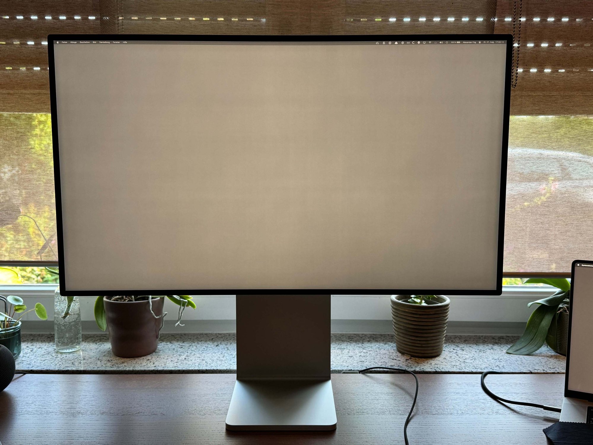

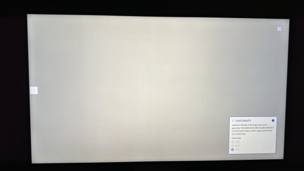

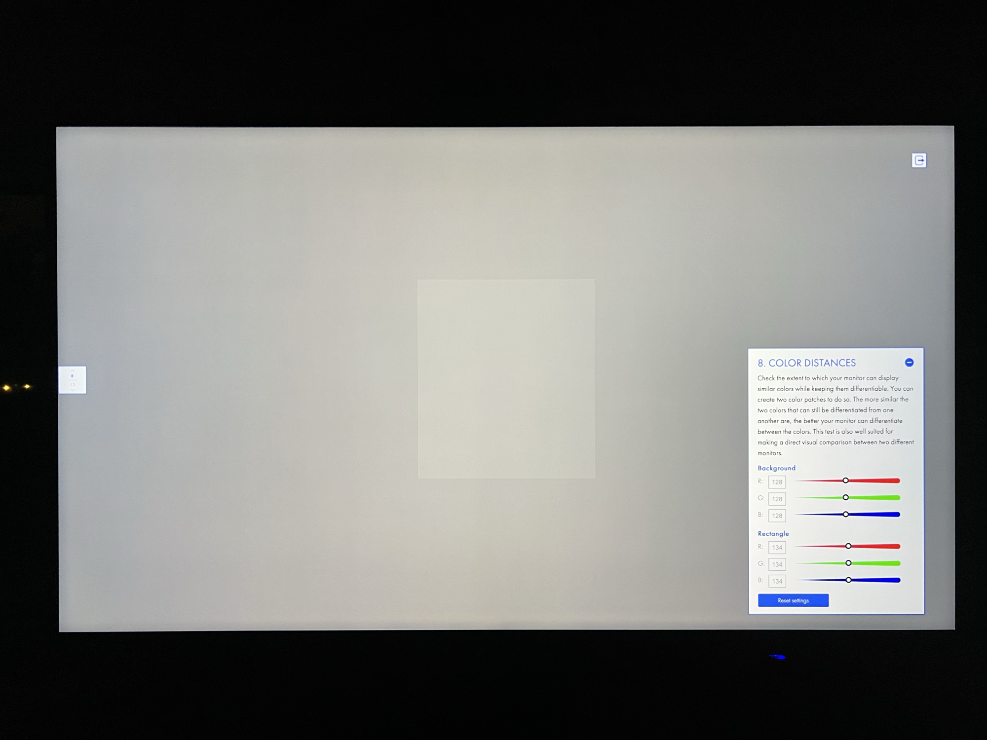

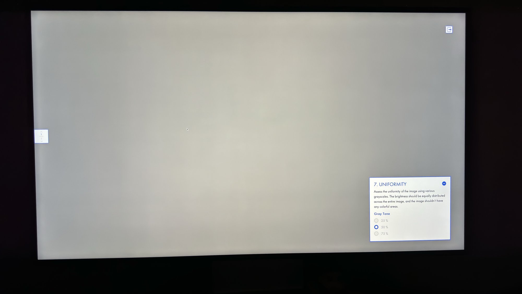

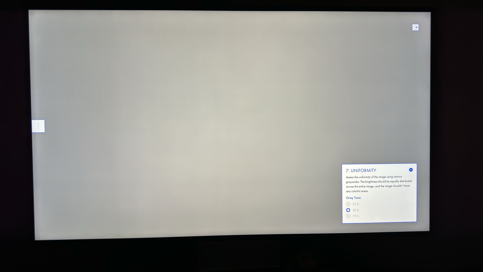

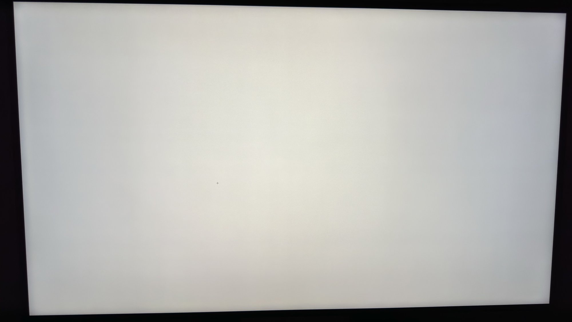

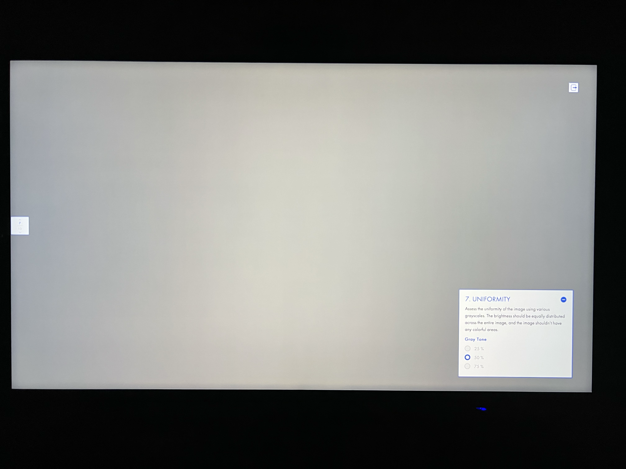

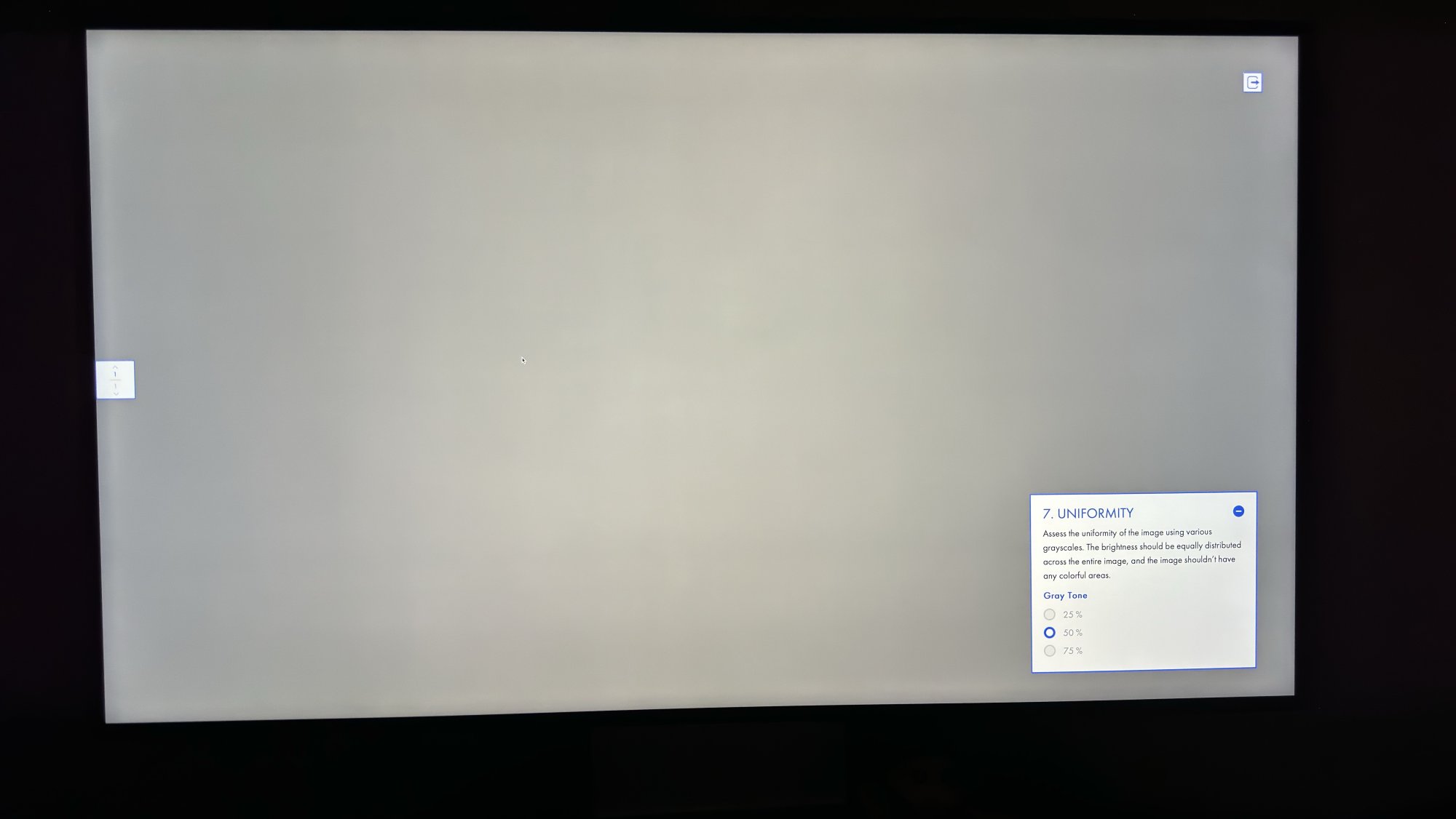

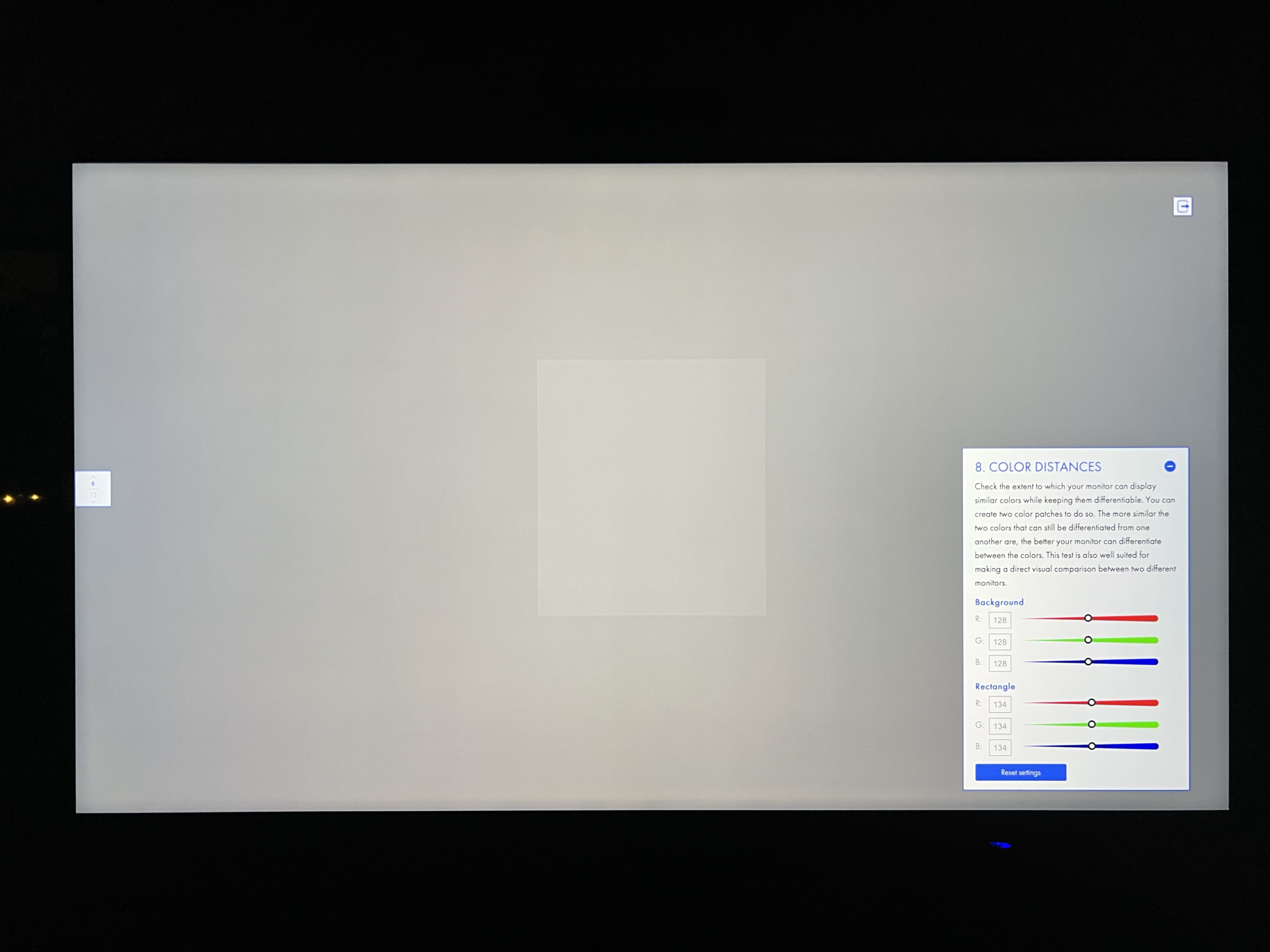

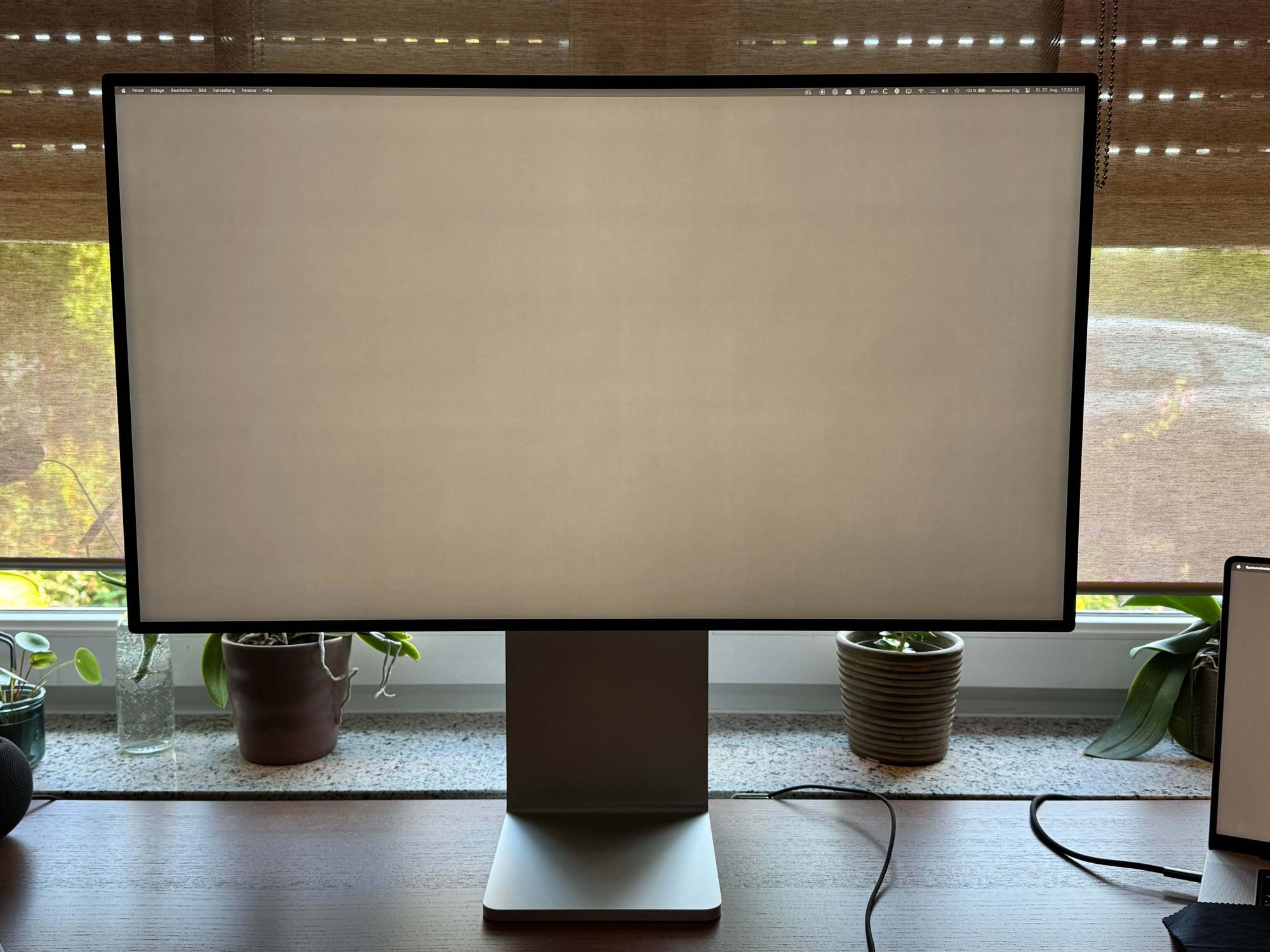

After a long call with AppleCare, they told me I had to bring the display into the store so I have a Genius Bar appt for today. Attached are some pictures I took with my iPhone 13 Pro to show the Genius. I'm concerned that at the appt they are going to "not see" the issue and refuse taking it in for repair. Anyone who's been to an Apple Store knows how bright those stores are and it's impossible to see these kinds of issues especially given they only show up when the display is set to < 50% brightness. I know the phone is not optimal to represent the issue but do people objectively see issues with my display? I see bright bars around the edges and in the center, and dark bands when scrolling with a white background. The YouTube video posted in this thread was very definitive for me. Wondering if I am being too critical.
I for sure see the vertical banding. But I am so critical now too. I'm like looking for it. I compared it to my wife's nano-texture Studio Display, and the nano-texture Studio Display in the Apple store, and they do *not* exhibit DSE. It's just the nano-texture XDR's.
Precisely. See my previous comment. It was *so* hard to get them to believe me. Two separate technicians (and IMO, the entire Genius management team at the Broadway Plaza store in Walnut Creek, CA) basically decided that there was no issue. My pregnant wife had to call Apple Support and complain on my behalf in order to get them to exchange the display.
Picked up the third one yesterday. And it too has DSE worse than the second one (lol). Considering taking it to another Apple Retail Store, just because I don't think Broadway Plaza is going to deal with me again. Sigh.

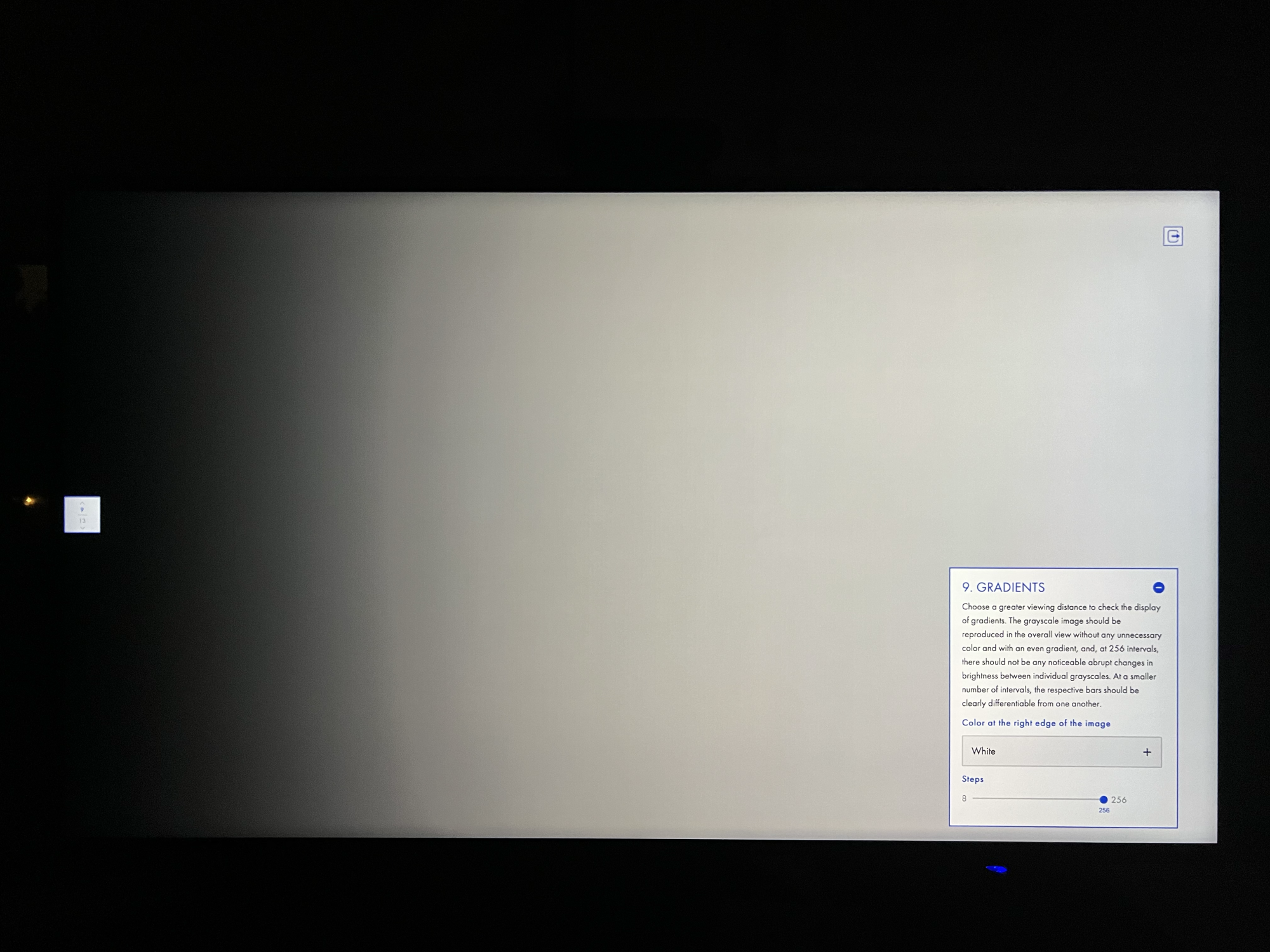

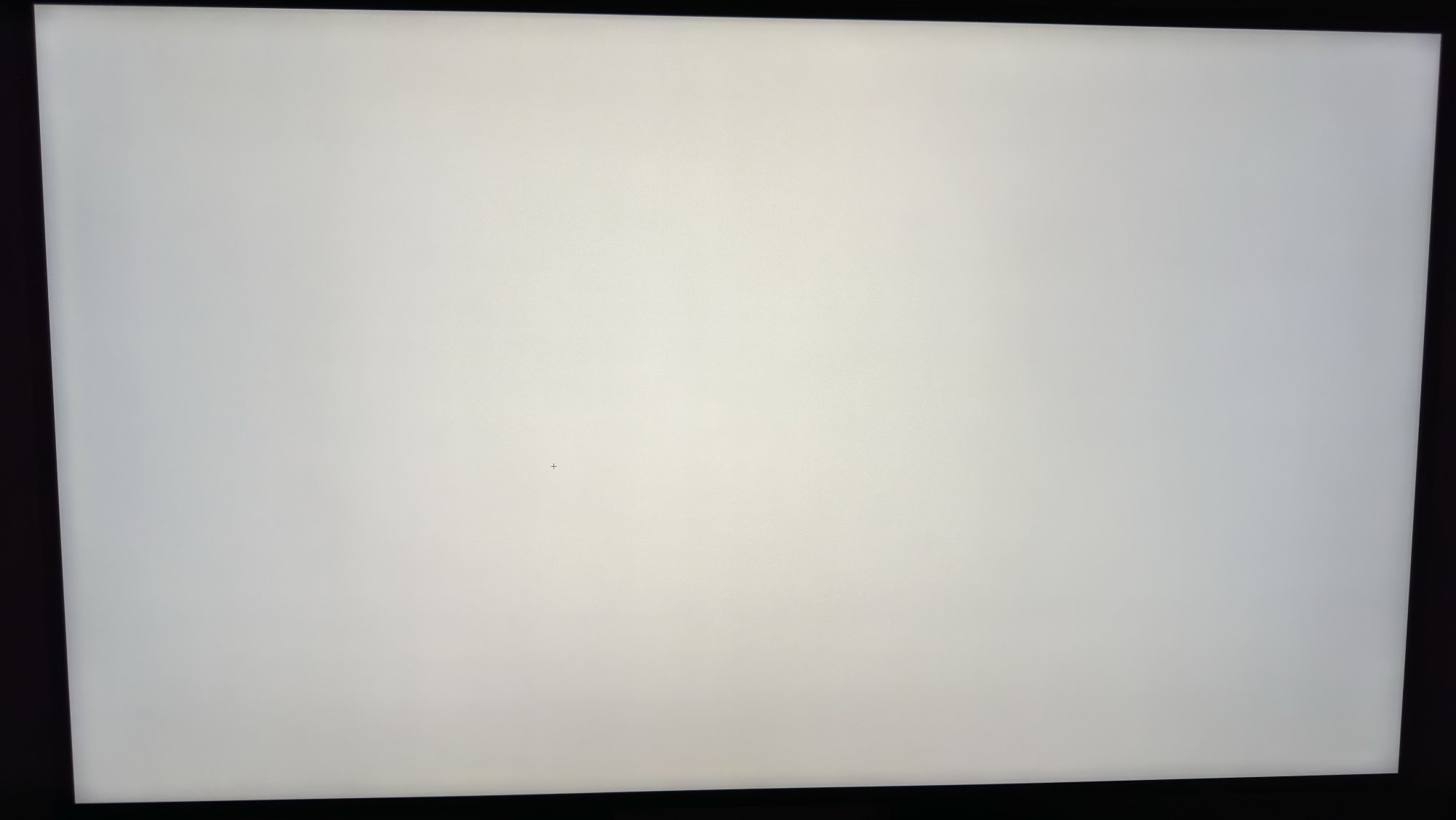

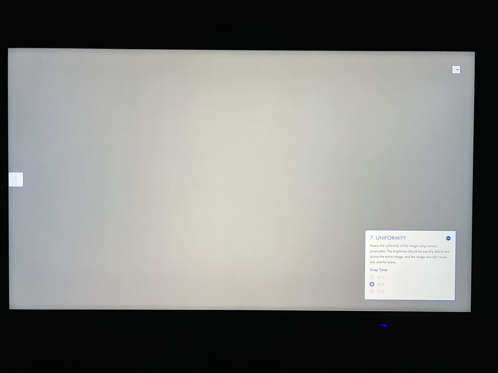

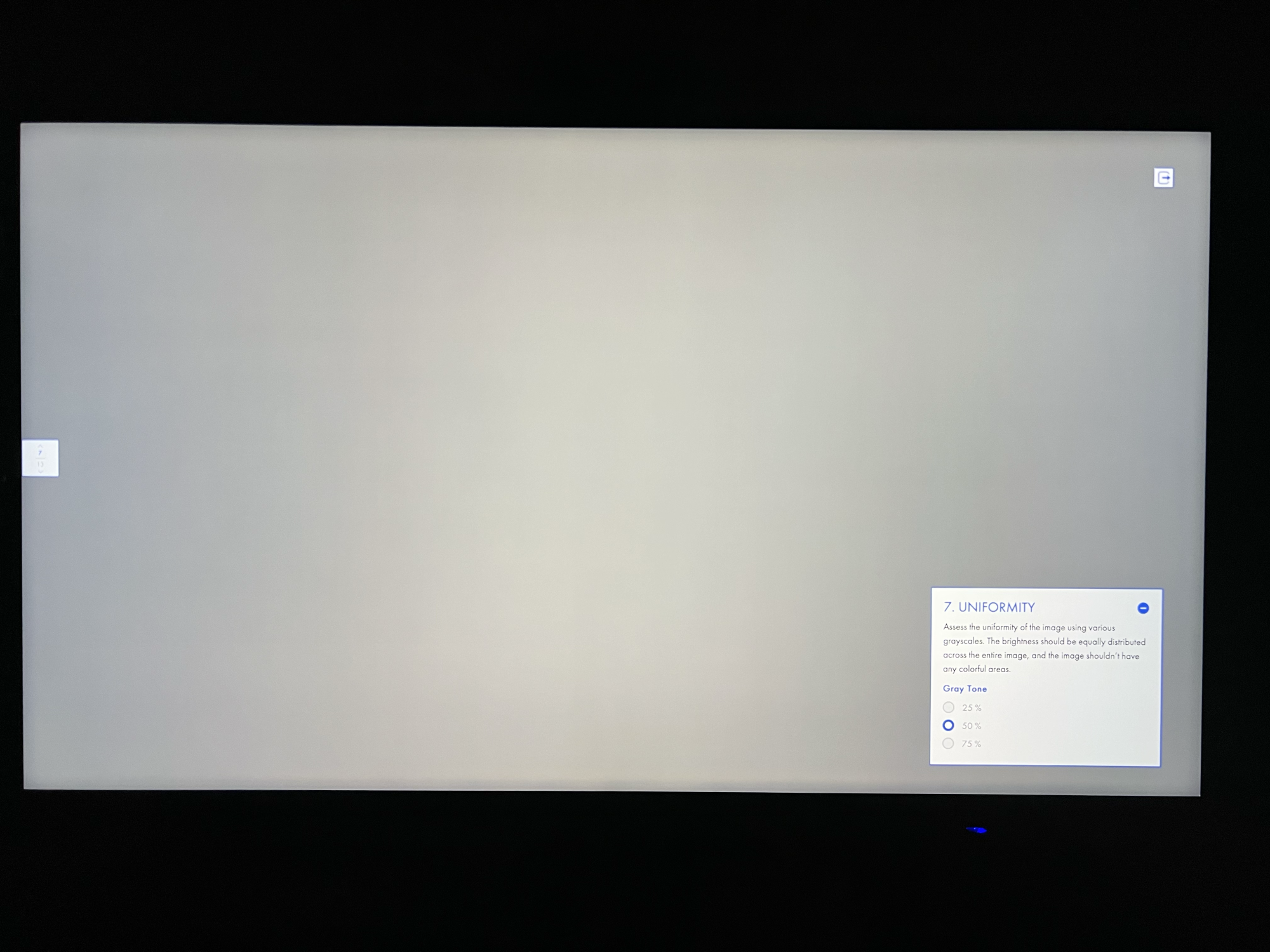

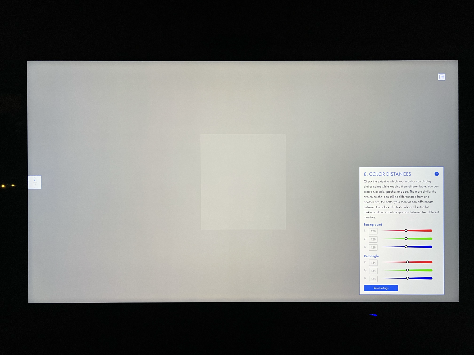

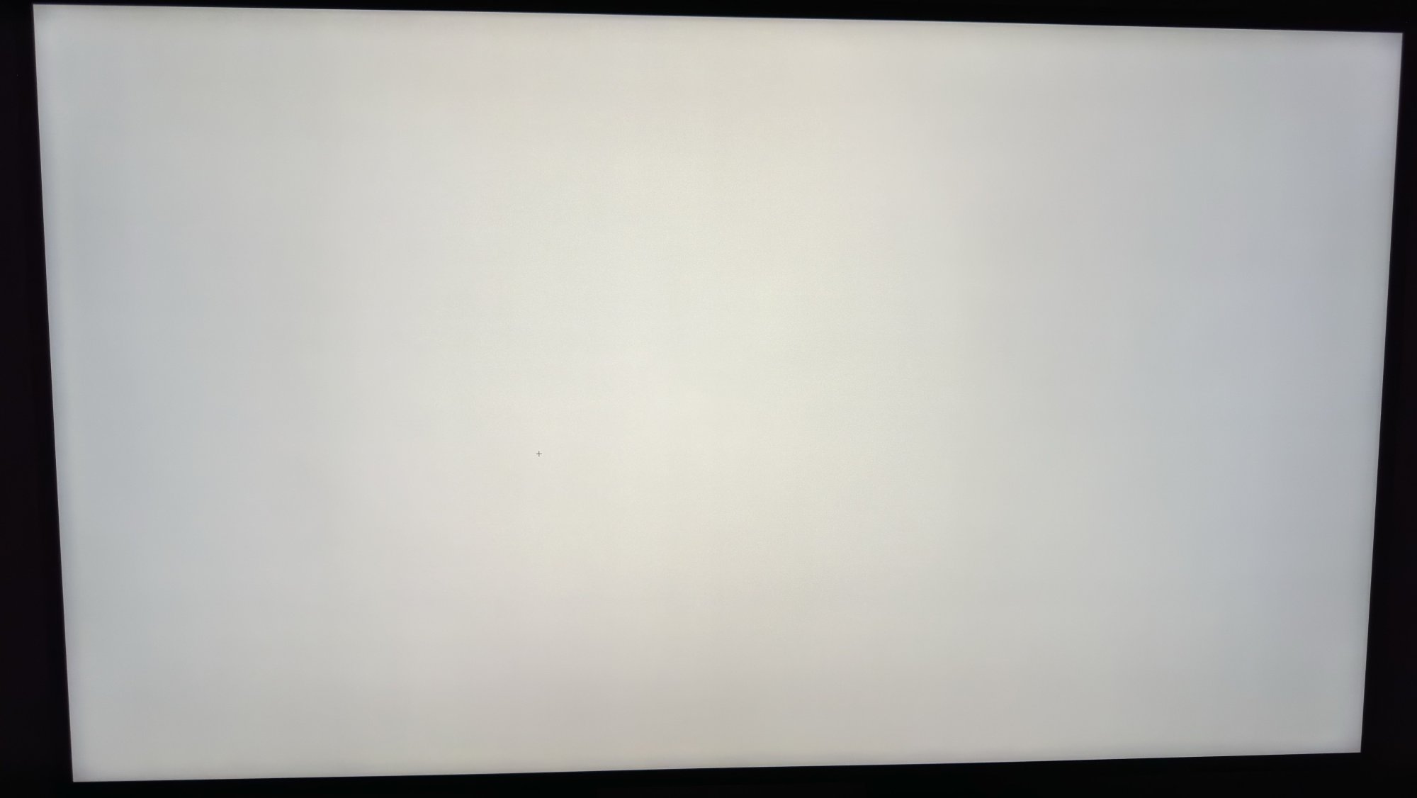

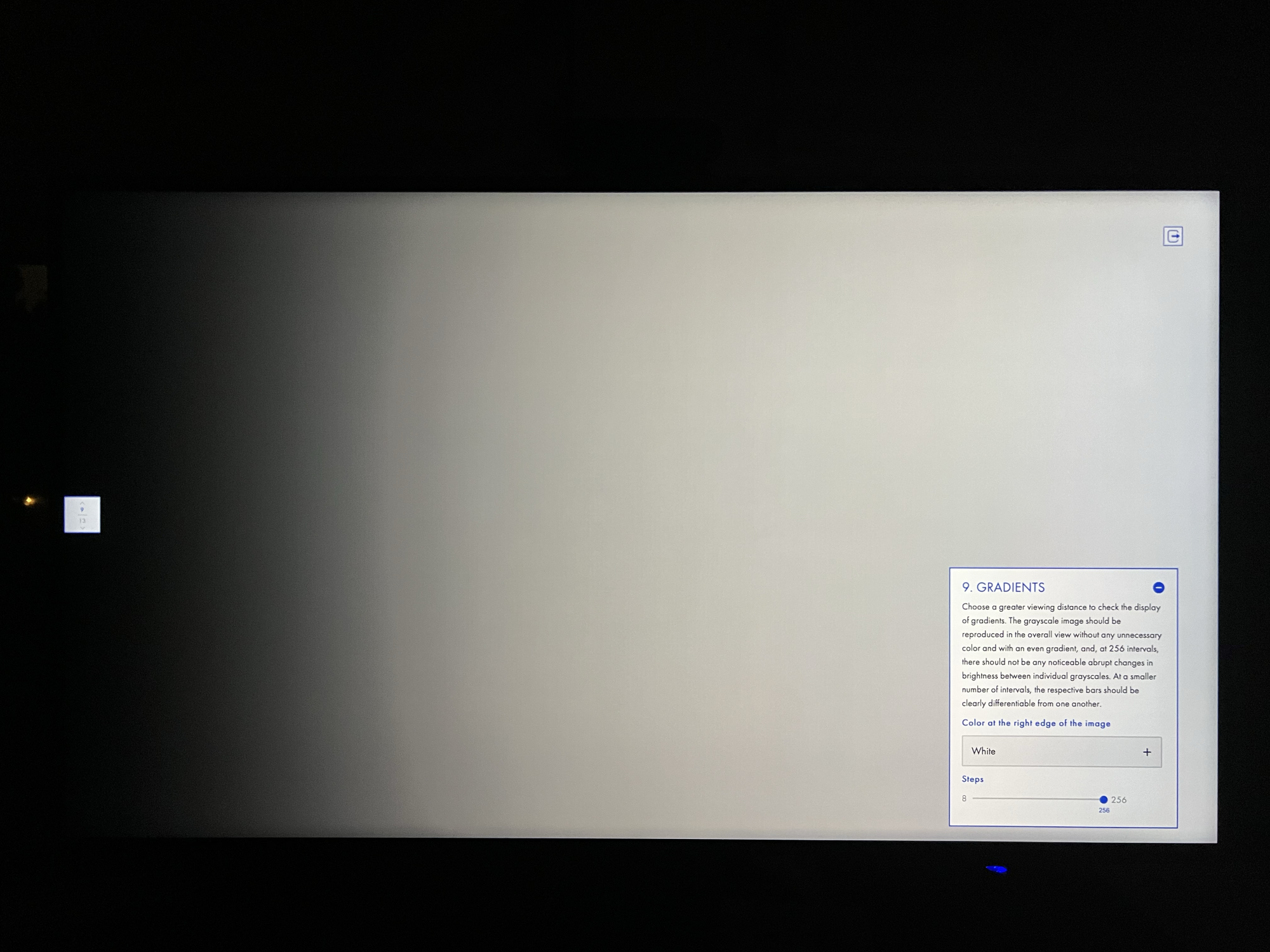

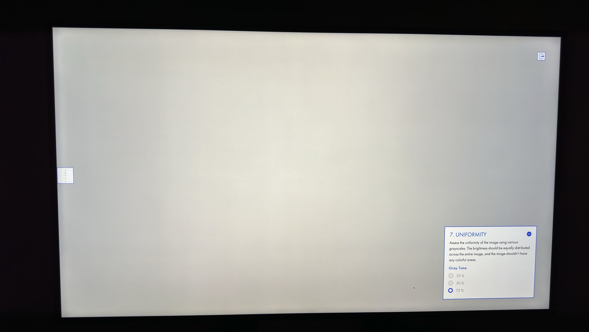

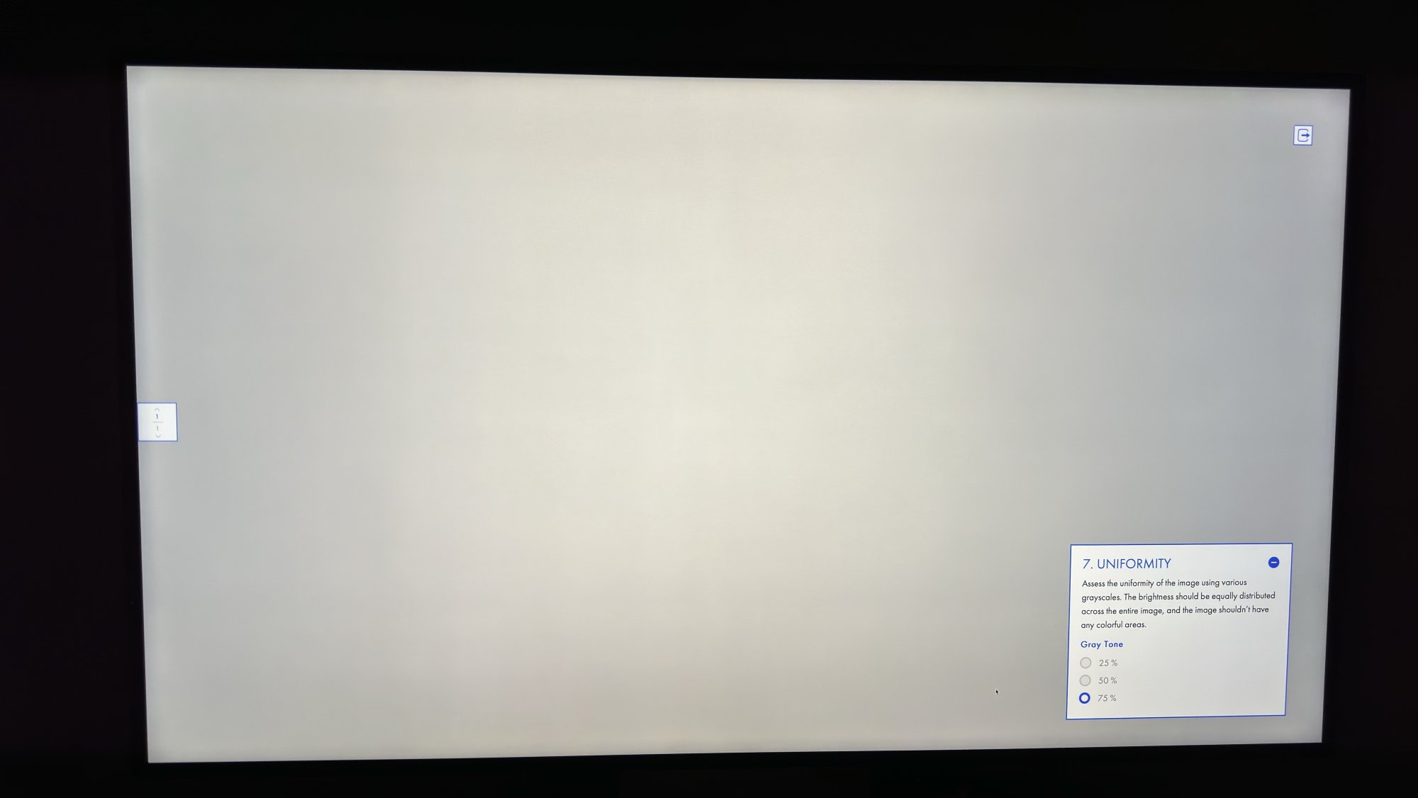

I got the nano version. The screen uniformity seems ok, but I noticed all sides of the screen seems to be darker or shadowy (especially the left side and the bottom). The screen brightness sits at 5 level, no true tone. I tested on 50% grey, 75% grey and one white wallpaper. Thoughts?
Yeah, seems pretty much "par for the course" for these displays. I would still take an XDR over a Studio Display, but I don't have a problem lighting money on fire, it seems. I really would not recommend the XDR in nano texture though. Seems like the pro's of the anti-glare really aren't worth the cons, which are at best, a crapshoot as to whether it will have the DSE or not.
When you’re paying 5-6k for a screen I just don’t think that non-uniformity is okay. I went through 4 units in 2023 and this week settled on a Studio Display. It’ll do me for a few years until the XDR either sorts itself out or gets updated.
That's why folks buy EIZO, and even BenQ (though their firmware is written by idiots) for photography.
Oh for sure man. I don't disagree. Still, it is what it is. I don't think I could get the local Apple Store to do another exchange at this point. I'm just living with it. It really is kind of stupid though. It's like paying Dr. Apa dental prices for Western Dental services. My wife has the nano Studio Display, and when I help her with something, I really feel constrained compared to the XDR 😅
Some of what's reported here as non-unformity is just a function of the viewing distance. You can't sit as close to a 32" display as you can a 27" display and even the Eizo and BenQ displays will show what looks like a fall-off towards the edges just due to the incident angles of viewing on the pixels. I have some of these other displays, so I know it happens. The nano surface does exacerbate this; I also have both nano and non-nano versions of the XDR and Studio Displays. It would be nice if Apple could figure out how to solve that problem and maybe they will in a next-generation display. Until then, I personally just don't like seeing the pixels on a 4K display, and find that much more annoying than the tiny bit of "dirty screen" effect from the nano coating.

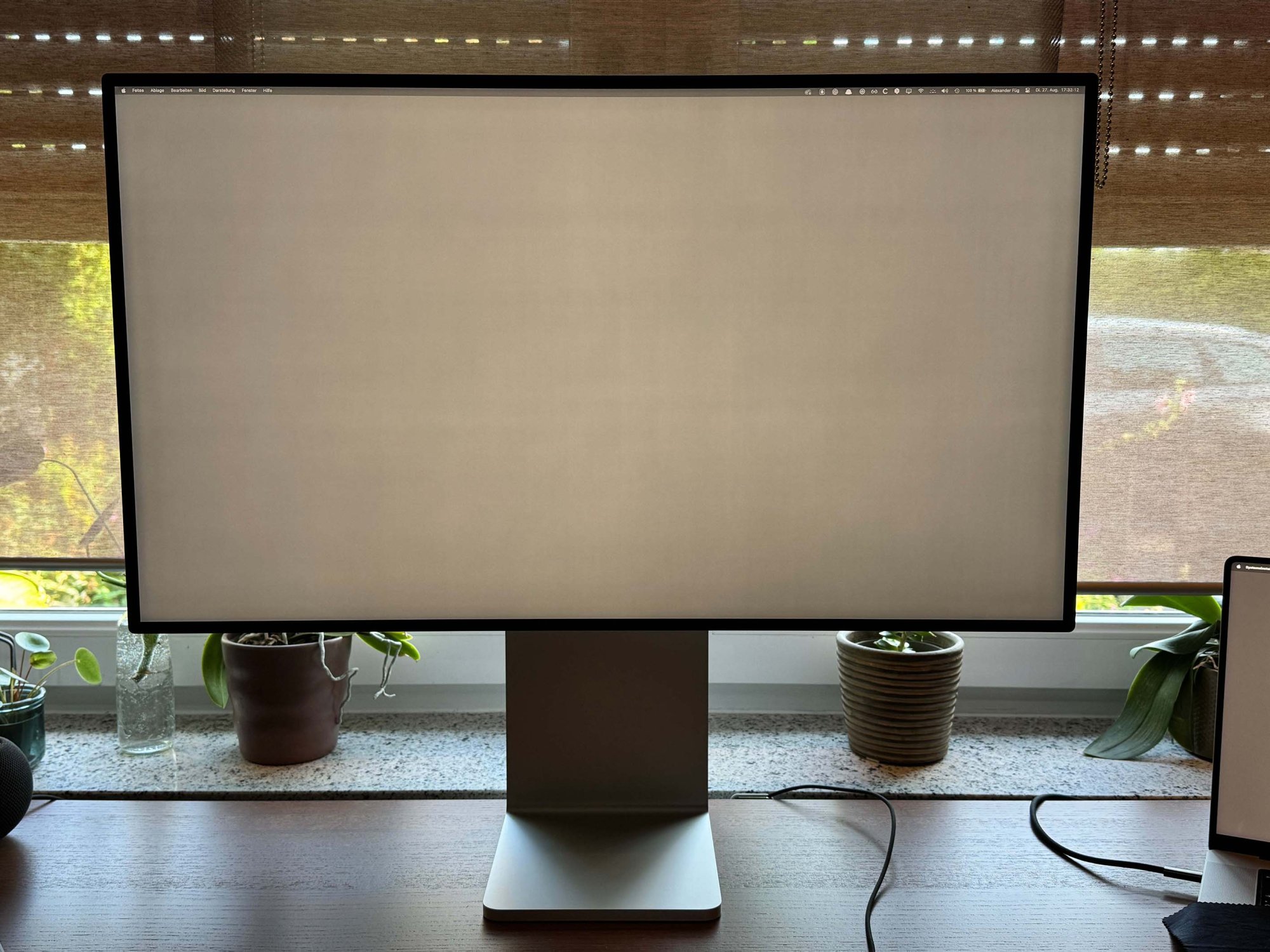

I had this issue on my first XDR and got a replacement, that was really fine with a really uniform Panel. But it had a 1 cm scratch on display. Apple replaced also this one but I had the issue with bad uniformity and also bright vertical lines on the right and the left side. So I decided to send it back and got my money back.
