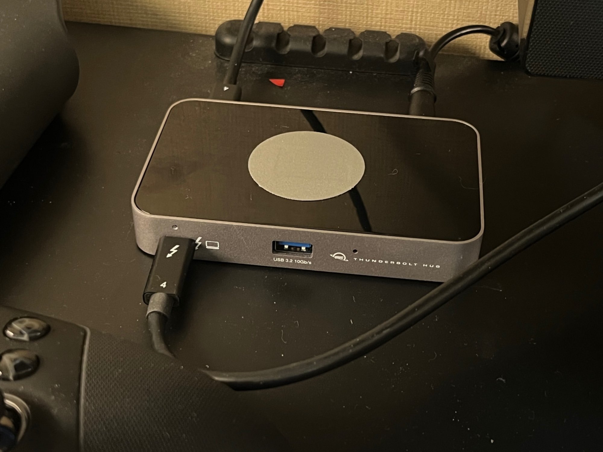

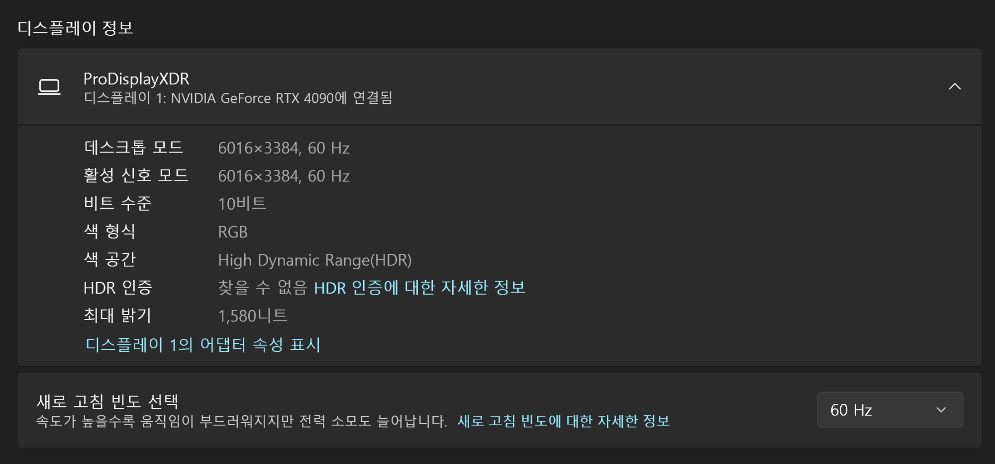

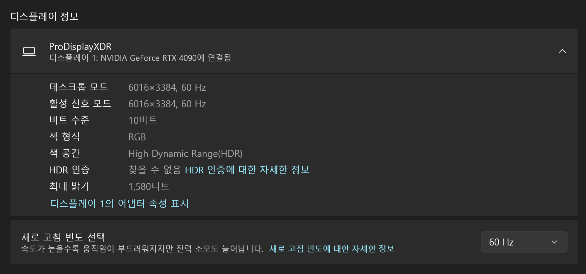

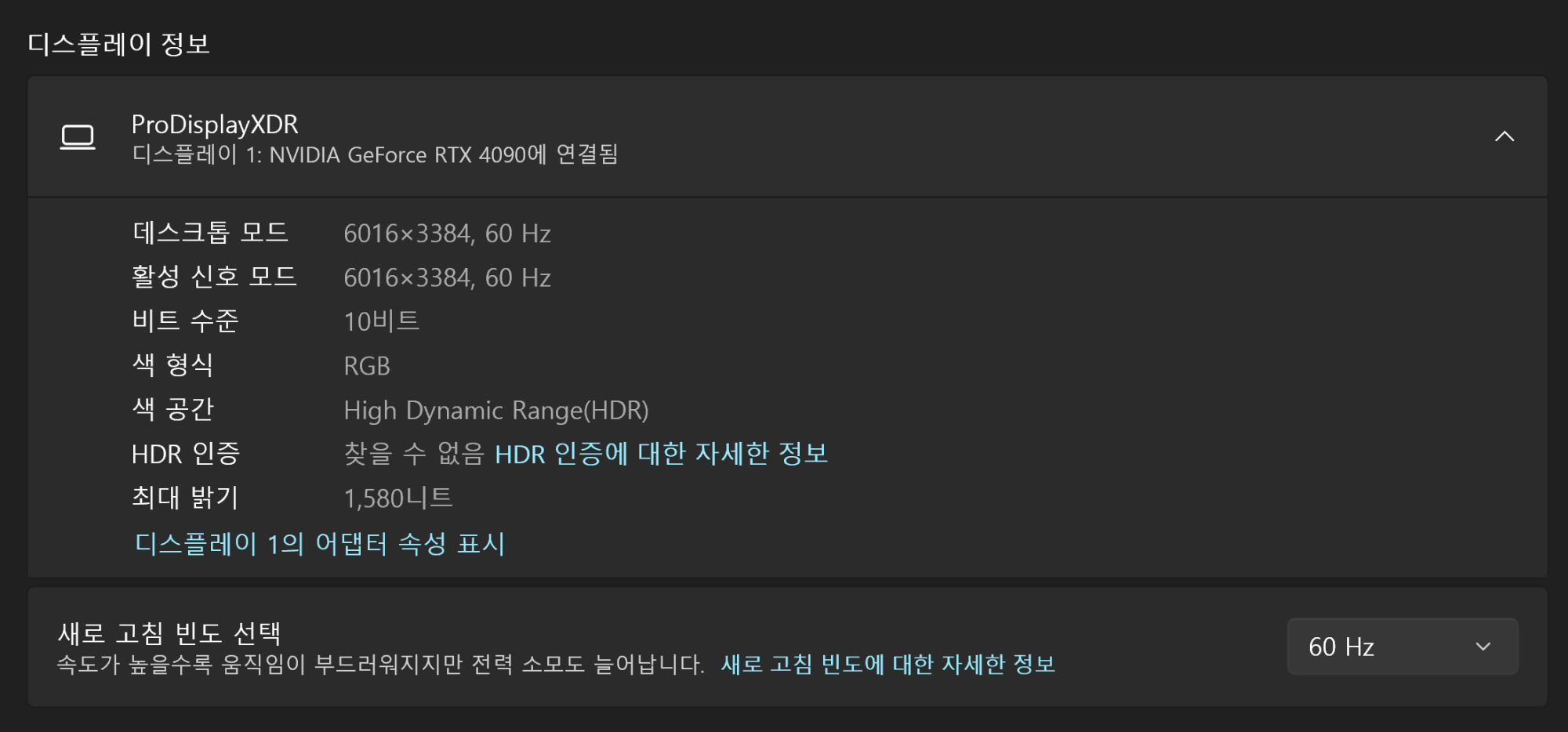

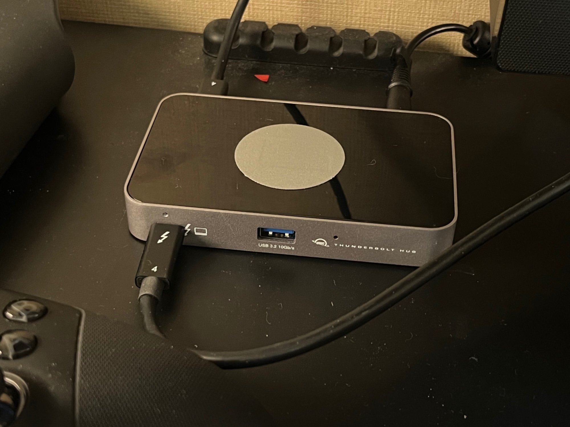

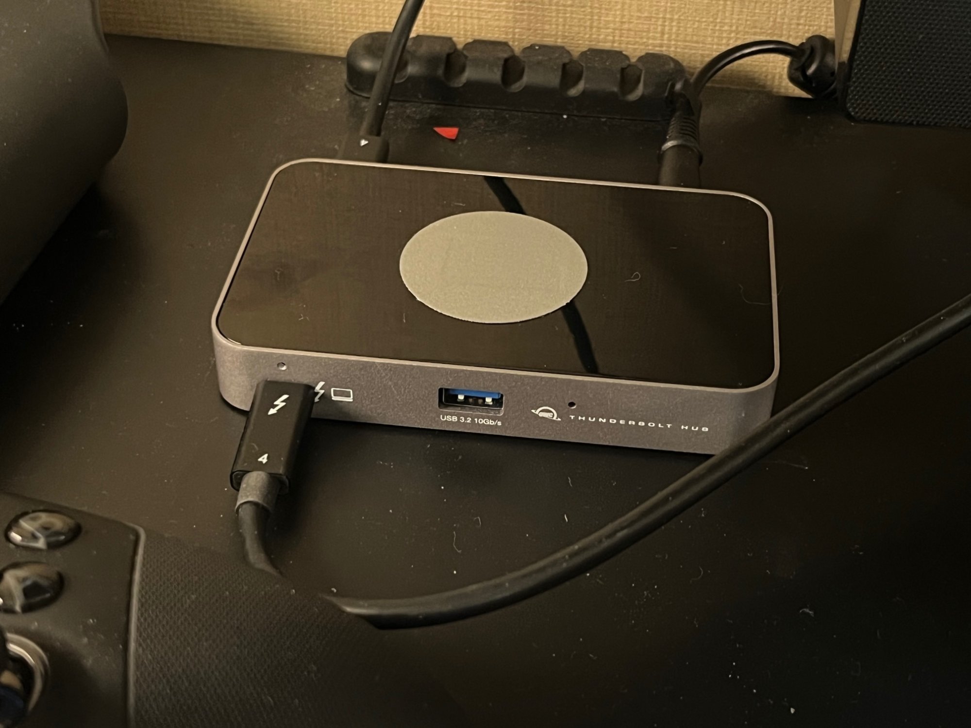

update: i connected XDR display through OWC TB4 hub this time, somehow it was connected in 6k 10bit HDR. i don't understand what have changed inside but pretty happy with the result. note that this worked without Belkin cable, just GPU(4090fe -> MB(z690i unify) miniDP input -> OWC hub(TB4) ->XDR display
hub that i'm using is https://www.owc.com/solutions/thunderbolt-hub
How many DP cables you use in this case? It's really interesting, that it allows you full 6K through TB port.

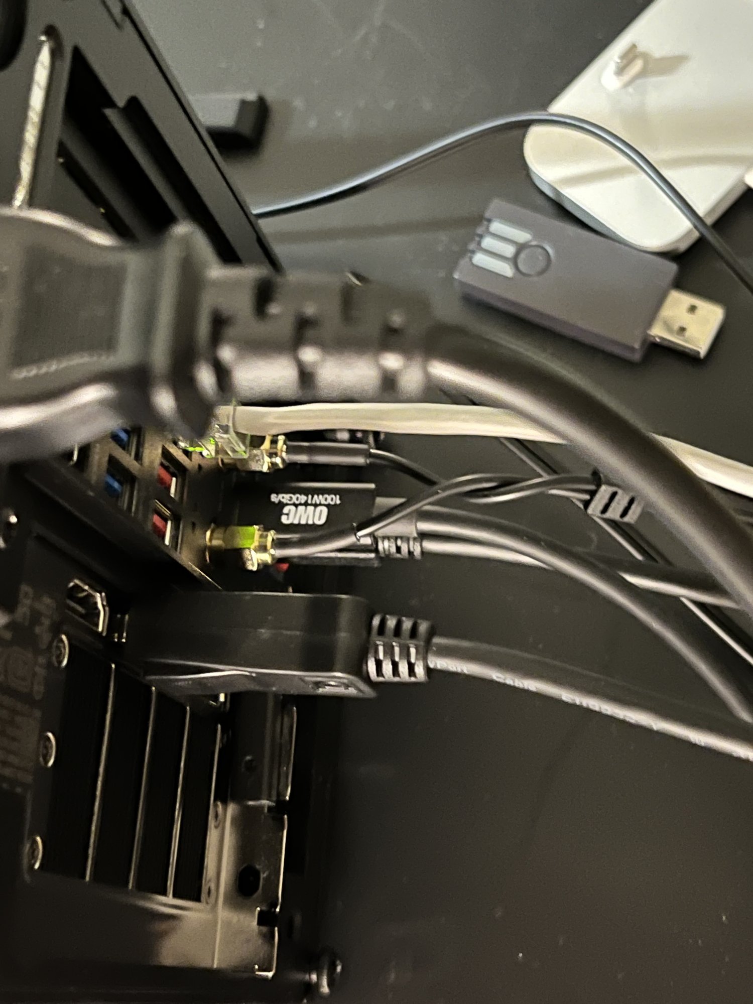

Single Dp to minidp cable that came with the MB. Me either don’t understand how it works.

Wow, super interesting, I'll have to buy this and see if it works with the Asus ProArt. I should still be within the return window of my CalDigit.

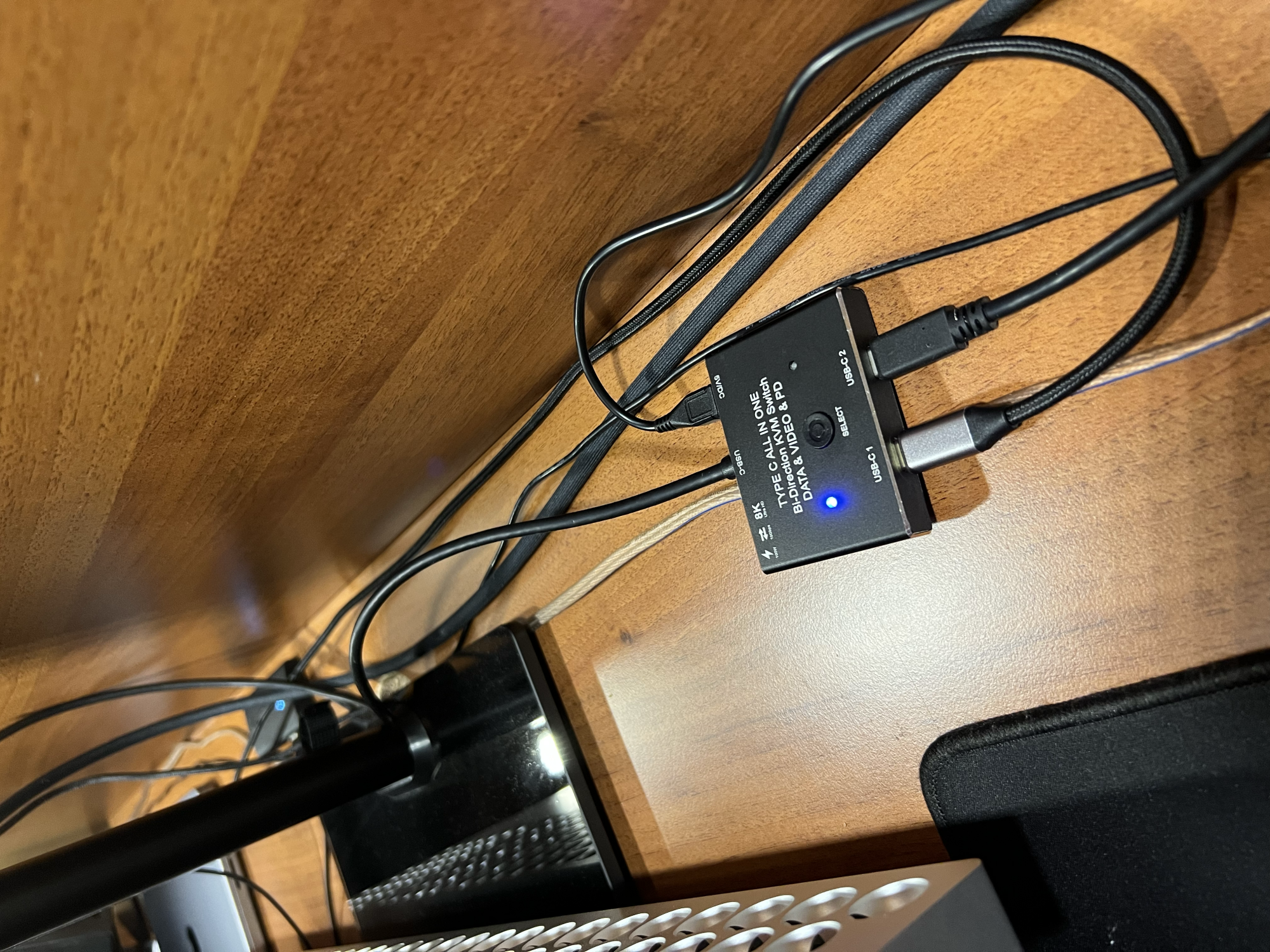

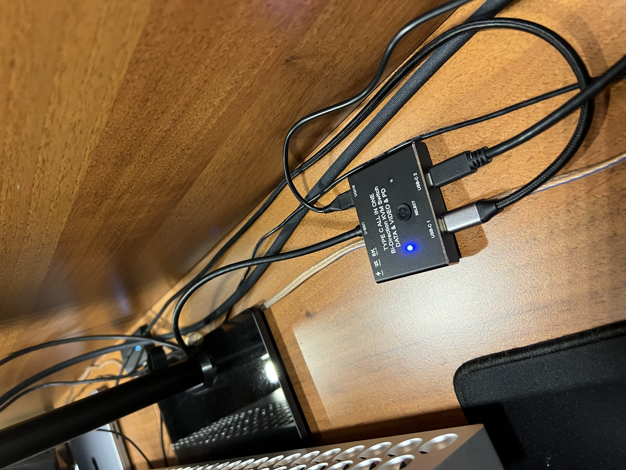

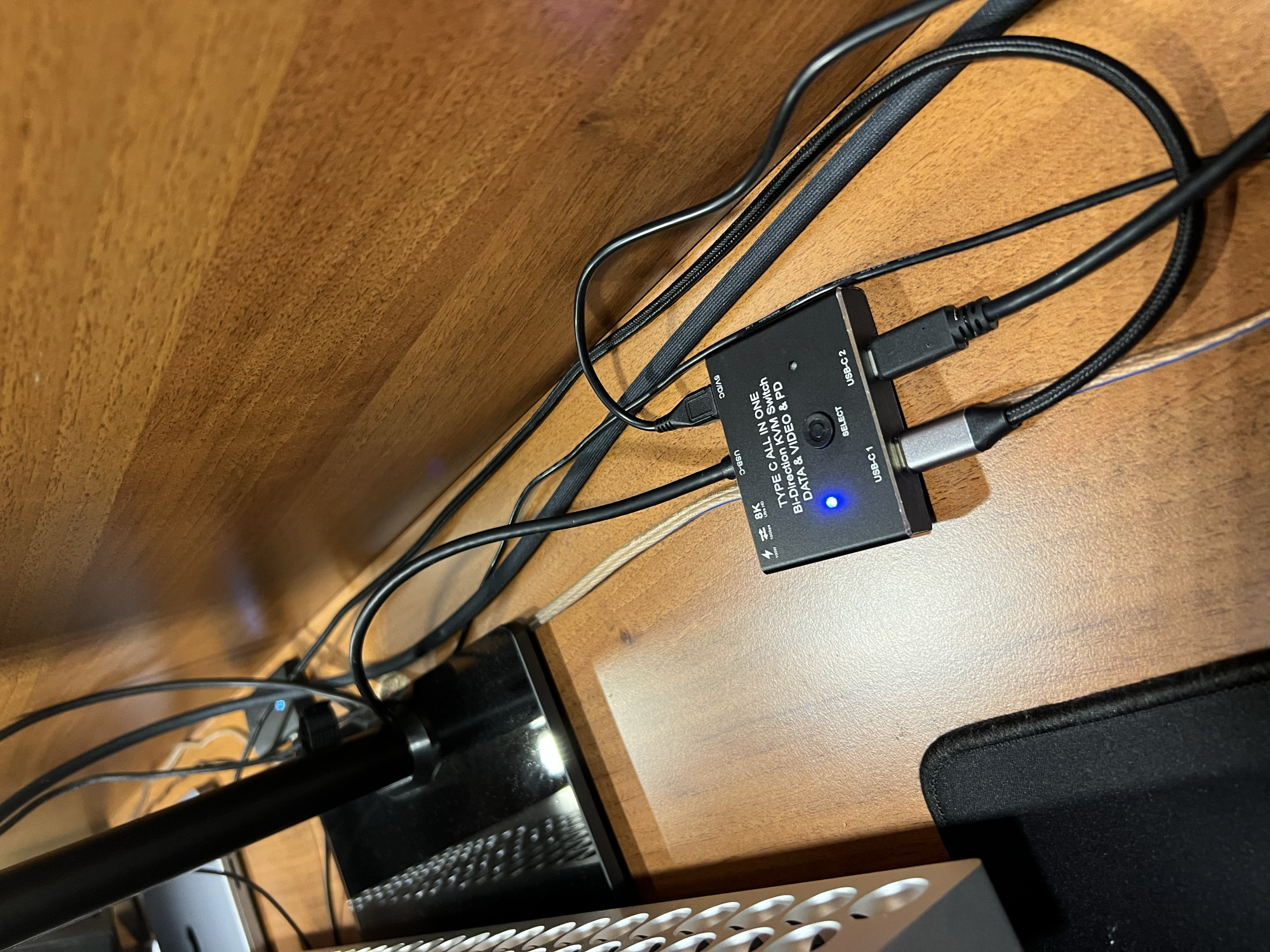

I'm waiting for arrival of CABLECONN usb-c hub. It doesn't require any fancy cables and USB goes just through USB-C. According to forum member experience, that's the best value for money (48 USD for my country, but you can try to find the same looking, but cheaper from other brands), btw it's not a TB hub.
The only two things I'd wish in it: audio jack and detachable main cable. And maybe remote button.
Please share your detailed findings when you get this. Also, you meant CABLEDECONN, right? This one?
Can you link out to testimony about this kvm working as you’ve described.
Yep, this one. I tried to find it on international amazon, but it was not there.
You can find testimonies even here on Macrumors or here (search for XDR): <snip>…

I've got it today and tried with my M1 MBP and Intel PC. Both work perfectly with this KVM, XDR works at full 6K@60 8-12 bit + HDR, brightness is controllable in both Windows and Mac.
LEDs of KVM are too bright though and this micro usb plug is annoying...

KVM is used just for easy switch between two computers without re-plugging everything. The flaw here could be data transmission speed - only USB 2.0 480 Mbps on PC and not quite clear 20 Gbps (according to the system report, although the used cable supports only 10) on Mac.
KVM won't help you to connect XDR to PC if you don't have USB-C + DisplayPort Alt Mode output from it. There're other options to achieve this, like your WJESOG cable or previously mentioned Belkin VR Cable, Moshi Bi-directional DP to USB-C (doesn't support data transmission though), Wacom Link Plus adapter, Sunix UPD2018 (or similar Dell) PCI-E to USB-C card and the cleanest option is just a video card with USB-C port (RTX 2xxx series or AMD RX 6xxx, RX 7xxx). All these options imply working in USB-C Alt Mode, not TB, so that could be not acceptable if you need to connect more XDR-s through daisy-chain or any TB devices to XDR.
It'd probably work in TB mode and you'd get 5K@60 max.
