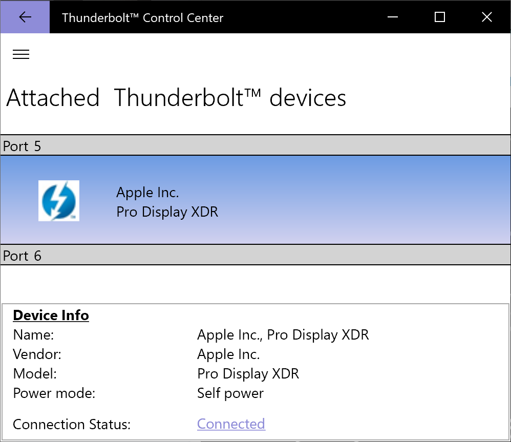

I'm using a Pro Art X670E, which has a JHL 8540 Maple Ridge controller. Using the iGPU, the TB4 port works at full 6k60 at 10bpc with true Thunderbolt speeds (AFAIK). However, when I provide the DP-IN pass through from the RTX 4090 to the Motherboard, the screen goes black. I've Chrome Remote Desktop'ed into the PC when the screen is black, and the Display is connected at 6k60...but with 6bpc, which I don't think the Pro XDR Display supports (maybe that's why the screen is black).
Any suggestions?
In the mean time, I've been using Windows's feature of setting the dGPU on a per-app basis. However, the 7950x's iGPU is pretty weak -- even default animations in Windows 11 are laggy, and there's no way to have the dGPU run the desktop (I've tried).
I suppose it works in USB-C Alt Mode instead of TB, but only with iGPU in your case.
Using DP-IN should work at 5K@10bpc + HDR at least. In my case it does not allow dual HBR3 or DSC :(
Really, the XDR should be able to just connect with a Thunderbolt cable to your motherboard's Thunderbolt port. Did you try a normal USB-C (non-Thunderbolt) cable? It would allow Thunderbolt 2 speed of 20 Gbps which is still enough for 6K60 10bpc with DSC. If Thunderbolt 3 is a problem, then maybe so would Thunderbolt 2, except with Thunderbolt 2 there is no possibility of a dual HBR3 connection. Or it may connect as DisplayPort Alt Mode with USB 2.0 like the Belkin cable.
Mine Z590 Vision with TB4 (the same JHL8540) controller and single DP-IN does not allow DSC through it, so 5K@12bpc + HDR is the maximum resolution available. I couldn't get 6K through TB. Only various DP+USB-C options I tried and all these work at 6K60 (with DSC, obviously) and USB 2.0:

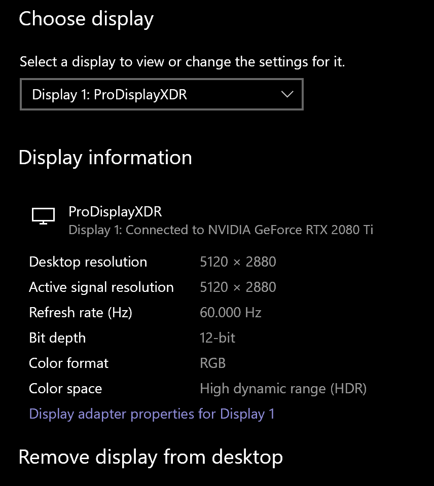

Nope, I get up to 5K60 12bpc (also 8 and 10) + HDR:
I use TB cable in this case. Unfortunately I get no boot screen.
Must be using DSC with single HBR2 connection. Windows doesn't tell you when it is using DSC. You need something that will examine the DPCD of the DisplayPort connection. Maybe try looking at the Advanced tab of GPU-Z.
