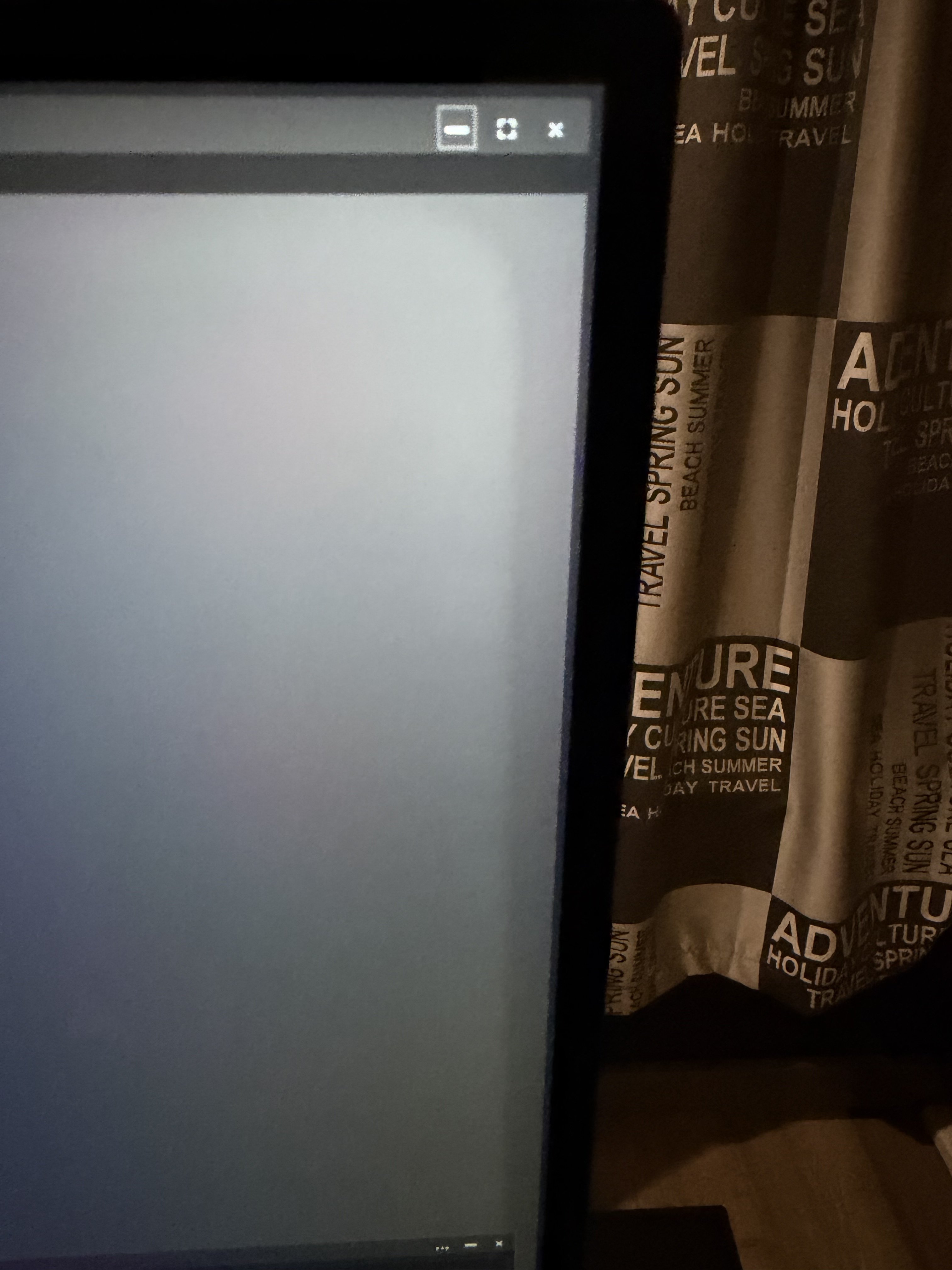

My Pro Display XDR was perfectly fine, but after 2 years it is acting up. I have a very strange grey bleed on the right edges. Luckily, I have Apple Care+. So we will see if Apple still has inventory to replace it, as this doesn’t seem to be right.
  • Sad
Reactions: shurcooL and etc
Looking on this particular picture is hard to tell if it’s the case, but the Pro Display have this weird “defect” around the edges, that can be noticed very well in grey/white background. If this right side edge is not on the same level of uniformity of the others, definitely it’s a defect.
Update: the APR doomed the Pro Display XDR indeed as a defect. Now the issue: Apple has no way to exchange it with a new one. There are no more components our new Pro Displays. Apple Ireland offered me a Studio Display XDR and I would lose almost 2000 EUR on the new price. I refused. In The Netherlands we have a ‘consumer expectation law’. I paid 5000 EUR for a device that broke within 3 years. As a consumer, I can expect better than that. The Pro Display now is back and will go to the APR I bought it from. They will run some tests again and I could go for an alternative or ask to revert the transaction (which I will do). In that case, I should get back the 5000 EUR I paid for it.
