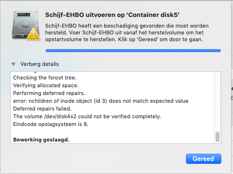

See, this is where mr. Macguru9999 comes in, in that if something is wrong I "need to troubleshoot properly." He is absolutely right but I'm not qualified to do so as I know too little of these hardware matters.

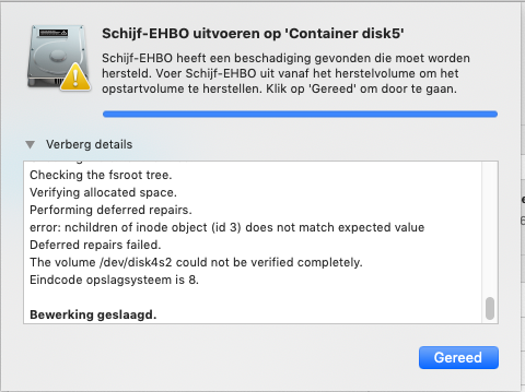

However, reading what you said about a faulty HDD, I decided to run Disk Utility on the Start-up SSD (with Mojave). I first ran it on the top level, so the SSD itself. That was all alright. But when I ran it on the Container disk it said there is something wrong that needs to be repaired. Here's the message. Of course I have no idea what "nchildren of inode object" means. It ends with some Dutch, saying the "endcode file system is 8". And the drive is again activated. Could whatever this is have any relevance to what we've been discussing?

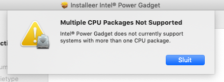

are the processors running at the correct speed ? there is a utility called intel power gadget you can use to test. If they are then really you need to try a different GPU. I used a radeon rx480 , a flashed one , and its excellent. you could always buy another gpu and then sell one of them later ....
That's the plan now, buying another GPU and sell the Asus card that I'm using now. I'm looking for a new card. One that is affordable...
I downloaded Intel Power Gadget but it won't install. This is the message I get when double clicking the installer.

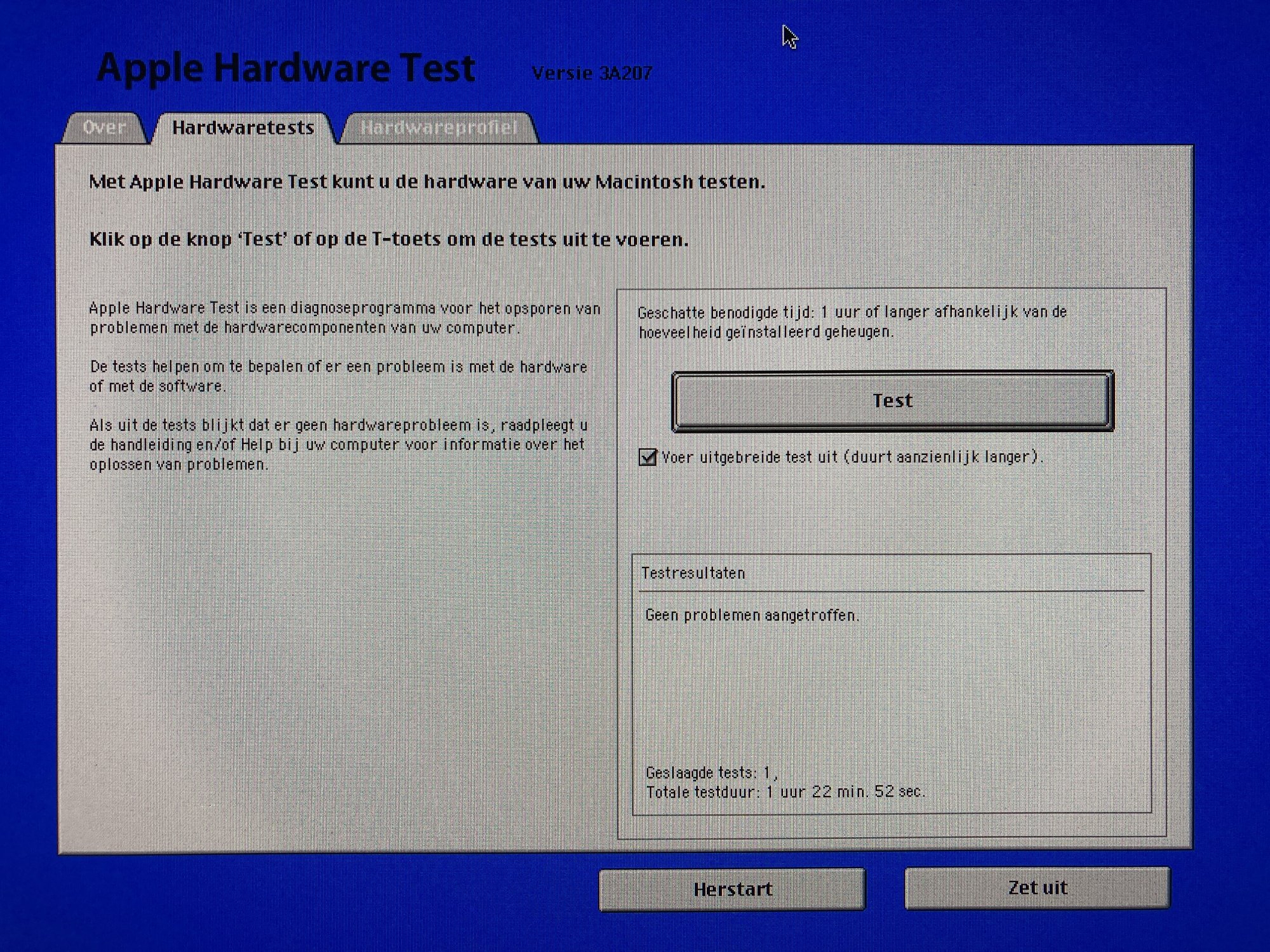

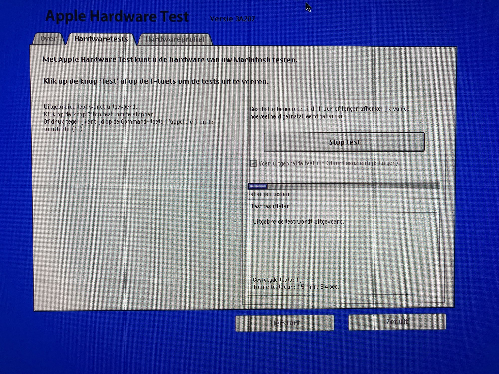

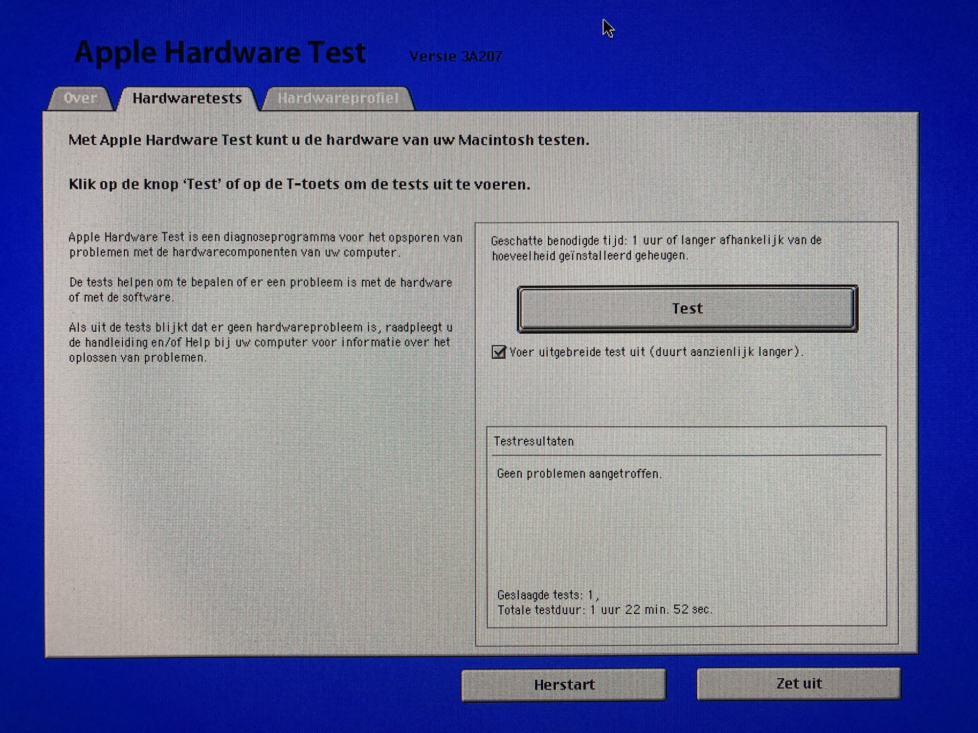

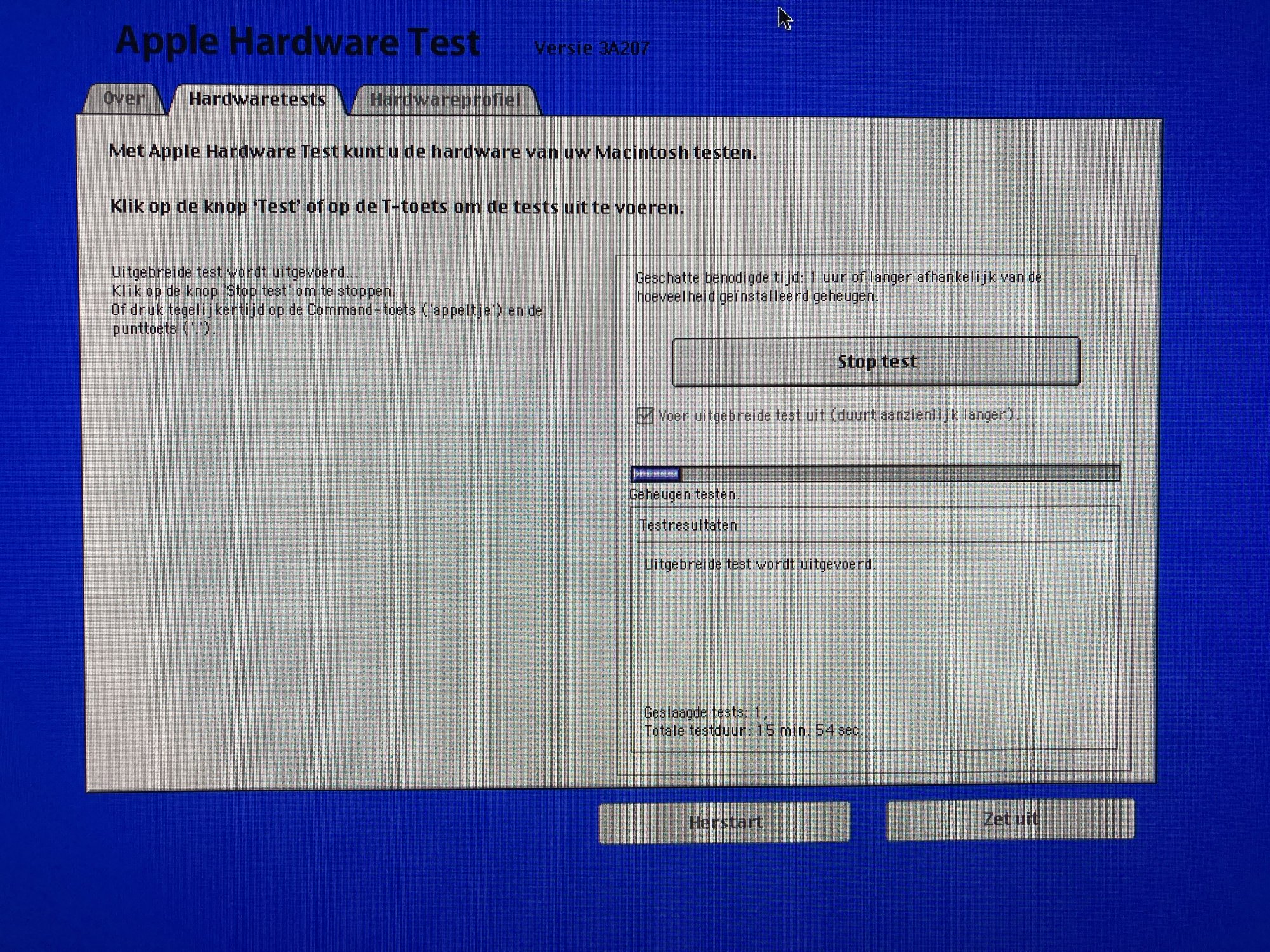

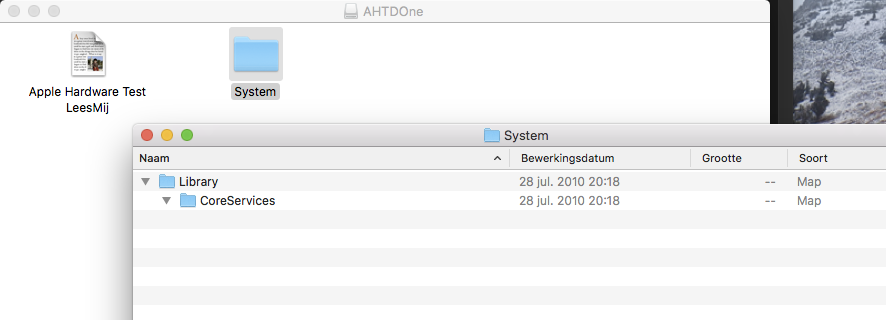

Okay, I followed instructions, prepared a USB stick in Terminal, downloaded the AHT (for 5,1) from github, mounted it, copied it to the USB stick and am about to make it bootable in Terminal. But before I do that I want to check that the disk image contains a Read Me file that can't be opened and the folders are empty. Is this correct? Schermafbeelding 2023-04-01 om 17.37.13.png

Okay, I followed instructions, prepared a USB stick in Terminal, downloaded the AHT (for 5,1) from github, mounted it, copied it to the USB stick and am about to make it bootable in Terminal. But before I do that I want to check that the disk image contains a Read Me file that can't be opened and the folders are empty. Is this correct? View attachment 2182595
Yes, just boot it now.

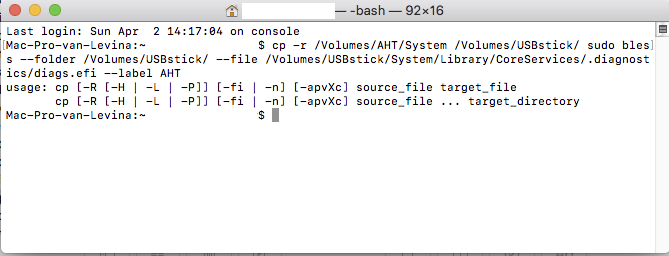

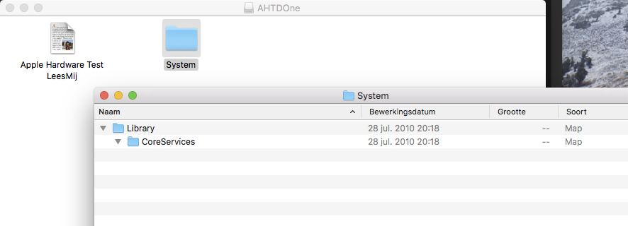

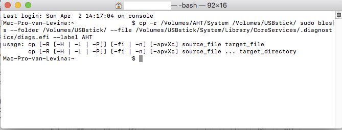

I did try the D and option-D method first. Just to make sure the easy way didn't work. And it didn't. So I blessed the cursed USBstick, did a cold reboot whilst holding down the option key and the AHT wasn't there.
Here's Terminal after entering the command line (a copy and paste from github of course).
You are mixing two separate lines in one, this is the first line:
Code:
cp -r /Volumes/AHT/System /Volumes/USBstick/
This is the second line:
Code:
sudo bless --folder /Volumes/USBstick/ --file /Volumes/USBstick/System/Library/CoreServices/.diagnostics/diags.efi --label AHT
You have to correct the path names, if you used anything else than USBstick.
I tried it in every way I could think of (one long line, two separate lines, using brackets) and it didn’t work. most of the time it said ”no such directory” and/or “ignoring.” Then I realised that the disk image was not labelled “AHT” but “AHTDOne”, so the command line needed adjusting. Changing the name made it work and the test is now running. Could take a while. Very handy to have the AHT tool now.

Well, the story goes on...
After the above, I purchased and installed the Aqua kryo M.2 adapter with a Samsung 970 EVO Plus 2TB. Did a clean install of High Sierra. Put my stuff on it. All works wonderfully well and Blackmagic Speed test tells me the Mac is now 3 times faster in reading/writing speed. I'm very happy with this.
Then I thought, why not try that Asus Radeon RX 560 4GB again so I took out the GT120 and installed the Asus. And much to my surprise it now works flawlessly! I mean, no stuttering of any kind in games, no spinning balls in Photoshop and not even stuttering audio.
How is this possible?
