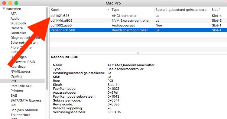

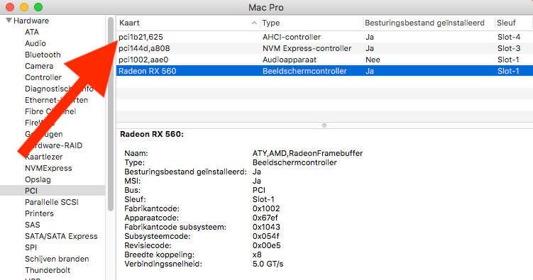

Can you make the same screenshot like before of the PCI device?

Kinda weird it is running at x8 rather than x16 Bandwidth in slot 1?

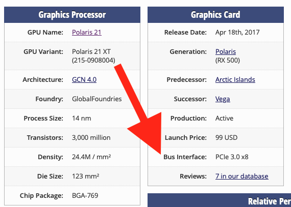

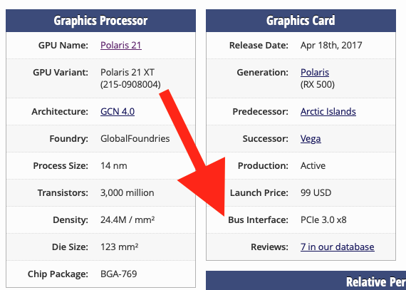

Weird why? AMD RX 560 is a PCIe v3.0 x8 card.

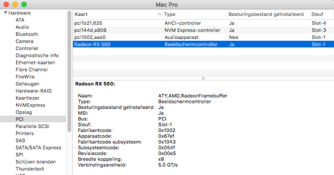

Reactions: h9826790
But isn't PCIE3.0 x8 equal to the same bandwidth as PCIE 2.0 x16?
What the bandwidth have to do with physical PCIe lanes? A RX 560 only have 8 PCIe lanes, System Information is showing the number of lanes the PCIe card is actually connected to, not the bandwidth.
Reactions: startergo
I have seen before RX-580 reporting 8 lanes there (because it was malfunctioning), but yes if this is an 8 lane card then it is fine.

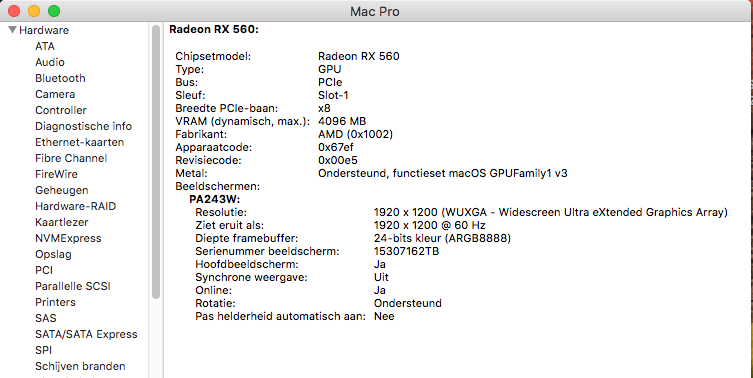

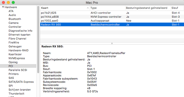

Also, what model PCIe card do you have installed in slot-4? Looking at the PCIe ID is an ASMedia ASM1062 SATA controller. Is a Sonnet Tempo SSD? Pro Plus?

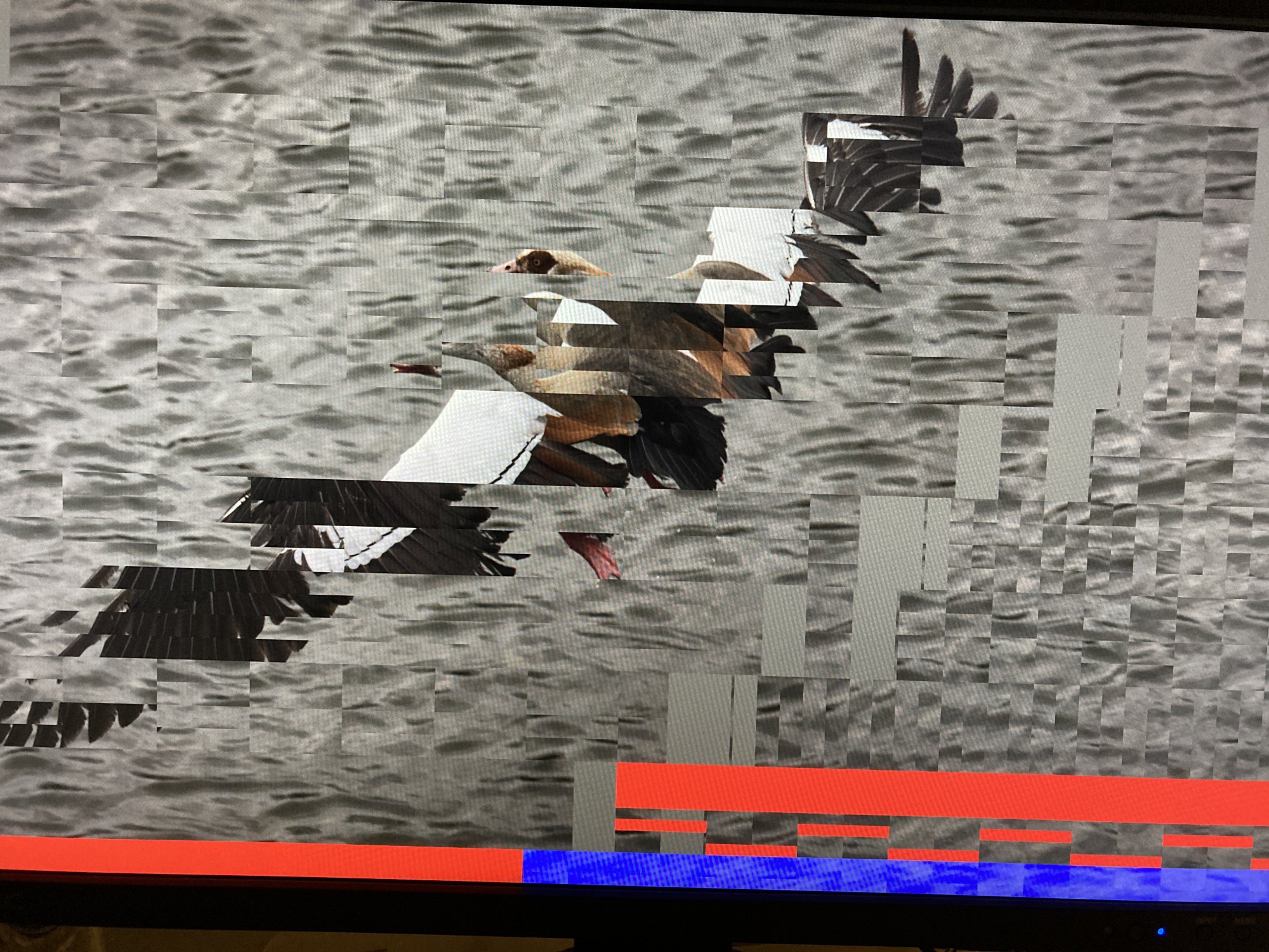

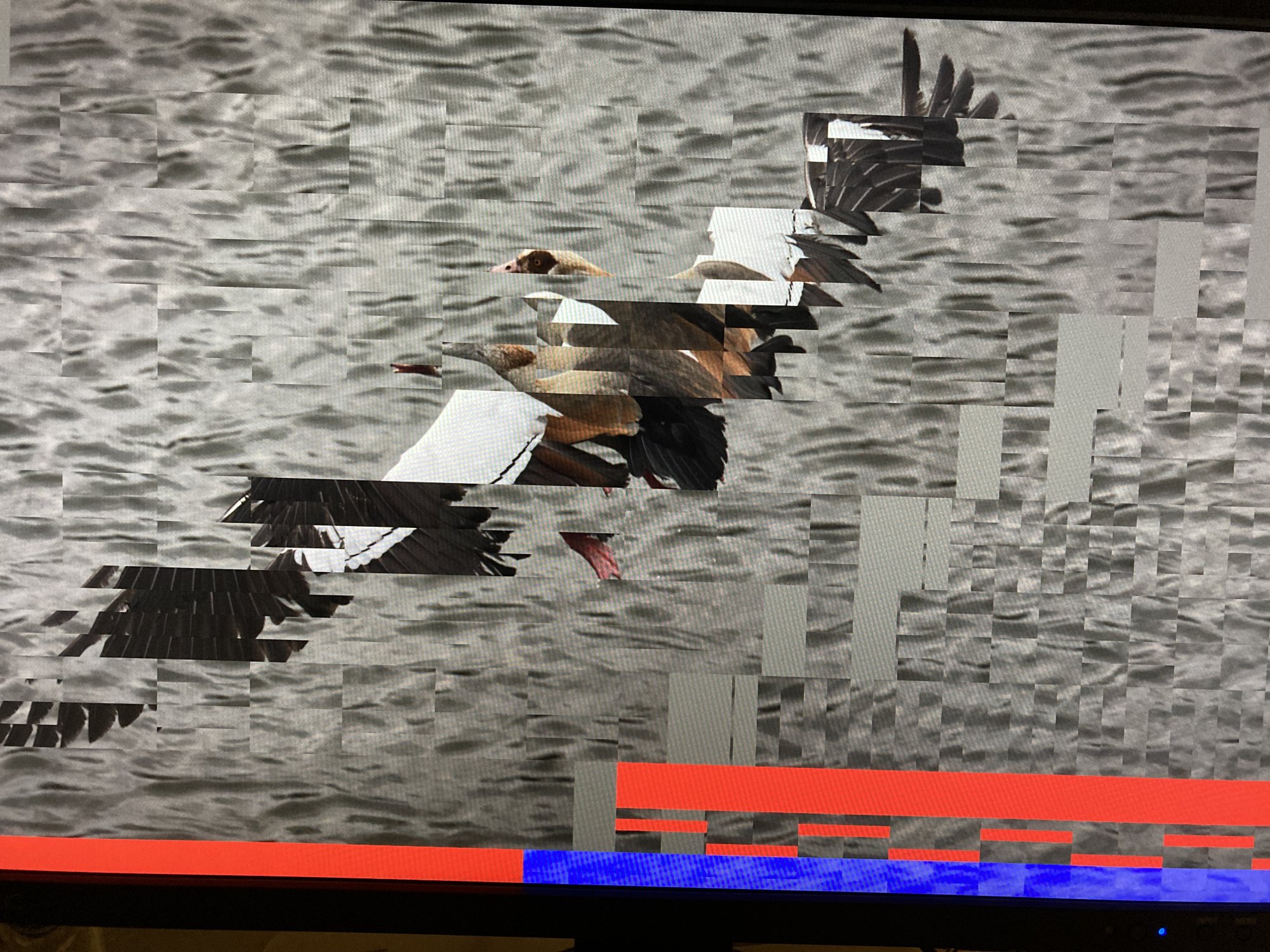

A last update. The card started playing up again. Lightroom and Photoshop worked well, but it turned out I couldn't use Adobe Bridge and I could play some games but not others because of the screen just glitching and being totally distorted. I took a pic of that with my iPhone as it doesn't get recorded in screenshots. It's the same glitching I mentioned earlier on in the thread. It looks the same in some of my games.
So I found a Sapphire Pulse RX 580 8GB for 90 dollars and it does seem the card to get. I've installed it and tested everything that wouldn't work with the Asus RX 560 card and everything just works as it should. Temps look good too.
I thought I would report this here as a warning that maybe that particular card is not such a good idea? Unless it was just a faulty card.
yup certainly looks like a faulty card. I have an MSI RX 460 and no issues with it with those Apps.
