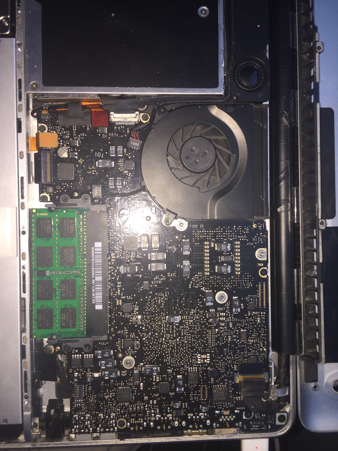

Sounds like you are getting the MacBook to sleep.
But, doesn't wake up properly.
I think you need to check that the _connector_ for the SIL is properly connected. If you take the bottom cover off, the SIL connector is a tiny connector on the corner of the logic board nearest to the hard drive.
I also agree about the suggestion to try booting to another OS X system.
I'll try to open it today and see if it's connected.

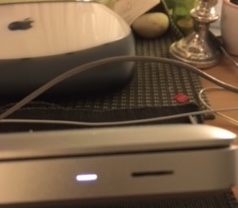

Thanks Bob. Already did a install of SL (only disk I had). Still not sleeping when I close the lid, or when I sleep it from the menu. Pretty sure by now it's probably hardware. Gonna see if the SIL is connected.
Gamer9430
macrumors 68020
Apr 22, 2014
2,248
1,402
USA
Also, @KDS7999, don't forget the the screen light doesn't turn off either. My thinking is that something happened to the sleep magnet...

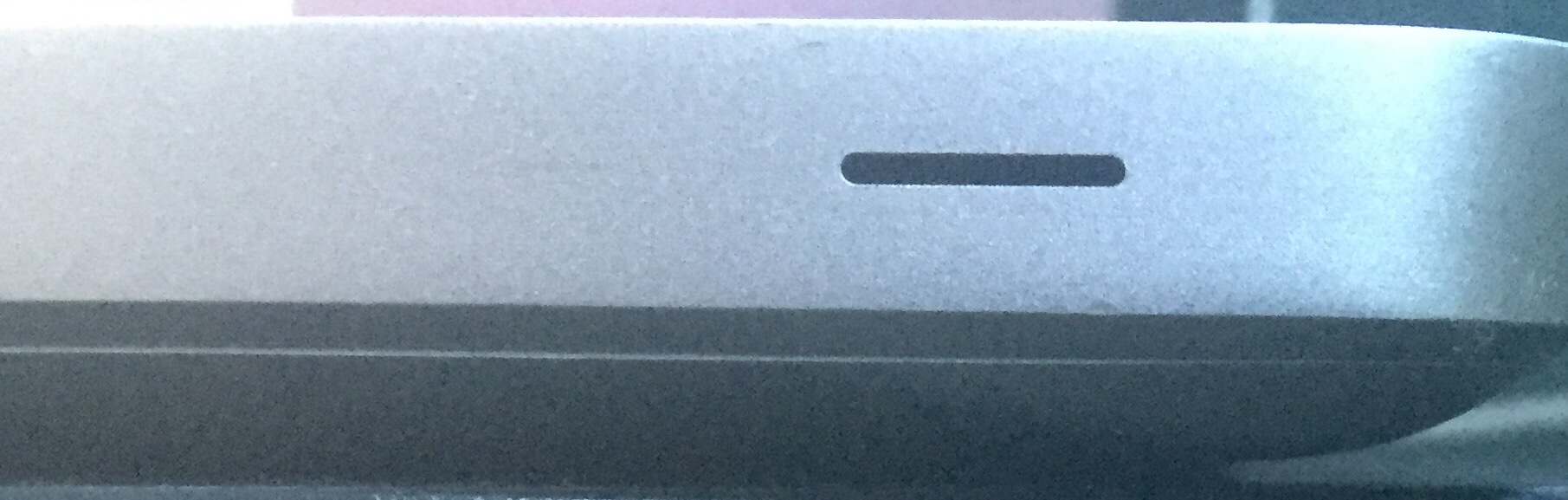

Where do I find the SIL on the MB2008?
I know that light from using iBookG4, iMacG5 and intel-iMac white, but I don't know any equivalent on the MB2008alu (5.1).
Gamer9430
macrumors 68020
Apr 22, 2014
2,248
1,402
USA
On every MacBook with that case design, it's a row of LEDs that pulse on the left side of the IR receiver... It's virtually not noticeable unless it's lit up.
KDS7999
macrumors newbie
Nov 19, 2015
16
2
USA
It's on the right side of the MB.
