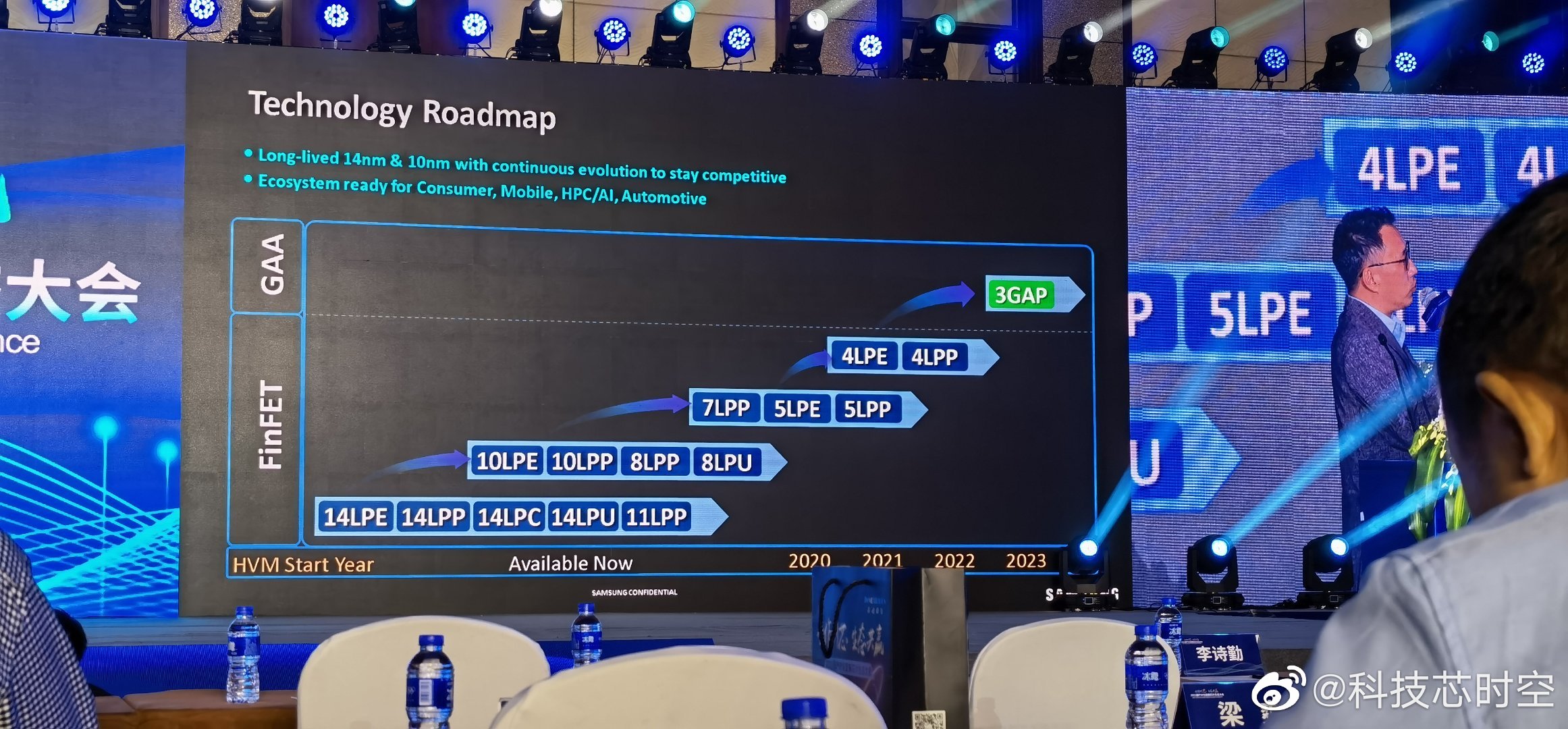

I'm not sure Qualcomm is 100% "sold" on GAA 3nm. Qualcomm was one of the early folks who signed up with Intel 20A-18A. Qualcomm has lots of products so perhaps they are 'dipping their toe" with a minor future product with that move, but they are trying out options for the long term.
Qualcomm's 8cx Gen 3 is on "Samsung 5nm". The next incremental move would be "Samsung 4LPP" not 3. Circa mid-2021 'public' roadmap.
"...On its FinFET technologies, both 5LPP and 4LPP nodes are new to the roadmap, and set for high-volume manufacturing (HVM) in 2021 and 2022, respectively. ..."
The "arrow transition" from 5LPE to 4LPE in chart above.
The fact that 3GAE "early" dissappeared from the roadmap probably has nobody beating the farm on 3GAA. Samsung is probably going to chew its own dogfood for all of 2023 before anyone with large volumes might jump on it 2024. ( probably will get some smaller volume players though in 2023).
If 4LPP is suppose to be high volume in 2022 then Qualcomm sampling in mid 2022 and going volume in 2023 would make sense. And if they "moved" Nuvia from TSMC to Samsung because the rest of the SoC was already committed. If they basically upgrading the 8cx Gen 3 with Nuvia cores and evolving the DSP/AL-ML/GPU/etc then there could be enough inertia to make that happen.

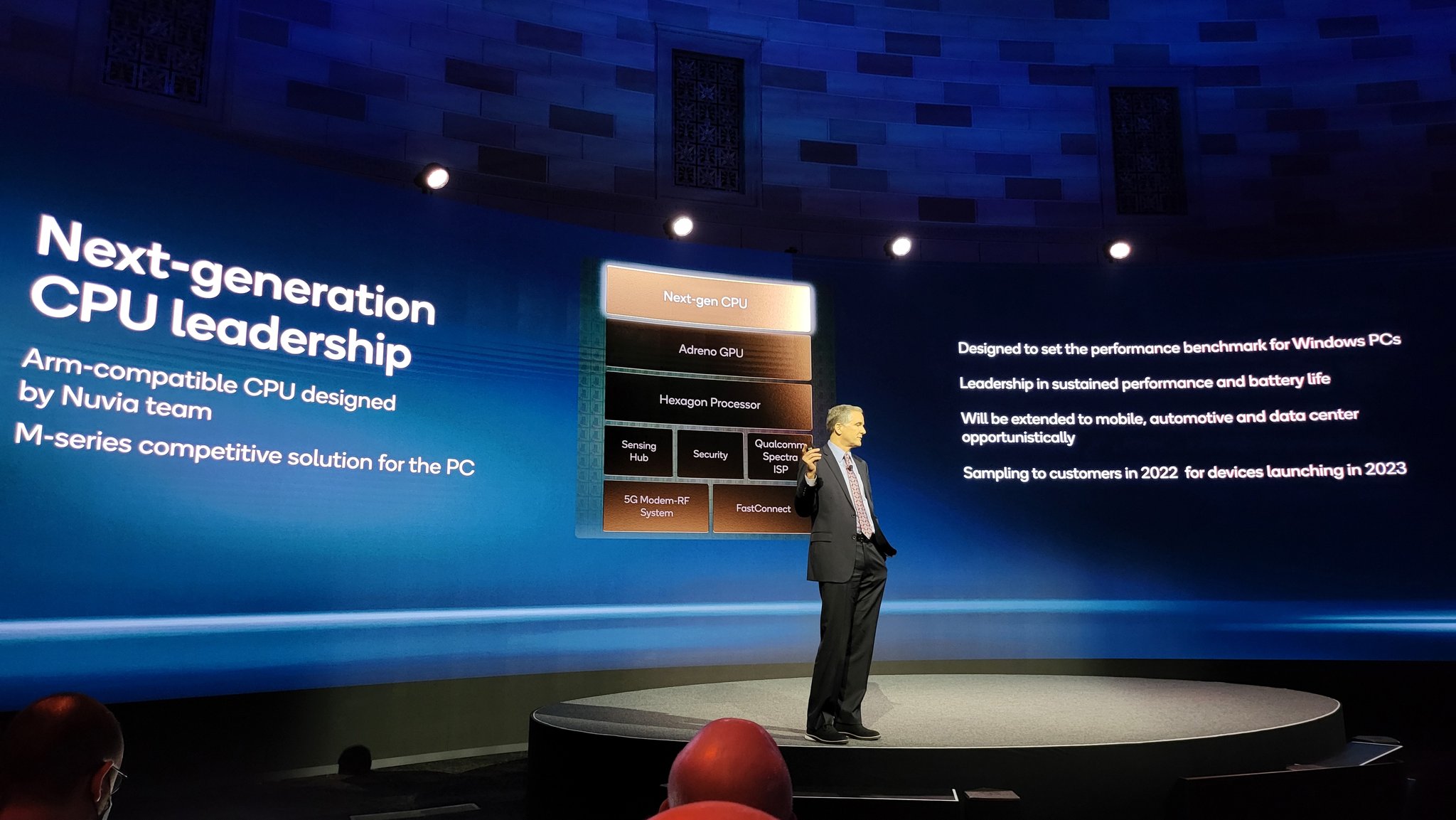

Second, the article has a snapshot from the Qualcomm Tech presentation weaved into it:
But we don’t really know what that means and what other accelerators (we know Qualcomm has a bunch of its own) it’ll ship with.
The major SoC component parts are all there. The likelihood that the Nuvia team is contributing a Adreno GPU , a Hexagon Process , Security ( Microsoft Pluton) , Qualcomm ISP , 5G Modem , etc. is really , really small. It is an ex-Apple team. They aren't coming with a stack of Qualcomm stuff.
On the left there is phrase "M-series competitive solution for the PC". So nothing major new in this interview. On the right "set the performance benchmark for Windows PCs". If Qualcomm is really trying to be a well rounded competitive Windows SoC solution they'll need to step-up their GPU cores along with the CPU cores. The ex-Nuvia folks aren't going to contribute much there.
Does the CPU have to share bandwidth the GPU and Hexagon? Yes. Could there be need from more memory channels to handle the increased workload? Yes. Are GPU folks going to allow the memory subsystem they have based their design on be thrown out the window so something new? That's somewhat suspect. [ Apple delegates a fixed subset of bandwidth to their CPU cores as not to impede the GPU . ]
That side deck is suggestive that back in 2019-2020 that "Next Gen CPU" box would have been tagged for "X2 + A710" and that this is acquisition is a substitution in a SoC they already have roadmapped.
Third. The actual question and answer
IC: If you can perhaps clear something up for me: is the Nuvia team making a single core, or both a big core or a little core? Or is it that they’re dealing fully with the SoC structure into which you add in the connectivity and the graphics?
AK: It’s both, all the above. By that I mean that it's impossible for us to put out a chipset solution as sophisticated as this without having the entire system being taken into consideration. Think of it this way: the CPU by itself is part of the ‘one technology roadmap’, but so is graphics, and other things. Then we're really thinking about bringing a complete system solution to the PC and changing it in such a way that you don't go after the traditional designs. ... "
That initial fragment replay of "all of the above" doesn't make it a "Nuvia" SoC. The CPU is "only part of the" roadmap; not the defining element. As a "complete solution" there has to be an effort put into making the CPU well integrated into the overall system solution; but the CPU cores are not the solution.
Qualcomm only announced they were acquiring Nuvia in January 2021. Technically that didn't close until March 2021. This SoC is suppose to sample in mid-2022. So basically had/have a year to make this work. Doing a new SoC takes multiple years to do. So it is pretty likely some compromises are being leverage to wedge Nuvia's stuff into a SoC baseline design that was already in progress when they acquired them. Where the 'old' CPU cores were a modular element of the design, they'll fit this alternative modular set in.
Will it be a bigger die size than they initially targeted if Nuvia (like Apple) is leaning on bigger than Arm "normal" L1/L2/L3 caches? Probably. I don't think that baseline was frozen in stone, but where floorplan , power , and/or thermals could be straightforwardly extended there are likely some shifts being done. more performance and bandwidth isn't going to come for free. That's said, it is doubtful they are throwing it all out and starting over with some "ink not dry on their badges" team driving all the major design calls.
The CPU cores probably will come out to be less than 40% of the overall SoC die space. (decent chance down closer to 30%). It isn't going to be most of what is there. So naming the whole SoC after "Nuvia" is a pretty big stretch.
