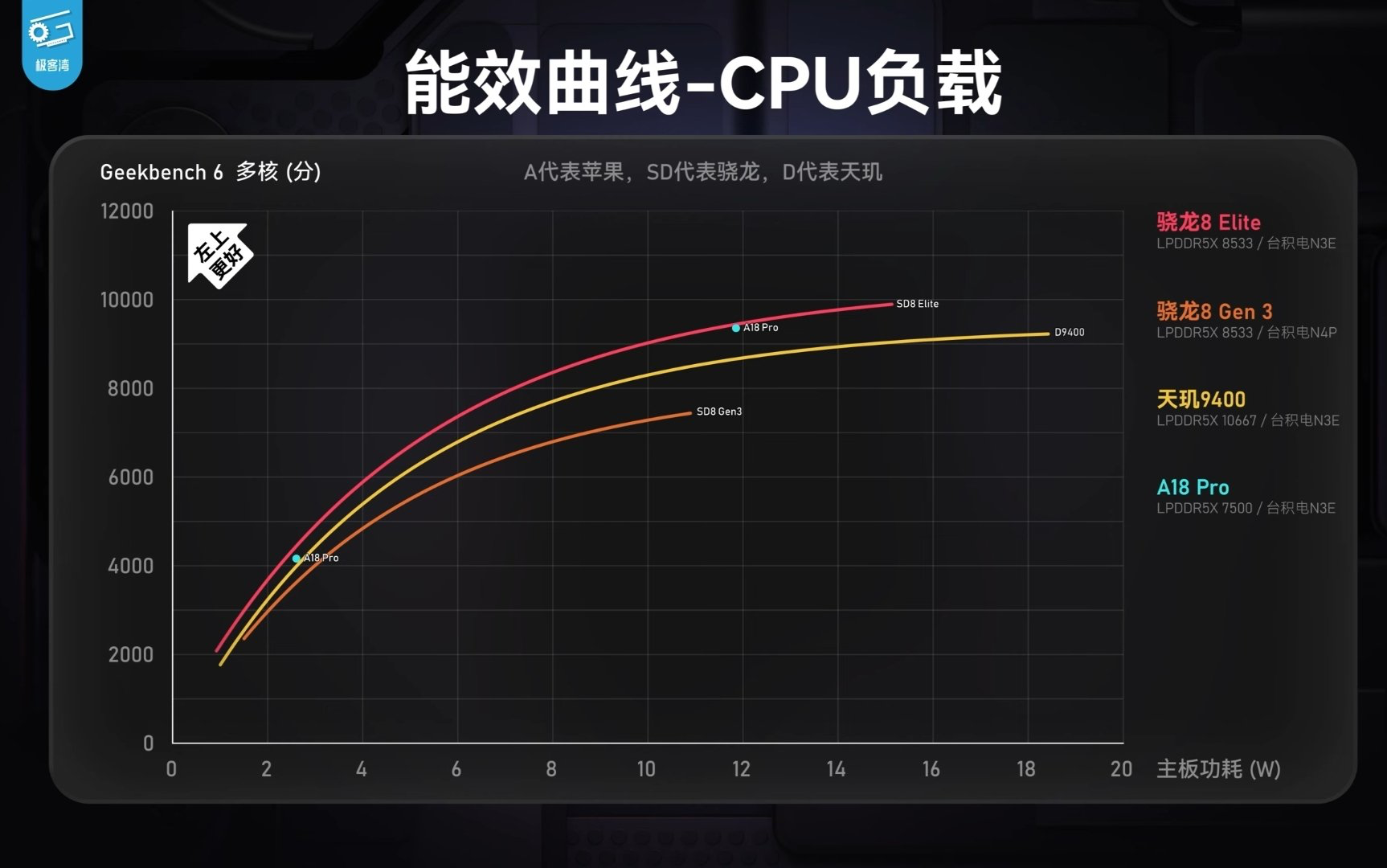

It’s 10% slower per core than A18 despite 7% higher clock. How does it make Apple look like last gen tech?
It doesn't.
The key question is: does it accomplish its higher multi-core score at similar thermals as A18 Pro? Its higher clock and higher core count suggest that it draws more power.
from the technology standpoint I don’t find Elite 8 very impressive compared to the state of the art. [..] Of course, compared to Intel/AMD these cores are very impressive indeed.
I mean, that's basically the three contenders, right? AMD isn't even playing in the efficiency game, Intel's Lunar Lake is about a generation and a half behind Apple, and Snapdragon may be slightly closer.
And Apple's design — M4 / A18 — is only half a year old, so they perhaps aren't that far ahead internally.

S8E beats the A18 pro in efficiency since it’s using a more refined N3E node from the experience TSMC gained from fabbing A18 pro.
So much for “Apple design” nonsense that fans were barking about. I told you all, chip design is intellectually child’s play and unimportant. The fabrication method is harder and important.
I’m not giving props to QC, since this is all due to TSMC. QC and Apple deserve none of the praise for the chips TSMC fabs.

Qualcomm has more cores, which means it can operate on lower frequency at the same wattage. You are ignoring the basics of computing and completely misconstruing reality.
What I find more interesting is that despite the core count advantage Elite 8 needs 40% more power to gain a 12% multicore performance lead on Apple. That does not look good for Qualcomm.
This is uneducated spiel. The PPW curve looks like a lognormal curve no matter what the node or design is. At a particular point, you tradeoff in power and performance flips where you need disproportionately more power to gain slightly more performance. Apple would have the same “problem” if they allowed higher power (Software limitation).
This inflection pt is set by the node, not the “design”.

Apple M3 (and all the other M chips) has both P and E cores. E cores have roughly 1/3 the performance of the P cores, and yet they are made on the same process. That alone is enough to prove that your statement is a giant steaming pile of BS - here we have two cores on the same process with drastically different performance and efficiency. But let's look a little more, comparing two different designs from two different companies.
Intel Lunar Lake compute tile is TSMC N3. So is Apple M3. HIQP would have us believe that the N3B process used for Lunar Lake is "more refined" because it's newer (it's not, actually - improvements made in a single process are continuous, and applied to all chips being made with that process). But if he were right, then that would just give an advantage to the Intel chip.
The Core 9 288V has a nominal maximum clock of 5.1GHz, which it may actually attain during a GB6 SC run. The Apple M3 has a nominal max clock of 4.05GHz, which it will also likely reach during an SC run.
Apple M3P cores score around 3100, according to the GB site. Dividing by 4.05GHz, you get about 765 points per GHz, which gives you a sort of rough idea about IPC. According to notebookcheck, the 288V scores about 2900. (The GB site shows many scores, mostly ranging from 2400-2800, but let's give it the benefit of the doubt.) Dividing by the nominal 5.1GHz boost clock, you get a bit under 570 points per GHz.
So that's pretty much all you need to know - ON THE SAME EXACT PROCESS running at lower clocks, the M3 scores better than the Lunar Lake. CPU design matters.
But of course, that's not really the whole story - there's more. POWER EFFICIENCY is a very big deal, for a lot of reasons, but maybe most obviously because if you're trying to run multiple cores, then you can run more of them faster without melting them. The M3 P core is significantly more efficient than the Lunar lake core. I'm too lazy right now to fish out those numbers, but feel free to do the homework yourself, or perhaps someone here can supply them.
The shape of the curve is one thing. The parameters of the curve is something else entirely. Different number of cores, different voltage, different chip design — all these things factor in, and this is what you are blatantly ignoring.
Also, you seem to confuse logarithmic and log-normal. So much to "uneducated spiel". Please keep in mind that you are talking to practicing statisticians and industry experts here. I don't know what your degree is in, but it is certainly not stats or IC design.
