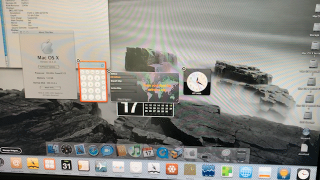

Core Image Ripple effect.. with G3 cpu in Tiger.
Tried to run Open Mark benchmark, but it bombs on start, guessing it needs G4?

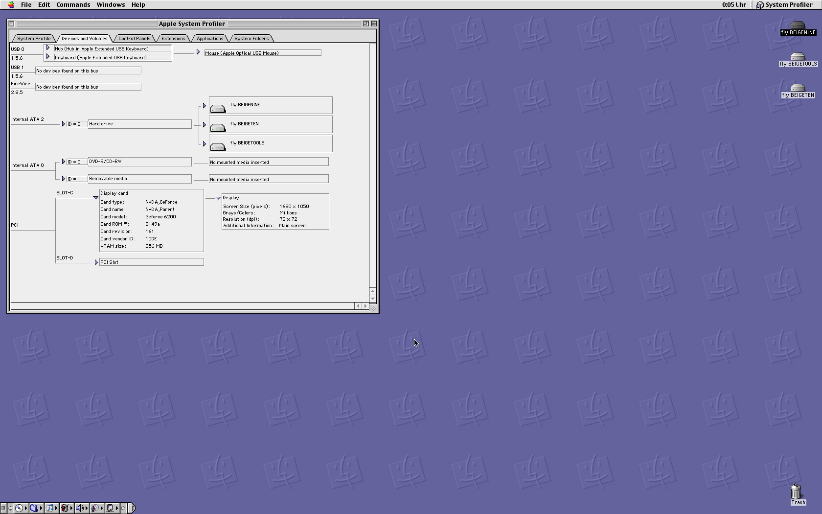

In my case OS 9 boots just fine with the 6200 installed. The card is even seen by System Profiler as it appears under Tiger's System Info. I just don't get no signaling to the display from it.
Thanks to Open Firmware 2.4 for having all the fcode names, and dingusppc for being able to use Open Firmware 2.4 and @flyproductions for getting the info and testing.

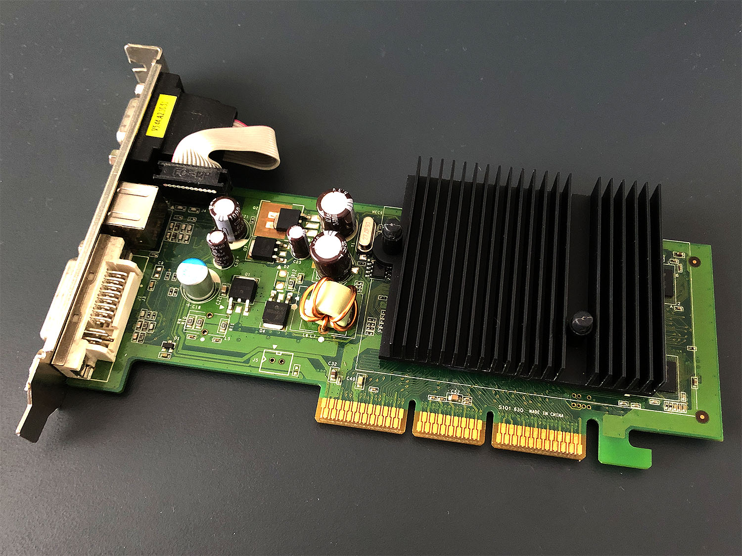

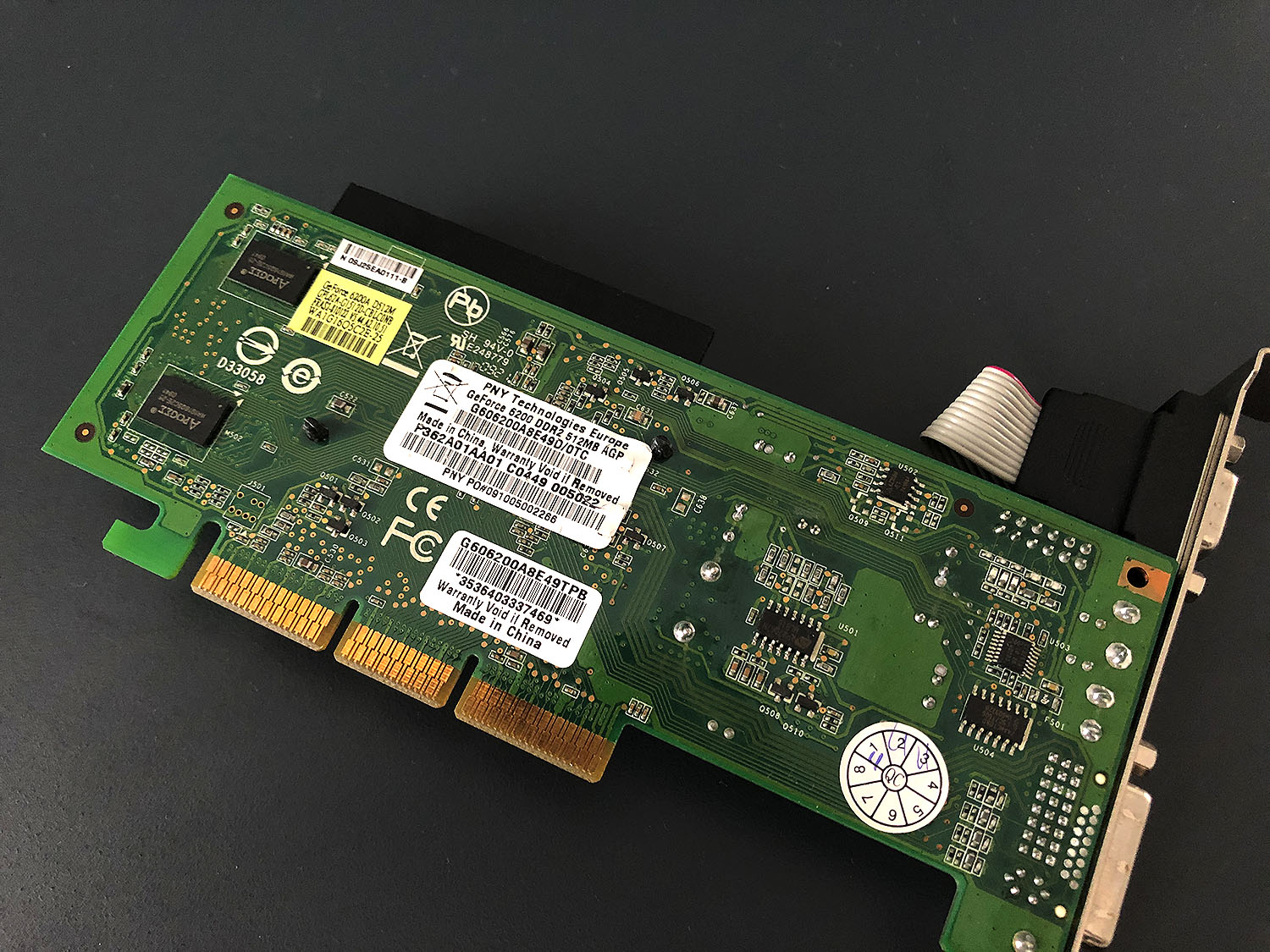

i didn't even know that i still have the card. But found it in a forgotten stack in the basement.
It's also PNY, but has a pcb very similar to some Club 3D which is 256MB. So with the Club 3D's ROM it worked just fine. 256MB, of course. But i spend alot of time, trying to get it to work with all the 512MB, comparing to the PC ROM or adapting things from the experiments with the Gainward Bliss. I got to the point where it showed 512MB after a safe boot, but never got it to fully boot to the OS with one of these ROMs.

I noted the CI says it is supported, but I don't get the ripple effect in the Dashboard, does that work on your PCI 6200?
QE seems to work fine tho.

It depends if OS 9 continues to boot on these Old World Macs with the 6200 installed, if booting just hangs when loading the Old World ROM, before it scans the Extensions folder for 'NDRV's it won't work tho.
Mine has been booting just fine in OS 9, with the ATI card in there as well. I've also been booting the machine with only the 6200 in it (removed the ATI entirely), to OSX 10.4.11
I could try a screen mirroring or OF test, to see what happens its set to boot OS 9.
Did a quick benchmark with xbench 1.3. GeForce 6200 on left, ATI Radeon 9200 on right.
Significant improvement. I'll have to fire up Quake or Unreal and see what kind of fps improvement they get.
