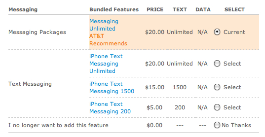

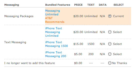

For those not on the Family Unlimited plan, you have to do quite a bit of social engineering to get this to happen to enable MMS 100% of the time. Check out the pic and go look at your account and see the difference.
thats how mine is and mms doesnt work
edit: actually i just went to look again and it was changed back to the iphone messaging!
But I am on the family unlimited plan, and MMS still doesn't work. And what do you mean by social engineering? What do I have to do?
There are daily system sweeps to disable MMS on iPhones that are enabled for MMS. You can re enabled it, but to be honest, after having to re enable mine everyday I got tired of it. I'll wait. I'm sure this is the reason why they do the daily system sweep, eventually people will get tired of enabling it. There is no permanent way to enable MMS. If someones says they do, they are lying. Even if you have family messaging, or messaging unlimited (not iPhone), the system sweeps still know you're using an iPhone and disable your access to MediaNet (which is required for MMS) Go to att.com/mymedianet put in your phone number, using your iPhone and you will get the message that your phone is not supported. The system sweeps change nothing in account account settings, and nothing is changed in snooper either. If you have friends and family that work for Mobility I wouldn't recommend having them make changes in the billing system or snooper. AT&T sent out a warning to employees that MMS on iPhone is not to be enabled for any iPhone. They are risking their job otherwise.
