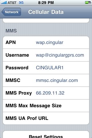

Settings>General>Network>Cellular Data Network
Input the following information in the appropriate fields:
APN: wap.cingular
Username: wap@cingulargprs.com
Password: CINGULAR1
MMSC: mmsc.cingular.com
MMS Proxy: 66.209.11.32
MMS Max Message Size: [leave blank]
MMS UA Prof URL: [leave blank]
Now after that is done, you should be able to Tether and Send MMS. If not then I would suggest checking over the info above and ensuring everything is exactly the same.

i folowed the instructions but it is giving me the red exclamation point
is this right?
This isn't working for me. I put in all the correct info in Network Settings, I also have regular "Messaging 200" as my texting plan, not "iPhone Text Messaging 200." But I just get red !'s.
