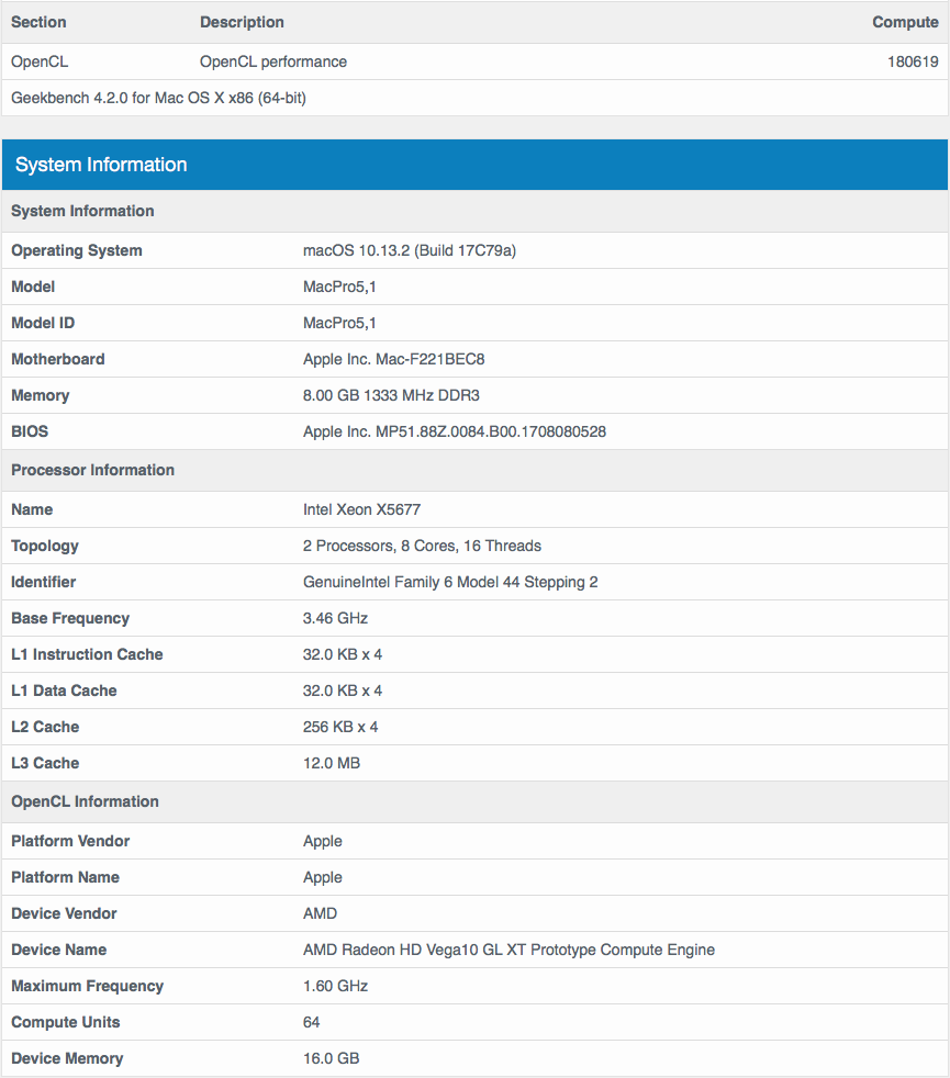

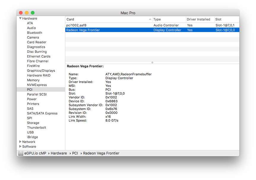

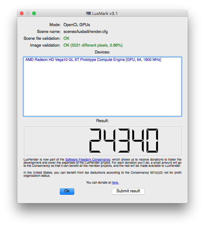

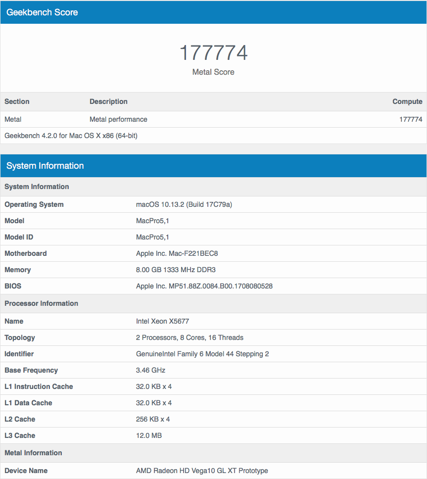

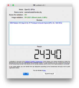

iMac Pro launch is within weeks. The top-end configuration most likely contains an under-clocked iteration of the Vega FE 16GB. I got the air cool version today and it was plug and play in the Mac Pro tower.
This is a beautiful and great build-quality graphics card. It's fully enclosed in brushed aluminum housing, anodized in blue. I'm currently using the two mini-PCIe power booster to run the Radeon Vega FE. This is not recommended due to its high TDP. I'm only testing this briefly as the card will primarily be used for eGPU.
mac-pro-tower-radeon-vega-frontier-edition-about.png mac-pro-tower-radeon-vega-frontier-edition-pcie.png
mac-pro-tower-radeon-vega-frontier-edition-metal.png mac-pro-tower-radeon-vega-frontier-edition-opencl.png mac-pro-tower-radeon-vega-frontier-edition-luxmark.png

What are its scores on CUDA benchmarks?
That's good, and if a Vega 64 can run Luxmark with just the mini 6pin power supply. Then most likely it's good enough for something like video editing.
However, I still doubt if that will draw too much when doing 3D work. Not necessary ridiculous like Furmark, but I suspect even Unigine benchmarks can shut down the Mac. Of course, for eGPU setup, it doesn’t really matter.
[doublepost=1511860750][/doublepost]Anyway, I expect it can do better in Metal compute. May be the driver still not there yet.
Thats cool, what are you going to be using it for?
I'll use it primarily in an eGPU enclosure for testing and reviewing. I wanted to provide Mac Pro tower users an update the card works (needs more juice). Just in case we have the urge to buy an iMac Pro, a Vega Frontier Edition may not be that bad of an option.

Same behavior. I have an RX Vega 56 that I tried with my Mac Pro tower a couple months back. The drivers are getting better but still a work in progress.
Curious if the update today fixes that. I have a Vega 56 waiting in box for the drivers to be cleaned up.
It seems to me like they disabled all the power management in the drivers for some reason. In since the iMac Pro has custom fans, doesn't seem necessary for the iMac Pro to me, and they'll want to support this for eGPU.
So hoping that they just had some issues with the power management and they turned it off for now.
Nvidia under High Sierra is so bad I'd love to be able to swap back to AMD and get some stability again.
