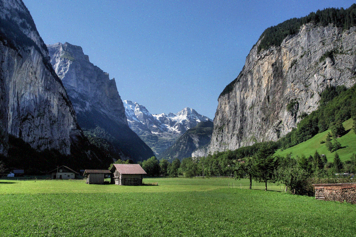

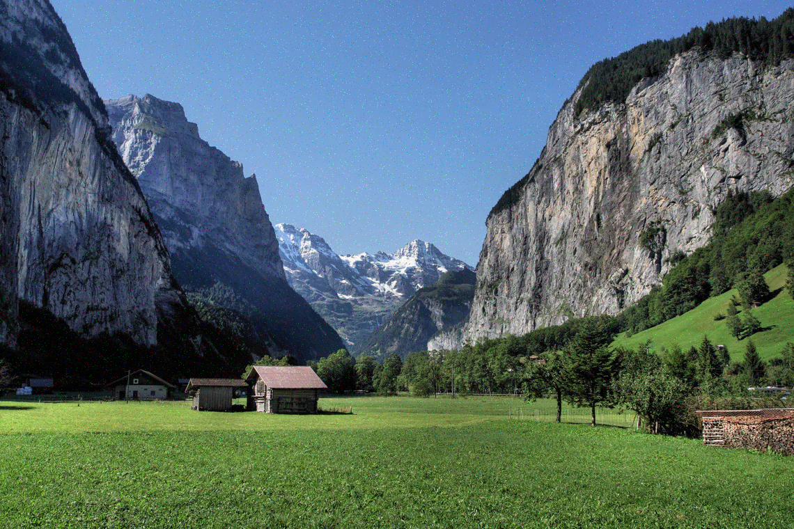

Out of boredom apparently, I wrote a program that flipped bits in an uncompressed image of the sort that's transmitted over HDMI.
To prove a point I flipped 1% of the bits randomly... a cable would have to be truly horrific to have this kind of error rate and I bet it actually wouldn't work at all since the handshaking data couldn't be transmitted reliably.
But if you COULD see an image, this is what it would look like. Notice the "sparkles" that I predicted. Otherwise color reproduction is perfect.

Okay, first of all to address this "over time" nonsense. Yes, it is absolutely true that reflection etc. will distort a signal more across a longer length of cable. You might have a spectacular point if we could magically make cables longer. But where I come from (Earth) you buy a cable of a certain length and it either works or it doesn't. You can't argue that "if you made this cable longer it wouldn't work" because you can't make that cable longer.
Second, as for color intensity, now you are referring to a YCbCr encoding instead of RGB. That's fine, it's the same principle. It's still just bytes representing values from 0 to 1, or 0 to 255, depending on how you look at it. A single bit error can just as easily flip the high order bit as the low order bit, meaning for example that a black pixel can turn white or now a blue pixel can turn green (instead of cyan or magenta). Either way you get sparkles, not washed out colors.
I would run my program to demonstrate this for you but I don't know of an uncompressed image format off the top of my head that's YCbCr instead of RGB and I have to go right now. But if you can send me an image encoded that way I'm more than happy to demonstrate what bit errors would do to it.
If you're going to argue that it's very "convenient" for me that I can't demonstrate this then I suppose I could write my own conversion programs to get between RGB and YCbCr, but really all you have to do is think about this a little. For the colors of an image to change, or a region to change, then every pixel in that region has to change, right? So that means instead of random bit errors you are talking about a very particular error every 24 to 32 bits depending on how many bytes per pixel. How is a cable going to be able to count how many bits come across it and only change every 24th bit? Do you think cables can do math?
