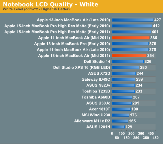

Maximum display brightness on the 2010 MacBook Air was 300 nits.
Maximum display brightness on the 2020 MacBook Pro M1 is 500 nits.
In addition, your 2010 Air's display's backlight most likely lost some of its illumanation capabilities in the past 10 years, and the display is at this point most likely down to no more than 250 nits.
If you want a fair comparison set the 2010 to maximum and the 2020 to 50%.
The MacBook Air late 2010 has much higher nits than you think. In fact, I can barely find a difference while keeping them next to each other at full brightness. Since Apple doesn't specify this on it's page, I found this:
Source:

That which you're referring to is the 2011 MacBook Air, not the 2010 MacBook Air. The 2010 MacBook Air has 306 nits on average.
Either way, I have nothing else to add. If you want to believe that a 5x better battery is not much of an improvement and expect 20+ hours on maximum brightness then so be it. There's nothing I can say to convince you otherwise ;)

What you're referring to is the 2011 MacBook Air, not the 2010 MacBook Air. The 2010 MacBook Air has 306 nits on average.

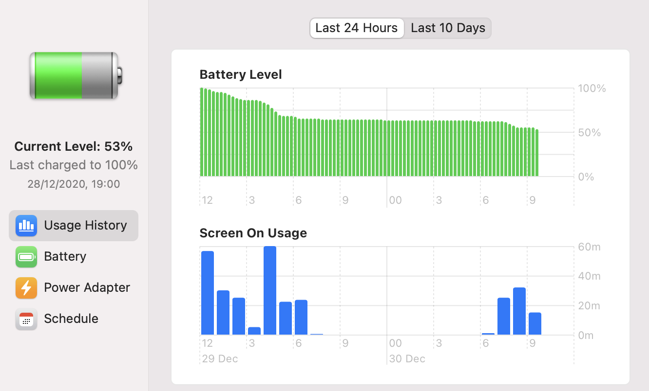

For what it's worth, I'm quite happy with my battery so far. Right now I'm at 53%, it was last on charge 2 days ago on the evening of the 28th, when I decided to do a test. So it was fully charged by 7pm and only used for about half an hour. I then left it for 17 hours to check battery drain, of which there was none whatsoever.
Ive used it for almost 6 hours since, some Youtube in Safari, email, installing and uninstalling software, some writing and coding in Xcode. The rest of the time, just over an hour, was video capture and editing. During which the MacBook Air also powered my Live Gamer Portable 2 Plus and my RetroTink 2X-Multiformat. There was also a few Time Machine backups during this time.
Screen brightness is always at 50% on my MacBook, I don't work in the dark and I live in Scotland, so there's not exactly an abundance of overly bright sunshine at this time of year :D Keyboard backlight is always on, albeit at a very low level. WiFi, Bluetooth and everything else enabled. In fact, the system is very much as it was when it came out of the box, I don't change much other than screensaver and screen off time, which I increase as I find the default values kick in too soon.
Not a massive amount of use, certainly less than I would normally do, but life has a nasty habit of getting in the way sometimes :D But compared to my wife's MBA 2020 (Intel i5) even that use is much better than I'd get out of hers.
