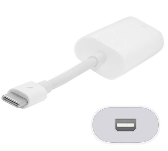

How do I connect a Thunderbolt3/usb-C SSD to 2011 imac with Thunderbolt 1/2 socket? I cannot find the adaptor.
I need a reverse of this ....
For USB-C you can't. For a true Thunderbolt3 SSD simply plug the adaptor into the drive and run a Thunderbolt 1/2 cable from the adaptor to the iMac.
Otherwise if an eSata or USB 3.0 SSD is close enough then I guess you could use something like this:
https://www.apple.com/shop/product/HGC82ZM/A/kanex-thunderbolt-to-esata-usb-30-adapter

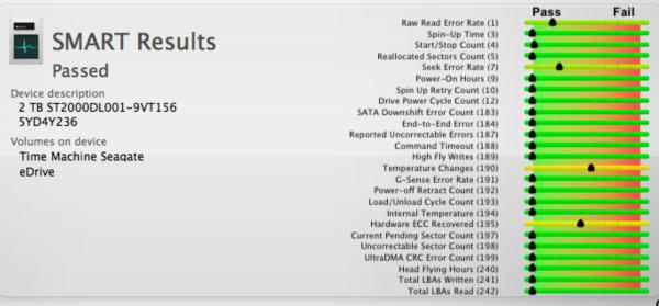

These are screen shots from failing hard drives. Notice that they all passed S.M.A.R.T. and Disk Utility showed them as good. TechTool Pro gives a different picture.
I had repaired each of these in Disk Utility before reformatting and sticking into a Time Machine dock connected eSATA. SMART tests cannot be run over ethernet or USB.

Thanks for the above, but this is getting too technical for me. Are you suggesting I use Tech Tool Pro to check my HDD?
No. You've posted more than enough indicators. It's on its way out. It's old, tired, worn out. Replace it before it's an emergency.
The $99 cost of TTP can be spent for the labor to have it replaced with an SSD if you don't want to do the job yourself.
