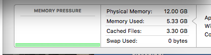

Was clearing out some iOS backups from the HDD last night and iMac really slowed down again during this. I opened activity monitor and pressure graph was red. Is this normal when deleting large files from the HDD? Would the addition of an SSD resolve this?
Uh, what? I think he was talking about the memory pressure graph being red.
There is no disk pressure indicator.
Yes, it was the memory pressure graph that went red when I was deleting the iOS backups, but it hasn't happened since. I also had the Photos App open at the time which may have had something to do with it. I have also made a few changes like turning off animations, reducing transparency, emptying Safari caches, SMT and PRAM restarts, which all seem to have improved things.
I added 8gb ram yesterday also. Now 12 gb total.
It is noticeably faster.
I am holding off on ssd upgrade.
Would an SSHD or Fusion Drive be worth considering as a replacement for the HDD?

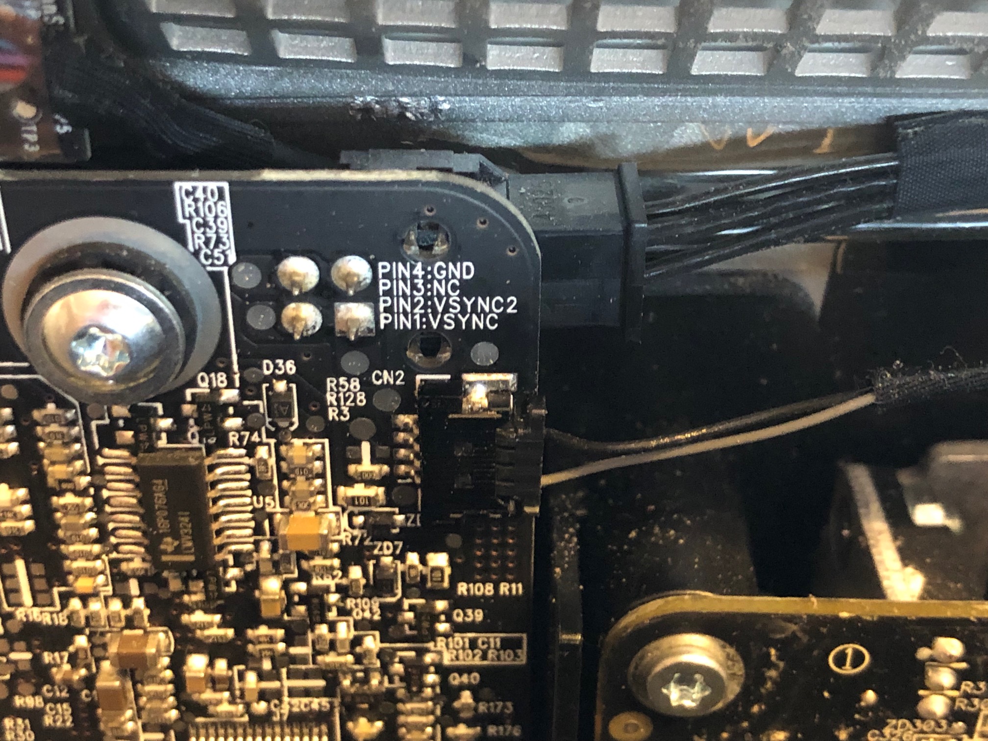

Part way through installation. Have got front glass off and removed the screws for the LCD panel. However, really struggling to get the first cable unplugged (top left vertical sync cable). It looks different from the one in the OWC instruction video. Do I pull it towards me i.e. away from the back of the Mac or pull it to the right.
Pull the vertical sync (center of picture) to the right. If this is the first time the cable has been disconnected since it left the factory then it will probably be jammed in tight and require more effort than you would expect to work loose.
(Also check if the instruction video is for 21.5" or 27").
Thanks, after many attempts finally managed to disconnect it.
