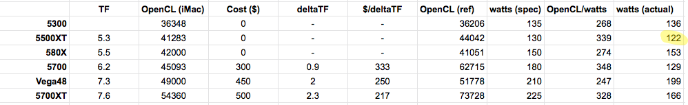

I did some calculations to estimate energy used by the GPU on the iMac 2020 based on Geekbench OpenCL values and published TDP (watts), and I think 5500XT is the coolest running chip for iMac 2020 (and cooler overall compared with 2019). May explain why they could reduce the sound level on their spec.
I did some calculations to estimate energy used by the GPU on the iMac 2020 based on Geekbench OpenCL values and published TDP (watts), and I think 5500XT is the coolest running chip for iMac 2020.
Uhmmm.. the cards in the Mac have little in common with their desktop counterparts. All of them have a TDP of 130W. Also, since heat and power consumption grow rather exponentially with clock speed, I would expect the 5700 to be running the coolest.
https://www.amd.com/en/graphics/radeon-apple-5000-series
I don't believe this spec sheet... maybe it is nominal power consumption and not peak power consumption.
The OpenCL/TDP does not scale to match the desktop version of the 5700XT with only 130W.
I think 5500XT and 5700 are similar in terms of thermal load, but bang-for-the-buck wise it's best to skip the 5700 and go to the 5700XT... but then you're running hot thermally, haha!
Since I noticed you like math, we could very roughly run a calculation like this:
thermal output = C (compute units) x Freq. x Freq. (squared clock speed)
It comes out like this, relative to one another:
5300 -> 54M
5500 -> 74M
5700 -> 65M
5700XT -> 89M
To be taken with a big grain of salt, but it would indicate that they run from coolest to hottest: 5300 -> 5700 -> 5500XT -> 5700XT
