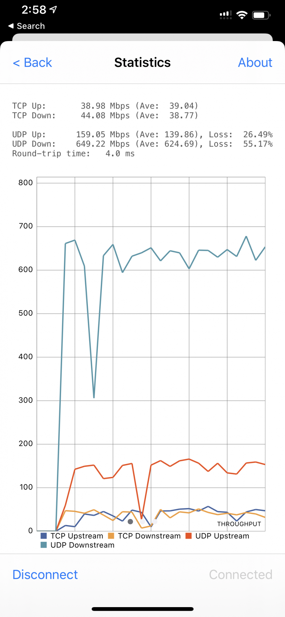

If you run a local (Not internet, not Speed Test) network tester what kind of results do you get? You install the server on one mac and run the client on another Apple device, iPhone, Mac, etc. I use Tamosoft's server & client:

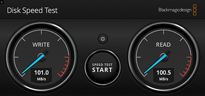

If only for storage, 5900RPM are fine since you are limited to 125MB/s by your ethernet link. I understand batches but there’s a limit for geekness. I’d take Western Digital personally.
