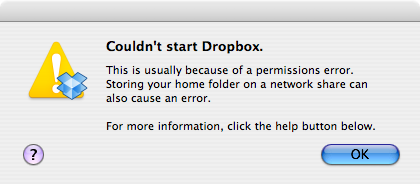

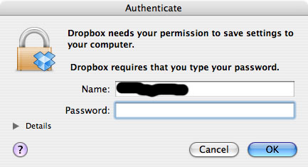

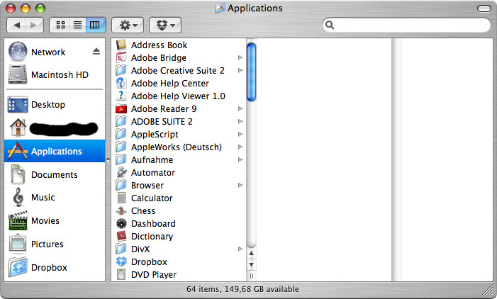

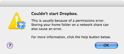

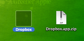

Sorry, I cam home late this day, so I couldn't do the screenshots for you. But now I did.
Console:
May 28 23:56:49 myname-ibook-g4 arch: SystemVersion faker for Dropbox Loaded (c) Czo 2015.
The Screenshots are in order of appearance of the steps.
1. see-through icon on Desktop
2. visible icon after dropping it on the apps folder
3. password log in window
4. error message
(when I click on the help button I get here https://www.dropbox.com/help/72

Did you try the resolution for OS X that Dropbox has on the bottom of the page you linked to?
  1. Quit Dropbox by clicking on the Dropbox icon from the menu bar, clicking on the gear icon, and selecting Quit Dropbox from the pop-up menu.
  2. Open your Terminal app (located at /Applications/Utilities/Terminal).
  3. Copy and paste the following lines into the Terminal, one at a time, and press Return after each one. Please make sure you copy and paste these commands (don't type them by hand), as getting them wrong could cause some harm. You'll be prompted for your computer user's password (not your Dropbox password) after entering the first command. Keep in mind that the password field in the terminal will remain blank as you type your password. After you type it, just press Return.
    sudo chflags -R nouchg ~/Dropbox ~/.dropbox sudo chown "$USER" "$HOME" sudo chown -R "$USER" ~/Dropbox ~/.dropbox sudo chmod -RN ~/.dropbox ~/Dropbox chmod -R u+rw ~/Dropbox ~/.dropbox
    If the location of your Dropbox folder is not ~/Dropbox, make sure you modify all the commands above to point to the correct location.
  4. Restart Dropbox. Dropbox is located in your Applications folder.
Thanks for the tip.
It gives me the following after putting in the 4th command line
noname:~ myname$ sudo chmod -RN ~/.dropbox ~/Dropbox
chmod: Failed to clear ACL on file dropbox.pid: Operation not supported
chmod: Failed to clear ACL on file new_trace: Operation not supported
chmod: Failed to clear ACL on file l: Operation not supported
chmod: Failed to clear ACL on file toolbar_index: Operation not supported
chmod: Failed to clear ACL on file finderplugin: Operation not supported
chmod: Failed to clear ACL on file config.db: Operation not supported
chmod: Failed to clear ACL on file config.dbx: Operation not supported
chmod: Failed to clear ACL on file host.dbx: Operation not supported
chmod: Failed to clear ACL on file hostkeys: Operation not supported
chmod: Failed to clear ACL on file unlink.db: Operation not supported
chmod: Failed to clear ACL on file instance1: Operation not supported
chmod: Failed to clear ACL on file instance.dbx: Operation not supported
chmod: Failed to clear ACL on file instance_db: Operation not supported
chmod: Failed to clear ACL on file 0: Operation not supported
chmod: Failed to clear ACL on file 55660dee: Operation not supported
chmod: Failed to clear ACL on file logs: Operation not supported
chmod: Failed to clear ACL on file /Users/myname/.dropbox: Operation not supported
chmod: Failed to clear ACL on file .dropbox: Operation not supported
chmod: Failed to clear ACL on file hidden: Operation not supported
chmod: Failed to clear ACL on file prefetch_cache: Operation not supported
chmod: Failed to clear ACL on file temp_hidden: Operation not supported
chmod: Failed to clear ACL on file .dropbox.cache: Operation not supported
chmod: Failed to clear ACL on file .DS_Store: Operation not supported
chmod: Failed to clear ACL on file 13.aiff: Operation not supported
chmod: Failed to clear ACL on file 1 (128samples), rewire-erhalten normal-a.png: Operation not supported
chmod: Failed to clear ACL on file 2 (128samples), rewire-erhalten normal-b mehrmals durchgelaufen.png: Operation not supported
chmod: Failed to clear ACL on file 3 (256samples), rewire-erhalten live, hohe CPU.png: Operation not supported
chmod: Failed to clear ACL on file 4 (128samples), rewire-erhalten live, hohe CPU.png: Operation not supported
chmod: Failed to clear ACL on file Pasted Graphic.tiff: Operation not supported
chmod: Failed to clear ACL on file TXT.rtf: Operation not supported
chmod: Failed to clear ACL on file list big Kopie 2.rtfd: Operation not supported
chmod: Failed to clear ACL on file /Users/myname/Dropbox: Operation not supported
(I shortened some of it, in this post. I deleted several bla bla bla filename: Operation not supported)
After all steps and closing terminal dropbox.app still doesn't work.
