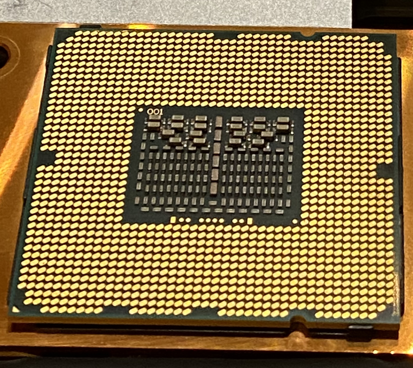

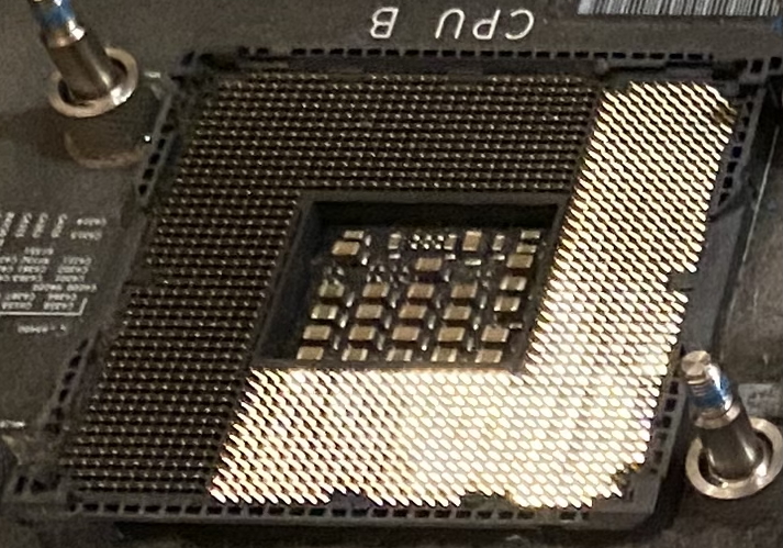

Did you take good photos of the sockets and the CPUs, if not do some macro photos of the sockets and photos where we can see the CPUs, both sides.
That would… require me to tear it all down again. Took me seven months to feel comfortable doing it the first time. I swear, they looked totally fine as I put them into place. No bent pins, no dust on the bottom of the chips, etc. After 16 years, the thermal paste on the CPUs was even still soft, for heaven’s sake (it was baked onto the northbridge, though), and I was surprised by that.
EDIT: I do just happen to have two images. One of my CPUs remained stuck to the heatsink when I took it off, so I have a shot of both the bottom of the chip and the socket. The other one stayed in place, but I did have to pick it up and set it aside later (had to take the daughterboard out of the tray and tilt it on its side to disassemble and reassemble the northbridge heatsink, and since they’re unlidded CPUs it would have just fallen out). But again, they were still pristine when I put them both back later, and I noticed zero pins out of place and no dust between them in the sockets.

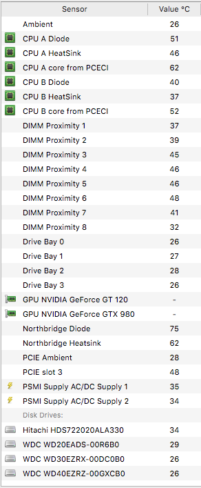

Installing a temperature monitor tells me the northbridge is sitting at 75°C idle, which I’m reading is a correct/normal temperature for a Mac Pro without an additional fan added. My CPU A diode is 51°C, but my CPU B diode is 38°C. Does that mean I should tighten A’s heat sink just a tiny bit more? Or was that just the system running a few cores more on the other one for some reason? Thanks everyone who, over the last few months, gave me the courage to finally try this out.
So for anyone doing this sort of thing: Don’t be afraid to tighten your heat sinks down, even on unlidded chips. Fingertip tight, but get them tight. I want to do a tiny stress test (gaming in windows) to check northbridge and CPU temps next…
