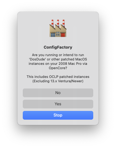

Not a criticism, but I did encounter a bit of confusion trying to understand the logic of one of the ConfigFactory questions relating to DosDude and OCLP configurations. There are two logical questions offered, however a qualifier statement caused me a brain meld. I don't have a screenshot of this, but can you provide more information on the logic behind and consequence of these questions? Also, is there a step-by-step break down for each question/choice when using Configfactory that explains in more detail what they mean and the implications of each choice?

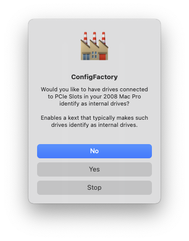

So how does a person with a baseline knowledge level close to zero operate? They need to read Post 1, which clearly says that if you do not know the answer to a query, select the highlighted button; of which there is always one. The highlighted button, which can vary based on previous responses and other factors, is always the "Safest" option.
So if asked about having drives on PCIe slots displayed as internal drives for example, the "Most Performant" answer for most is probably "YES" but "NO" is highlighted as sure to be issue free. The person that doesn't know what this item means doesn't get the drives shown as internal but also doesn't get affected by any issues.

On the specific bit you mentioned as causing a meltdown:
Note that "Stop" is the safest option here as those that cannot answer should not be going any further.
  1. Select "STOP" if unsure about what you have in place and/or plan.
  2. Select "YES" if any of these apply:
    • You have, or plan to get, DosDude instances and you plan to run such via OpenCore.
    • You have, or plan to get, OCLP instances of 12.x Monterey and/or 11.x BigSur that are patched.
  3. Select "NO" Otherwise.
I think persons reading the dialogue should be able to independently infer the above; subject to getting that the query is about plans to run "PATCHED MacOS instances via OPENCORE", if any, and not about DosDude/OCLP in themselves.
It happens to be the case that DosDude instances are invariably patched but OCLP instances may be or may not be.
It happens to be the case that OCLP instances are always run via OpenCore but DosDude instances may or may not.
It happens to be the case that ConfigFactory creates OpenCore instances for "Vanilla" Mac OS 12.x Monterey/Older.
It happens to be the case that Mac OS patched via DosDude always fall into this range of versions (Potential Conflict).
It happens to be the case that Mac OS patched via the OCLP may fall into this range of versions (Potential Conflict).

Anyway, the next release will change:
"... OCLP patched instances (Excluding 13.x Ventura/Newer)" to "... patched OCLP instances of 12.x Monterey and/or 11.x BigSur"
Hopefully helps with meltdowns!
