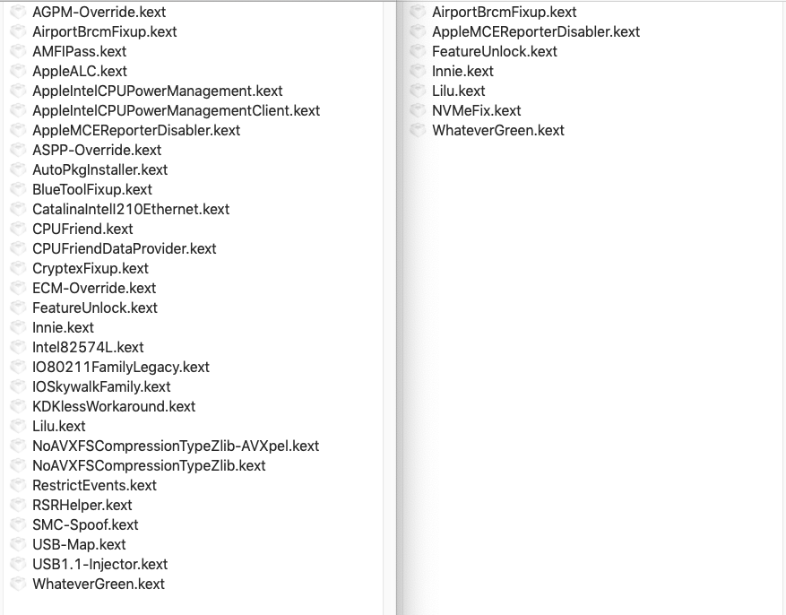

I was looking at experimenting with Sequoia on a test drive, and also updating my production cMP from 14.6.6 to 14.6.7, so I downloaded MyBootMgr 1.0.1 and ran ConfigFactory but got an unexpected result - hardly any of the Kext files were copied across on the build. Here's a screenshot of the difference (left is my current working OC_EXT Kext folder, and the new one built with 1.0.1 on the right).
@Dayo I've included my log file. Are you able to confirm if there's an issue with ConfigFactory build, or something I've done wrong? I use the manual option to select the options, and believe I've selected all the options I made in the previous build I did using MyBootMgr 1.0.

@JedNZ ... Not sure I fully understand the issue. Is the problem that the kexts in your existing OC_EXT folder was not propagated between the two runs?
Note that you are supposed to overwrite the OC_EXT folder created by ConfigFactory with the contents of the OC folder created by the OCLP. You presumably did this for your existing instance and are positioned to do the same now again or am I missing something?
BTW, "OC_EXT" will be changed to "OC_X**" as of the next version of MyBootMgr with "OC_X01" being for Ventura/Sonoma and "OC_X02" being for Sequoia/Newer.
This is to allow seamless multiboot of Sequoia and Ventura/Sonoma via the OCLP. Such is already an issue on MP31 where an undesirable-if-avoidable "cpus=4" boot arg is needed for Sequoia. I expect more of such to crop up with time across the board.
The screenshot above is what the two versions of MyBootMgr > ConfigFactor created - v1.0.0 (on the left) vs 1.0.1 (on the right). The one on the left is my currently deployed and working version - i.e. that's what is on the ESP.
When MyBootMgr 1.0.1 > ConfigFactory builds the OC_EXT there are a whole stack of Kexts missing, and the config.plist also looks screwed up compared to the previous working version I created using MyBootMgr 1.0.0. Are there any clues for you looking at the two config.plist files I uploaded above? I did run ConfigFactor twice and I got the exact same result both times, hence why I posted. Note: I do all of this running a native macOS Mojave boot drive.

The 1.0 Config Plist was not generated by ConfigFactory but by the OCLP. It is in your existing OC_EXT folder because you copied in an OCLP generated OC folder (kexts, config file and all) to completely replace what ConfigFactory generates as the process requires. I think forgetting you need to do this might be your sticking point.
I'll refer you to the guide on incorporating OCLP instances into MyBootMgr setups that *YOU* wrote:
Follow it and you would be good.
I might amend ConfigFactory to create an empty OC_EXT folder to reinforce that it needs to be populated separately
