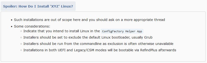

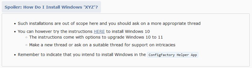

I wish to add Windows and Linux HDDs to cMP after RefindPlus_OC_myBootMGR setup. How should I proceed? Should I pre install and just reconnect after setting, or install after all? Are Linux UEFI installs capable of damaging cMP as Windows?
As with most things related to MyBootMgr, answers can be found in Post 1.
For Windows:
For Linux:

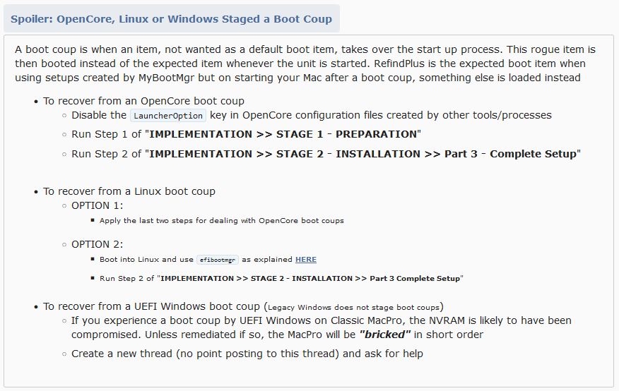

You will almost certainly need to recover from an installation boot coup but I believe it is possible to stop Grub updates and most that use other loaders, such as rEFInd, typically do this. You will need to ask for guidance on a Linux forum.
In any case, you will find guidance on dealing with boot coups in Post 1:
