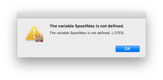

Have just returned to playing with MyBootMgr as I want to upgrade my test drive to the latest version of Ventura 13.5.1. I've downloaded v094 and when running it it comes up with the attached error message towards the end of the build process in ConfigFactory. Tried it twice - once setting it up manual myself, and a second time using default settings for my cMP. It fails both ways. Attached log. Anything obvious I'm doing wrong @Dayo ?
  • DebugLog_ConfigFactory.log.zip
Those types of messages are from scripting bugs. Trying to use a variable without setting it first.
Probably only affects the Ventura path.
Will take a look later.

Found the issue with a path to setting OpenCore up for Ventura/Newer.
I have just updated the package. That is, release version not changed.
Reactions: JedNZ
Thanks @Dayo. The updated version works a charm. :)
The config.plist files have an nvram setting of -v added which boots with Verbose mode. I can't remember seeing an option for this in Configfactory. This was actually quite helpful to be honest as I didn't know it was as easy as toggling that in/out. But I have manually removed -v that now my system is working perfectly, even with Ventura 13.5.1.
Reactions: Dayo
I manually removed -v
ConfigFactory sets things up in DEBUG mode given that installation time is when issues are most likely to present. This means logs are produced by RefindPlus and OpenCore along with verbose Mac OS boots (if done via OpenCore).
If following the guide in Post 1, you would see that it documents the verbose boot default and also see that when you implement the step of running the SwitchRunMode app to switch to RELEASE mode as part of completion, that the app removes the verbose boot flag when going from DBG to REL (along with stopping the logging). It adds the flag and switches logging on when when going from REL to DBG instead.
After manually removing the flag, I presume debug logging is now still active and is not switched off as should be the case. Also presumably leaves RefindPlus and OpenCore DBG build files running. These run slower than REL build files.

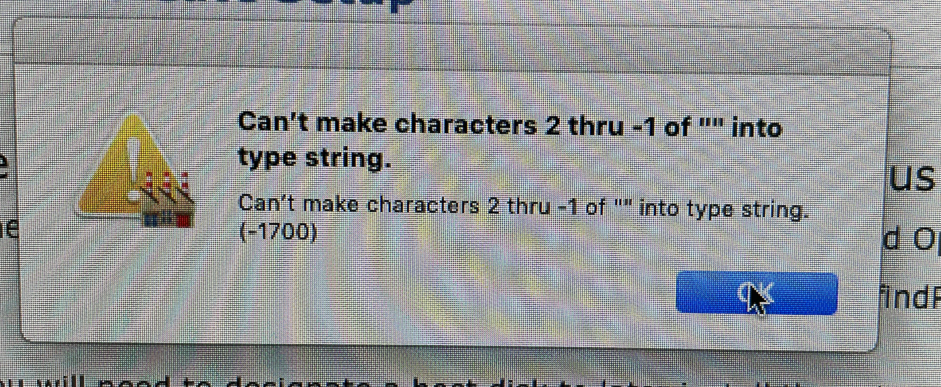

Hey Guys, I'm following the instructions to install refind with mybootmgr. I am running configfactory, however at the end I'm getting an error message... See Screenshot.
Thanks for the report.
Q1: What is the output of running the command below in Terminal?
system_profiler SPDisplaysDataType
Q2: Are you running ConfigFactory on a cMP/Xserve or something else?

Q1:
Graphics/Displays:
Display:
Type: GPU
Bus: PCIe
PCIe Lane Width: x16
VRAM (Total): 31 MB
Vendor: AMD (0x1002)
Device ID: 0x73bf
Revision ID: 0x00c0
Kernel Extension Info: No Kext Loaded
Displays:
Display:
Resolution: 3840 x 2160 (2160p 4K UHD - Ultra High Definition)
UI Looks like: 3840 x 2160
Framebuffer Depth: 24-Bit Color (ARGB8888)
Main Display: Yes
Mirror: Off
Online: Yes
Automatically Adjust Brightness: No
Q2: on a cMP, Mac Pro 5,1 6950XT -> Flash w/ Syncretic Patch 6900XT
Configuring on Mojave Natively (without OpenCore)
I see. Thanks.
Could be that the @Syncretic patch involves removing the "Chipset Model" output.
Bin the current package and download again after restarting your browser.
I have updated the package with a workaround for when that output is absent.
