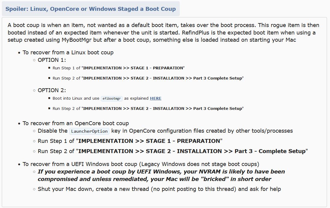

I ran into a Opencore boot Coup thank goodness I was able to fix it. This is why you remind to make sure LauncherOption is changed from Full to Disabled especially if one decides to install their own instance of OC, looks like this is set to FULL by default while Config Factory makes the default Disabled.
So use a ConfigFactory configured instance to boot Catalina and use the OCLP configured instance to boot Ventura although both instances will show Catalina and Ventura.
Correct. The controls on what boot options are shown in the OpenCore picker are currently limited and therefore, you cannot trivially hide Ventura in one instance and hide Catalina in another in a manner that will cover all possible/likely setups.
I ran into an OpenCore boot coup

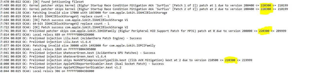

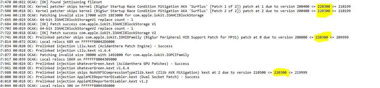

Your OpenCore log says you were trying to boot the 22.3.0 Kernel (Ventura) instead:
I did enable OpenCanopy but fairly sure this is not the issue.
That doesn't seem to be the only thing changed but in any case, you need to set things up without making modifications and see if it works first when putting stuff together.
If it fails, there will be no point going forward with mixing other stuff in and you can go to the source for resolution.
If on the other hand it works unmodified but falls over after you muck with it later, you will know where the issues arose.

Yes I did when it would not let me part from the OC picker screen, so I chose Ventura so it would reboot the Mac instead of just powering the mac off and back on.
I left everything as default in OC config not one change still won't boot using OC. Log files and Config attached. The only other thing I can think of is the re-install has left some in place. I am going to run the CF again but this time I will choose yes to Dosdude or any patching, if t boots OC then there must still be patching laying around interfering.

Took a look at this and it pointed at a quite nasty bug in the code that syncs the kext instances between the OC instances.
I have done a temporary patch for this and re-uploaded v090 as the code base is again in flux.

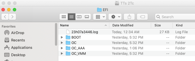

I see this when I open the EFI:
I've shared the log file previously on GitHub. Where do I find the other files you want?

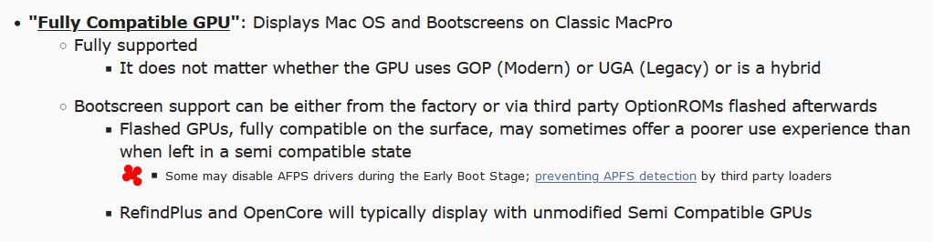

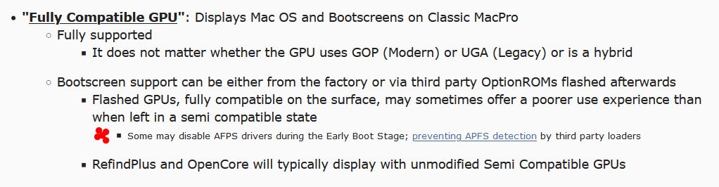

I would wager that the GPU used when Drive B did not show up was a flashed GPU and if you had read Post 1, you would have seen this under Requirements >> Bootscreen Support:
If you were running a flashed GPU when Drive B did not show up and Drive B only contains an APFS volume, then it was likely that the GPU caused the disappearance.

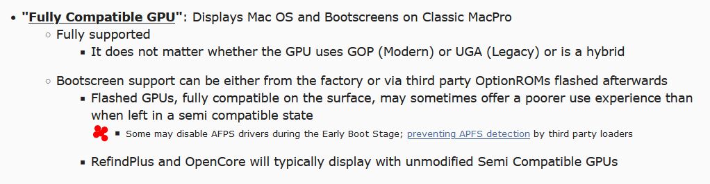

thanks for your reply. i did install MyBootMgr completely from scratch, including a full system reset (see steps 2-3 of my previous post) and took care to ensure i was changing one variable at a time, though it is possible i got my log files mixed up.
i do not own a flashed GPU. the only two GPUs that have been inside the system are the Apple HD 2600 XT which i used to set up El Capitan, and the unflashed GTX 760.
i changed the name of the volume on drive B (it previously had a temporary name of "nvmeee") and, following the link you posted, edited .contentDetails on the preboot volume to match. the volume on drive A (SATA) is called "Polyrhythm" and the one on drive B (NVMe) "Serenia".
i then did the following tests:
TEST1: HD 2600 XT, drives A,B: RefindPlus and OC_LEG both show Polyrhythm and Serenia
TEST2: HD 2600 XT, drive B: RefindPlus shows no volumes, OC_LEG only shows System Restart, System Shutdown, and Reset NVRAM
TEST3: HD 2600 XT, drive A: RefindPlus and OC_LEG both show only Polyrhythm (just to prove that Serenia is not on this drive)
for the next tests i swapped in the GTX 760, which again no longer gives me RefindPlus or OpenCore screens with v091. i have RefindPlus configured to automatically load OC_LEG, which in turn has a timeout of 10 minutes to allow me to select a volume blindly.
TEST4: GTX 760, drives A,B: i press down followed by return in an attempt to select Serenia. after a long wait Polyrhythm boots in safe mode
TEST5: GTX 760, drive B: i press return and the system reboots, suggesting no volumes are available again
so the volume name change worked, but regardless of the GPU, drive B does not show up unless drive A is also connected.
attached are the logs for each of these test cases.
