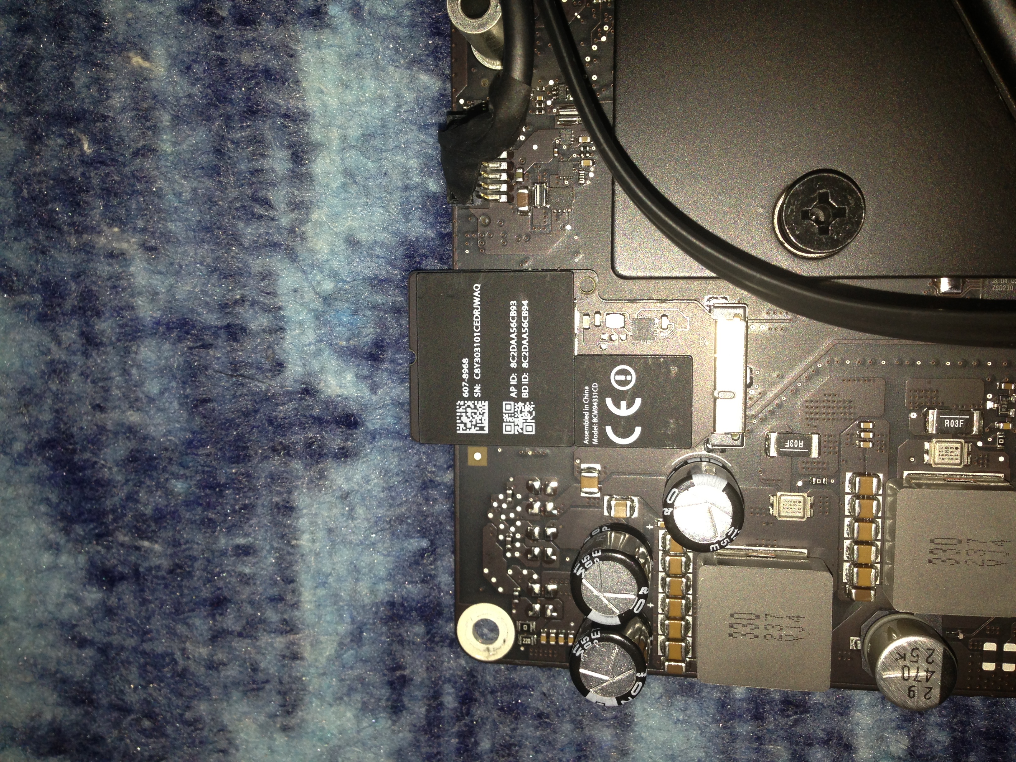

Yes. The blade style drive mounts to the logic board. The SATA Hard drive is mounted on it's own and connected to the logic board via a SATA cable. They are completely separate.

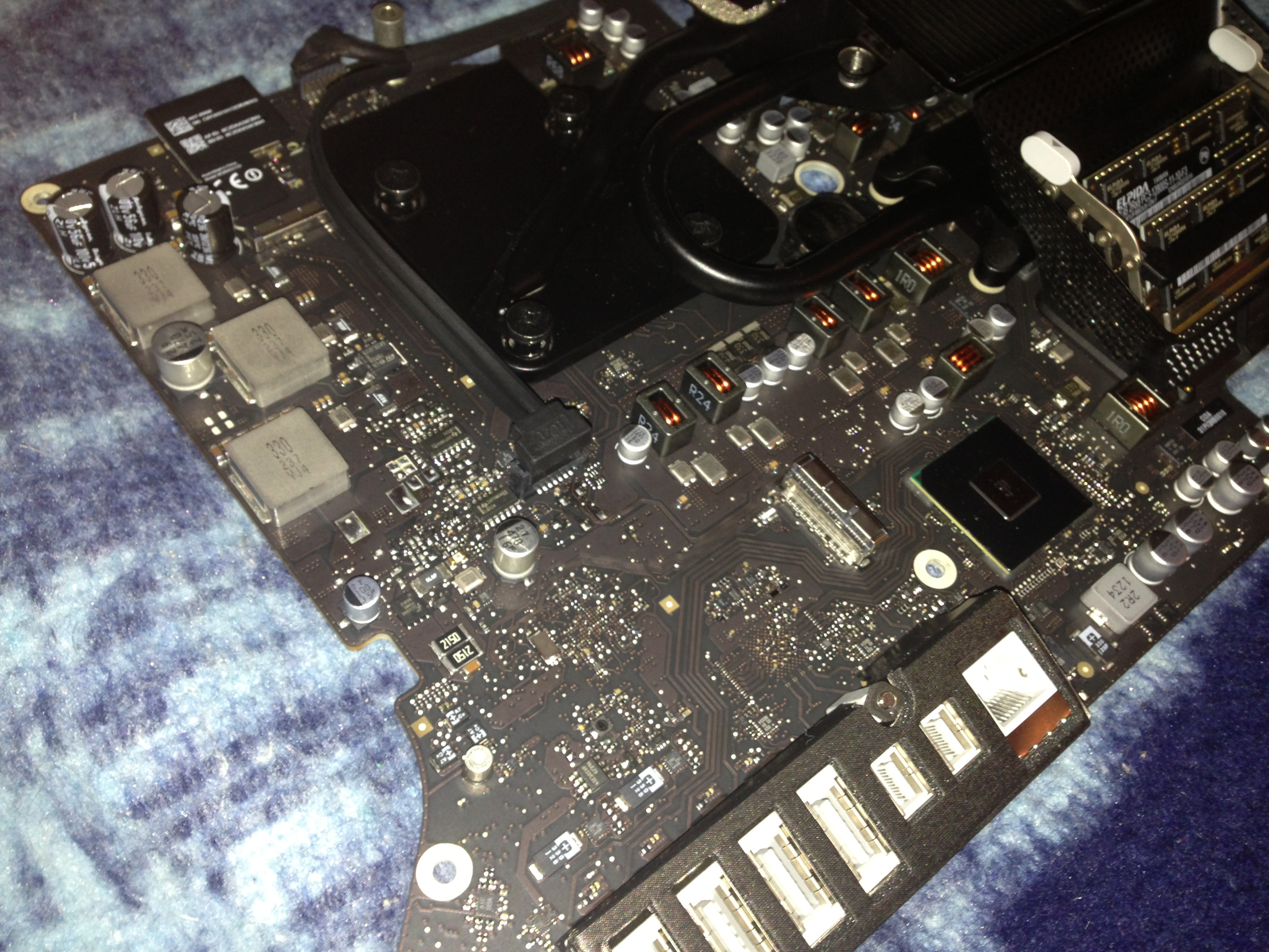

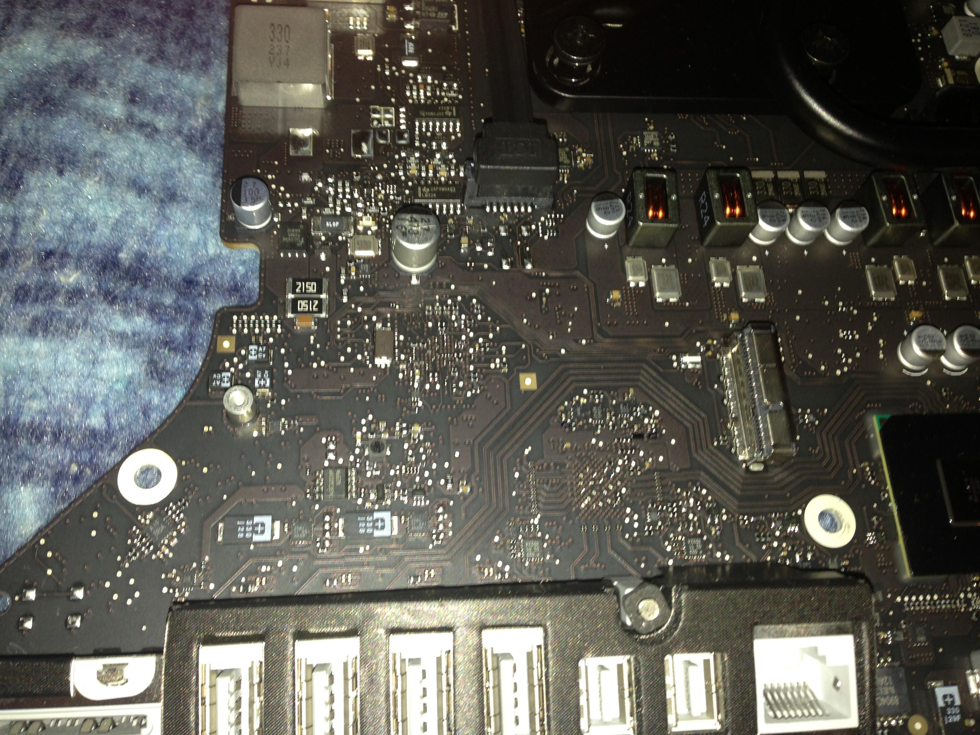

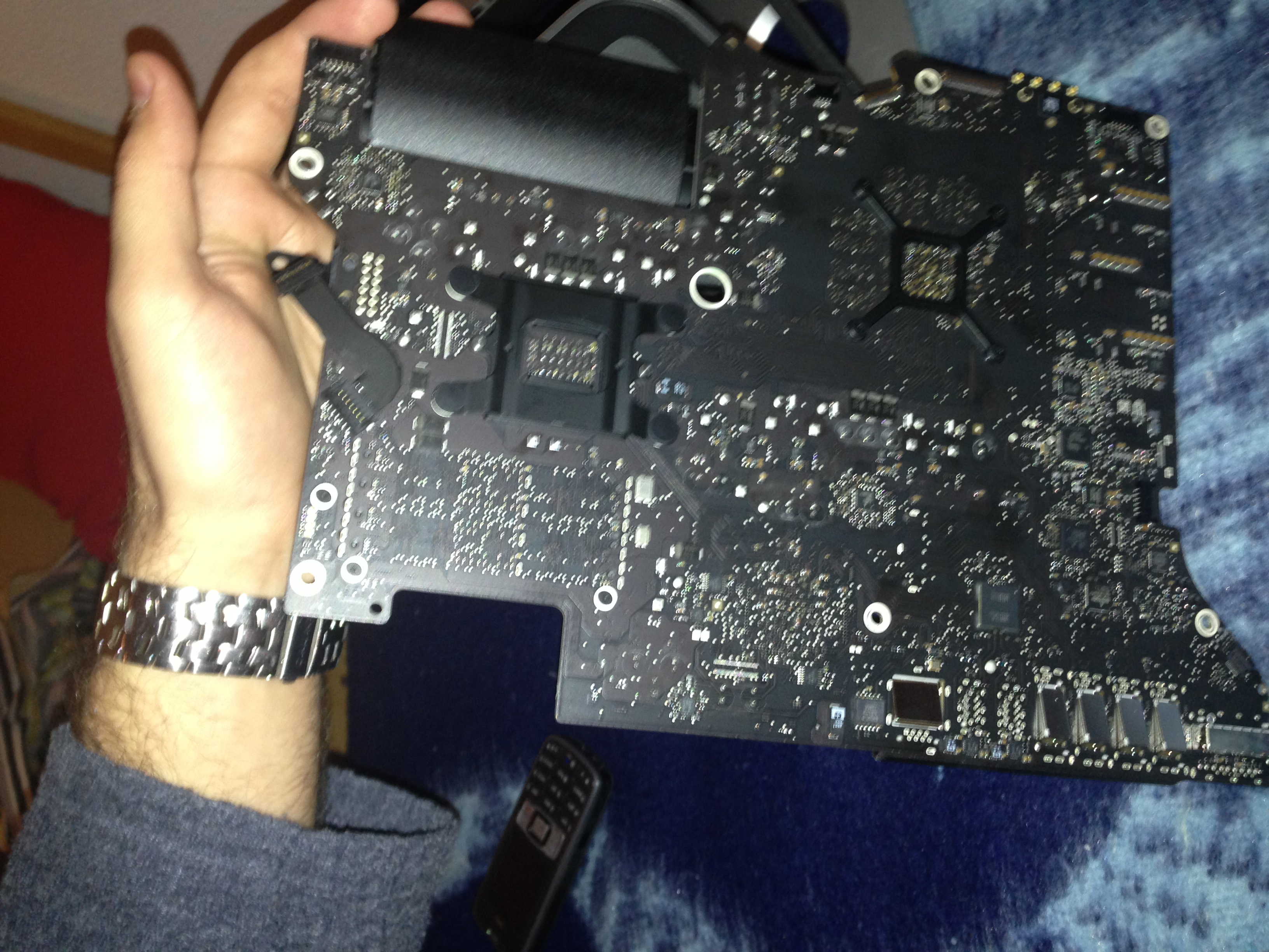

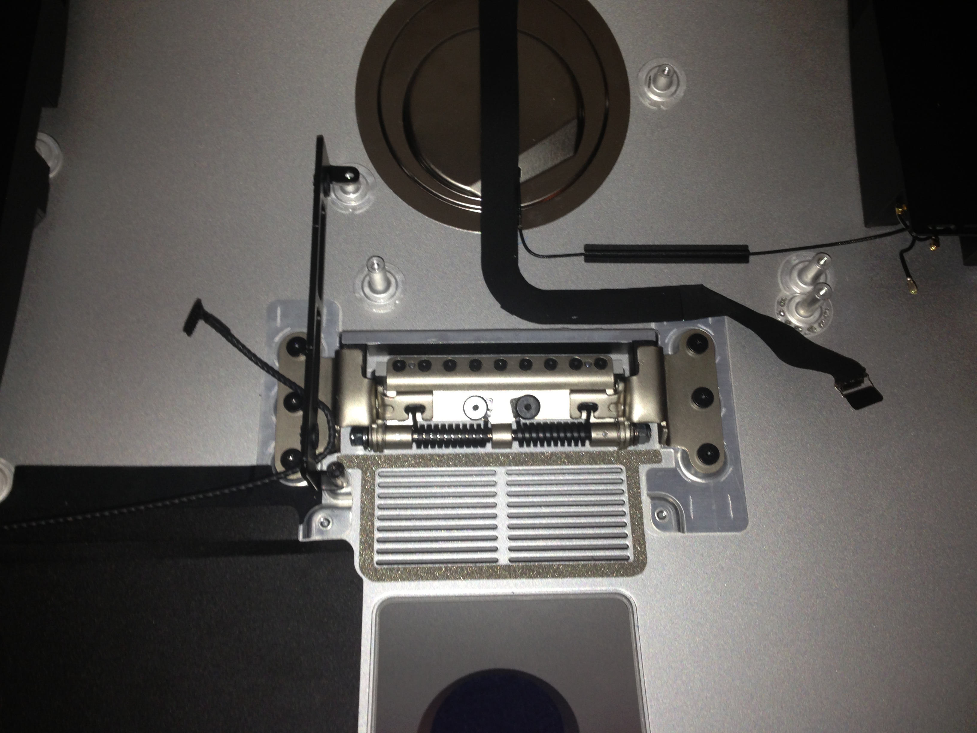

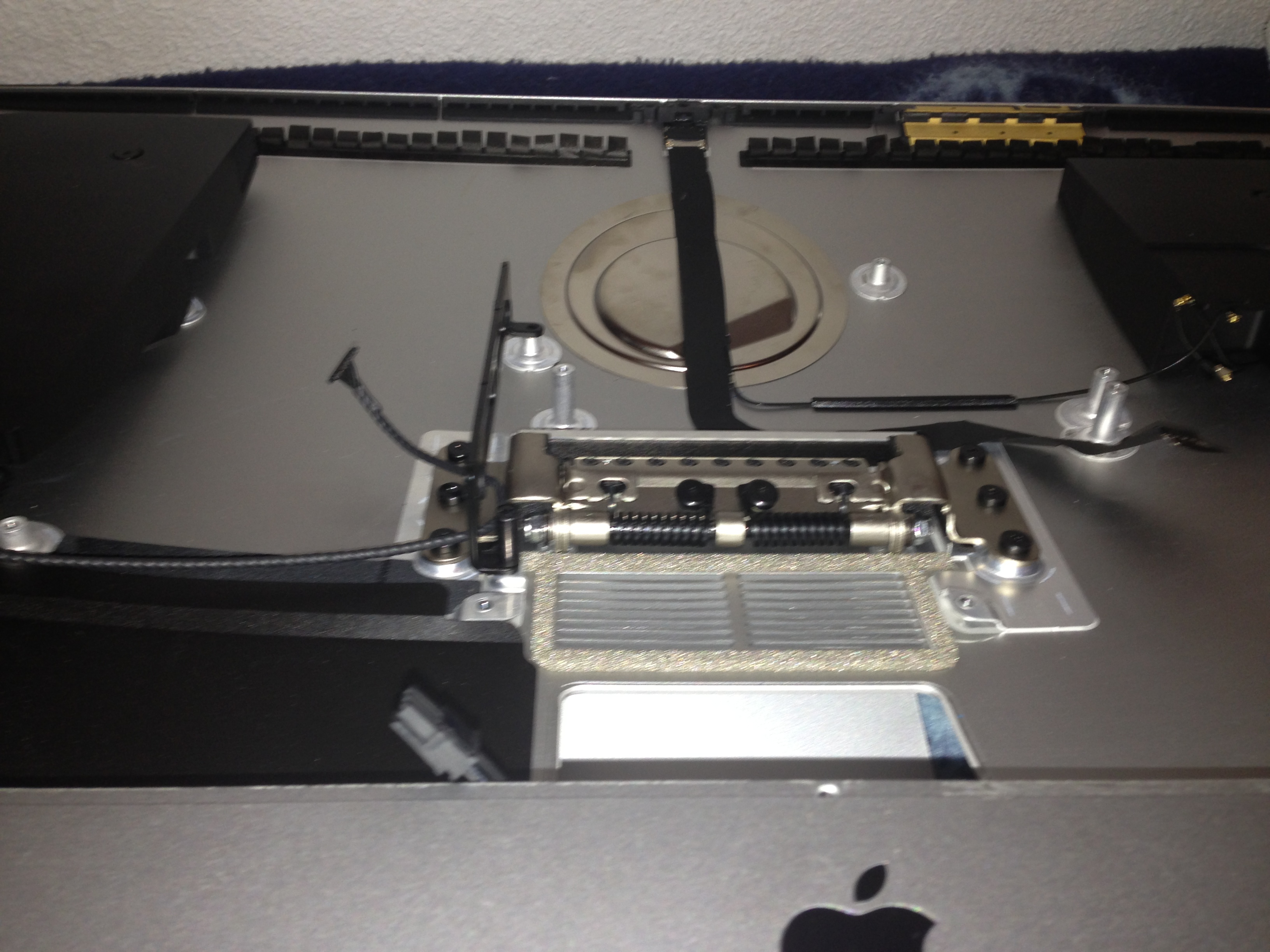

I have the iMac disassembled, if you want a picture of something special or you have any questions, do not hesitate.

Yes, picture of where blade ssd is located in imac 27
Very generous offer, I appreciate it and I will definitely take advantage if you dont mind... a series of questions to follow and if you could take some pictures of the install, such as ssd/sata drive placement + how your mounting and what wiring your using for the secondary hard drive.

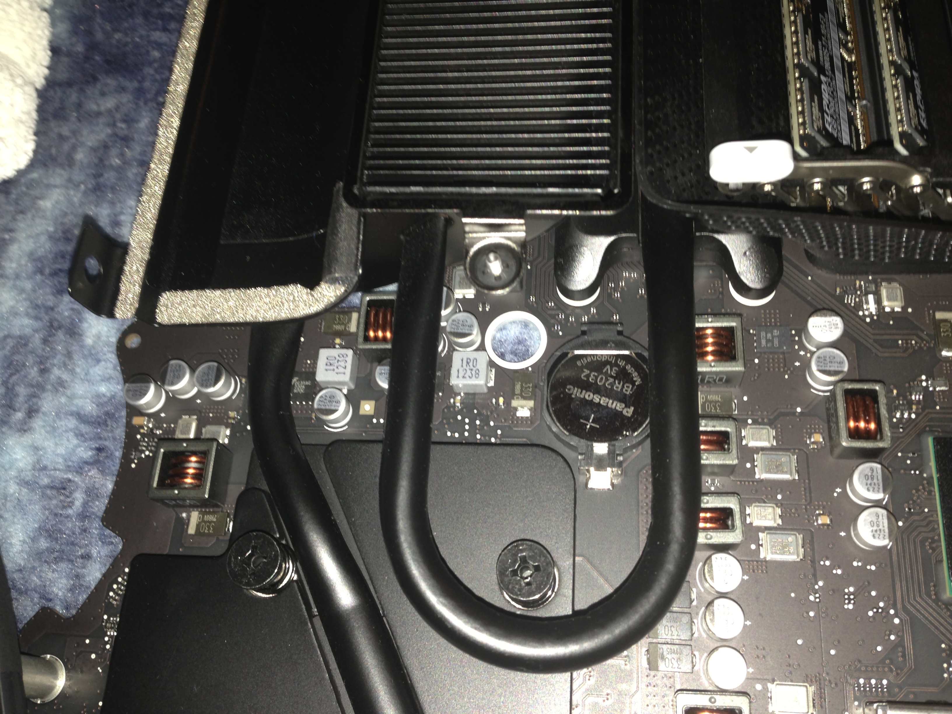

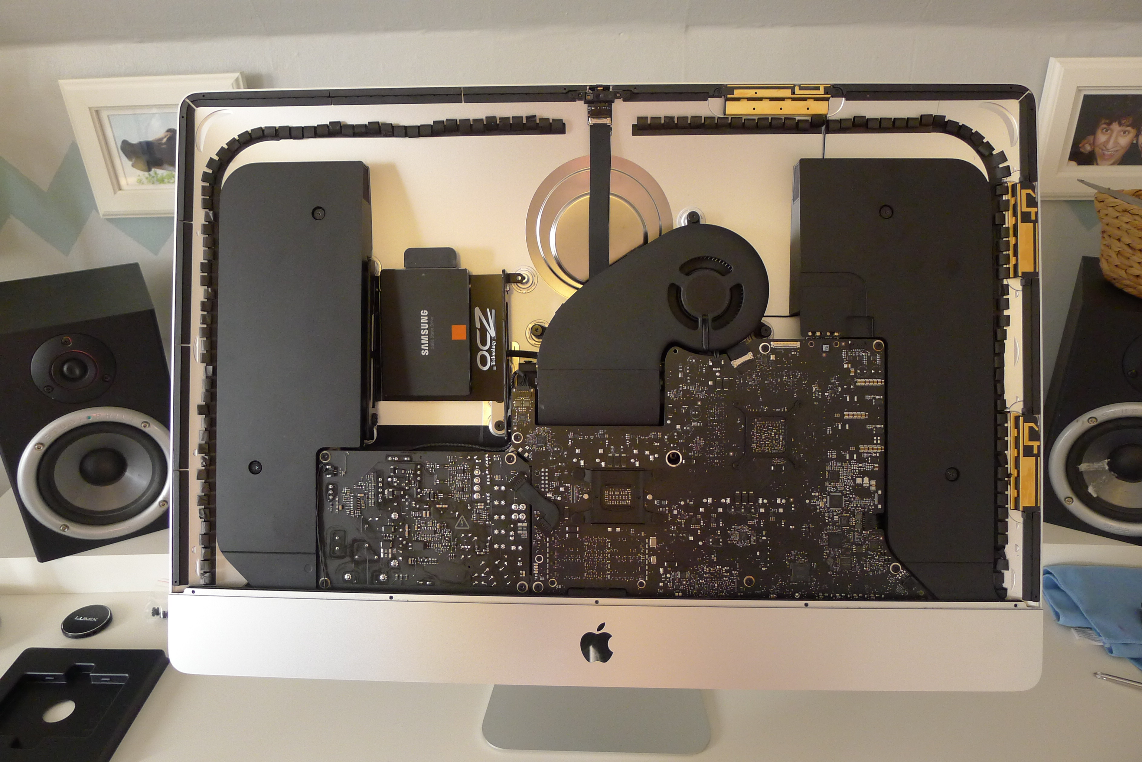

If you have purchased a non fusion equipped iMac then you will need buy a Apple torx screw to keep the ssd firmly in place. These can be found here iMac Torx Screws I think that every 27 inch iMac comes with the blade SSD connector but only the high end 21.5 inch iMacs come with this connector.
You can see in the images above where Apples SSD connector is placed on the Logic board. You will also see where the lug for the screw is positioned. If you know what you are doing here you can very easily save yourself a few hundred dollars off Apples SSD prices depending on what blade you go for. For me the 128GB SSD is a bit of a joke for $250.

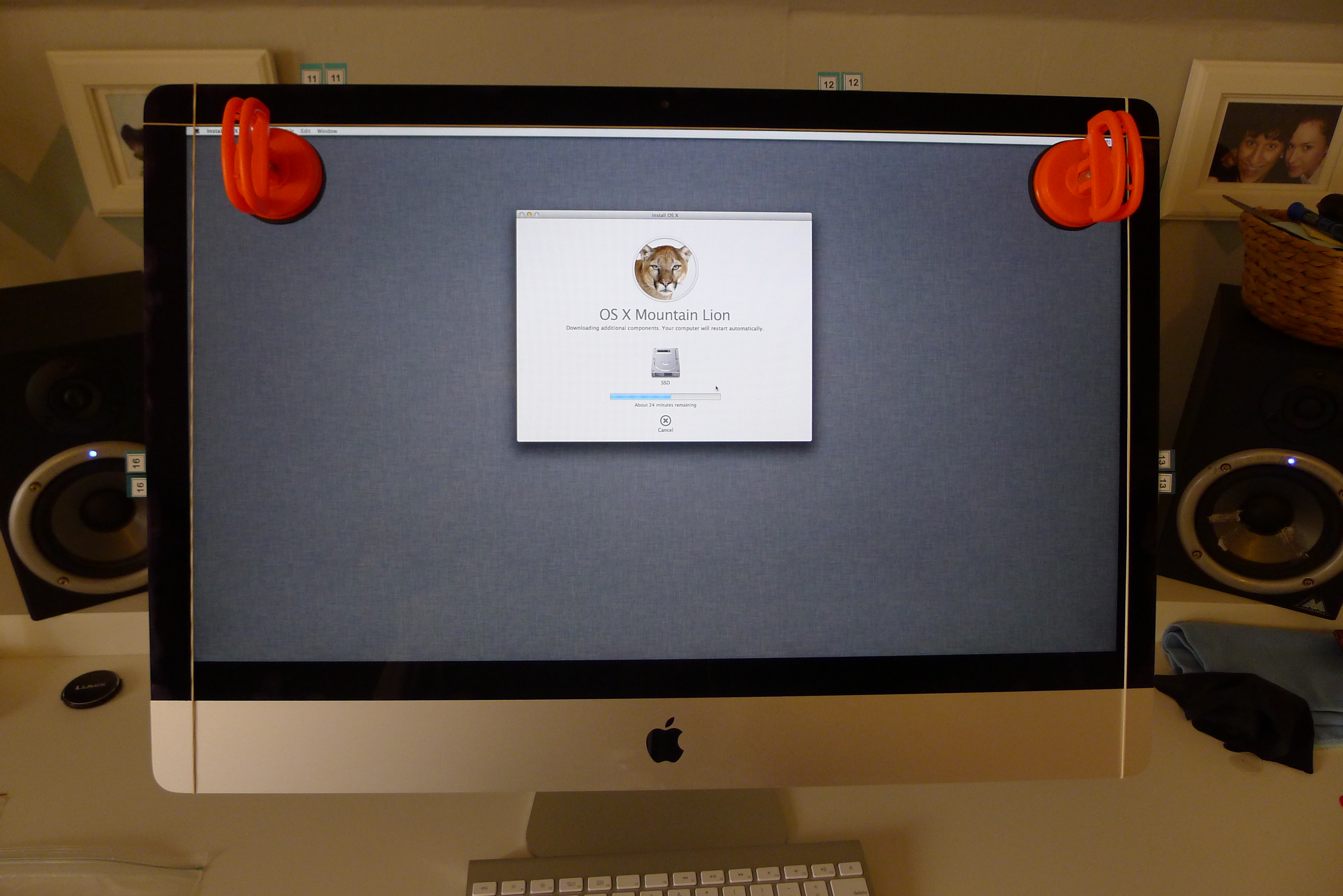

done and done

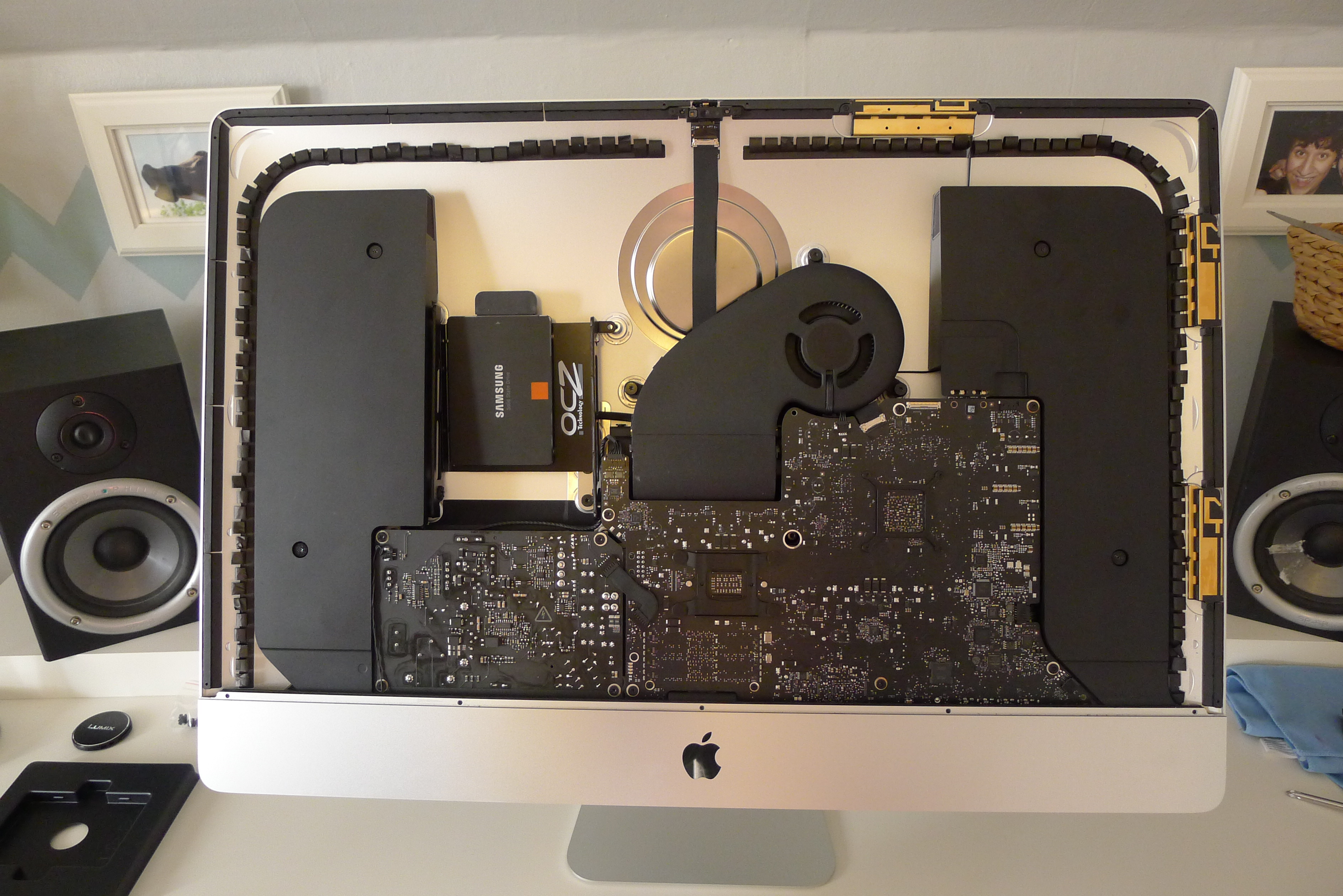

decided to use the tape from apple components. got myself an 840 pro 256GB and an external enclosure for the HDD. Got the wife to help me out. Need to do a lot of copying but this thing is flying!
