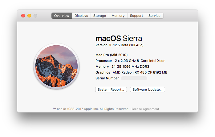

I installed 10.12.5 Beta tonight. RX 470/480 still works.
Is HDMI/DP audio fully passing thru on 10.12.5? HDMIAudio-1.1.kext activates it on 10.12.4 albeit slow, distorted and useless sound.
So glad to see 10.12.5 ßetas working. The ß2 update installed smoothly and the old commands I posted above work great. Thanks for letting us know that ß1 installed correctly for you @theitsage.

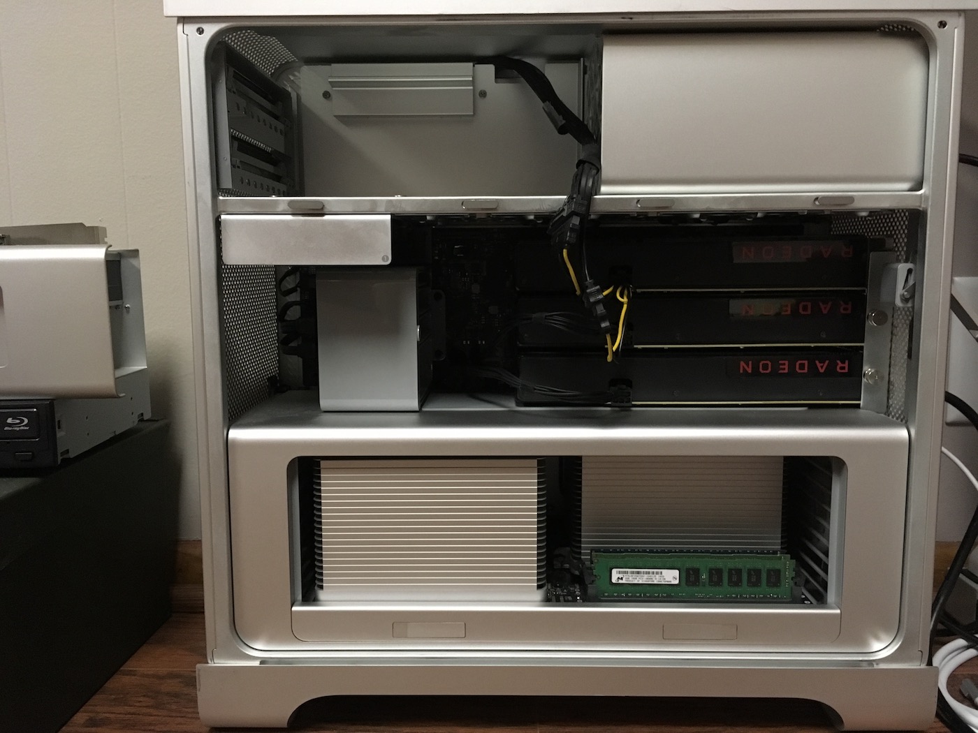

@applCore why do you need an external PSU? I'm running three RX 480 with the internal PSU.
I had read that someone who did this ended up burning up a port and that having an external PSU was a safer option. I was nervous since I have this thing loaded up with additional hardware but you're running THREE?!... What did you do specifically to split the power?

OK, so just to shortcut the procedure @theitsage I already had a splitter extension cable (Lindy SATA Extension/Splitter Cable) and so I've just gone ahead and ordered an 8 Pin PCIe to Dual 4 Pin Molex cable to make the fit. From doing similar things before I am guessing this should be good, especially since you're driving THREE(!) from the existing PSU... That will go a LONG way at resolving static and brownout headaches (odd small static discharges have even shut my video down for long enough to cause me to have to ssh in and reboot so far).
