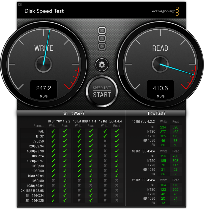

I have the Samsung 830 256GB in a Seagate Backup Plus Thunderbolt enclosure 2.5" (not the Go Flex, which is the older model), and Blackmagic reports ~320MB/s writes and ~365MB/s reads. It's blazing fast for my needs, and OS X loads before I can blink. :)

Well here's my xbench 1.2 results from the Samsung 830 256GB in Seagate Backup Plus Thunderbolt enclosure connected to my 27" 2012 iMac. It's my boot drive. No idea how accurate it is. Like I said, Blackmagic reports 365MB/325MB read/write speeds (which, as mentioned, doesn't tell the whole story).
Results 476.67

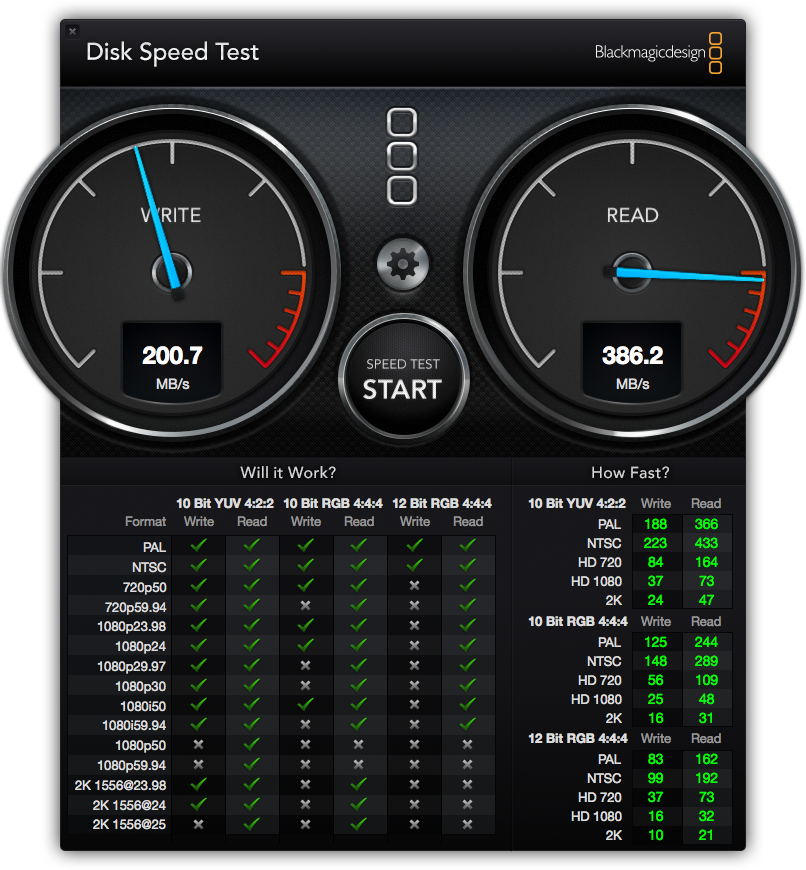

I just tested the Samsung 840 Series 500 GB in 2 different enclosure in USB 3 on my new imac core i7 8go ram
I get better result for read speed with the lacie thunderbolt 128Go SSD
the first is an generic enclosure usb 3 with samsung 840 series not pro 500GB
the second silver river 5g with samsung 840 series not pro 500GB
the third lacie rugged thunderbolt 128 SSD
as you can see it's better to buy good enclosure usb 3 for best performance

FYI, I had forgot to mention, but I get the exact same speeds using Seagate's non-bus powered Backup Plus 3.5" adapter. So in this case bus-powered is not the issue.
Jeantro, the Lacie TB adapter isn't very good anyway from all the reports. The Seagate Backup Plus and Buffalo Ministation seem to do better. And don't forget less CPU overhead from Thunderbolt...
Your test isn't conclusive since you also test a bad USB 3.0 enclosure! A good TB enclosure will give you about 390MB/s read and 330MB/s writes I'd guess, with that Samsung 840.
