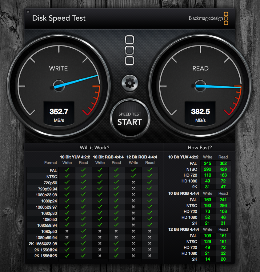

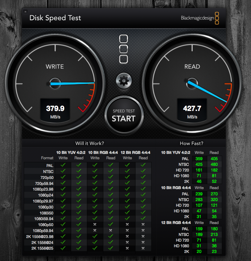

I got the exact setup. Swapped out the 1TB HDD with the samsung 840 evo 500gb. (I use this for my on location backup drive)
Here's the speed via thunderbolt.
Comparing this to my new acquired angelbird ssd2go pocket 512gb. I love the size and built of this drive, but the cable is too thick compare to my TB lacie.
I guess the thunderbolt was throttled by the enclosure itself.
