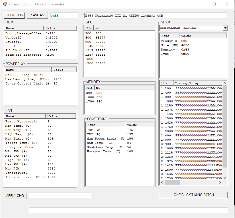

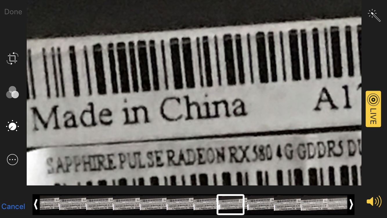

Posting this here as its more relevant to this thread, I had a chance to flash an original Sapphire Pulse RX580 ROM from TechPowerUp, went ok, unique superposition bench mark was a little higher than the previous, anyway idle hands so I played with the settings in Polaris, saved to new file, I didn't apply the one click timing patch, should I have? it wont boot now, stops on startup saying amd driver issue. Popped in gtx680 with monitor attached in slot 1, rx580 in slot two, wouldn't boot says I need connect external power cables which are already connected to the GTX680, so Ive bought a cheap GT120 on ebay on its way, hopefully I can reflash the rx580 when it arrives
I did try the atipatcher, I did try uninstall AMD drivers and reinsert the card to no avail, have I missed something?
Other post

View attachment 852556 Posting this here as its more relevant to this thread, I had a chance to flash an original Sapphire Pulse RX580 ROM from TechPowerUp, went ok, unique superposition bench mark was a little higher than the previous, anyway idle hands so I played with the settings in Polaris, saved to new file, I didn't apply the one click timing patch, should I have? it wont boot now, stops on startup saying amd driver issue. Popped in gtx680 with monitor attached in slot 1, rx580 in slot two, wouldn't boot says I need connect external power cables which are already connected to the GTX680, so Ive bought a cheap GT120 on ebay on its way, hopefully I can reflash the rx580 when it arrives

You flashed a RX580 ROM onto a RX570?
The screen captures from that "other posts" shows that you have a RX570.
Sapphire.RX580.4096.170302
This rom flashed no problem, only after i modified it, saved to new file and flashed it, the OS stalls and reports AMD driver issue.
You should NOT mod the voltage pointer to an unknown number.
The original ROM voltage pointer is 65282-65288. Anything outside this range may brick the card.
If you read my post #1, I only recommend use pointer 65283, but not any non exist voltage pointer.
