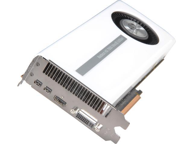

So here's the Sapphire HD-7950 Mac edition's outputs:
- DVI-I
- HDMI
- Mini DisplayPort
(image source: Newegg.com)

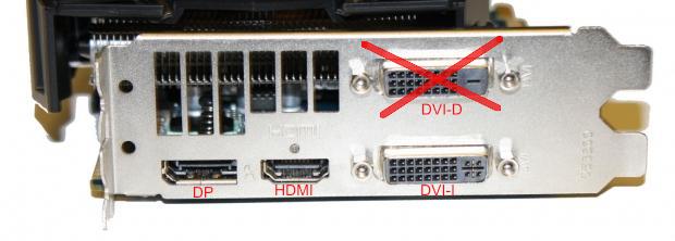

And my Sapphire HD-7950 Vapor-X OC boost:
- DVI-I
- DVI-D
- HDMI
- DisplayPort
(image source: TweakTown)
So between the two there's an additional DVI output in my Vapor-X, both have HDMI and both have a variation of DP.
As far as I remember I tested the HDMI output and it works both with the original and Mac-EFI patched BIOS within MacOS 10.13.6, so that's good news. But how about the Mini DP vs. DP port -does it work the same?
I don't have a DisplayPort cable to check out with.
- DVI-I
- HDMI
- Mini DisplayPort
- DVI-I
- DVI-D
- HDMI
- DisplayPort

The DP usually can work (even though you should still test it).
The HDMI port usually is the dead port. But in your case, it works. However, it seems the extra DVI port is dead (which make sense if the original Mac EFI has no code for the 2nd DVI port).
Its not only the Mac EFI, problem is the framebuffer-personality: There is no framebuffer for 2 DVI-ports!
Second DVI won't work w/ osx until modding system files, thats the way the hackintosh community made the ports working.

Yes. I understand the HD-7950 comes in many different variations with different ports, so unless someone with a Vapor-X can comment here I should just buy a DP cable to try it out.
If I can use the DVI-I and DP ports for two monitors in MacOS I'm OK with the broken DVI-D port :)
Interesting. So the Hackintosh community have made a GPU driver which makes both DVI ports work? Is this something that can be adapted for use in a normal MacOS/Mac hardware environment as well?

I've now gotten hold of the cables and found out that after Mac-bootscreen EFI reflashing of my Sapphire HD-7950 3GB Vapor X I've only lost one of the two DVI ports. The DVI-D output now no longer works in MacOS, but all three others do, so I can still use two screenn (even though ideally I'd like them all to continue working).
I've tested the GPU-card with two displays with different combinations of using the three available ports and all combinations work.
One of my displays only has two DVI ports and VGA, but fortunately the other one has DP in addition to DVI and VGA, so I can use thm both together with this card :)
I want to add that I found a HDMI to DVI cable and it worked fine with the above GPU card! So even with just one DVI output of the GPU card (and missing HDMI and DP ports of an older display) there appears to be other solutions like this 👍
Is it correct to assume that with digital outputs (DVI-I, DVI-D, HDMI, DisplayPort) it's more or less just a matter of using physically different connectors/pinouts? So using for instance a HDMI-DVI cable would work in the exact same way as a DVI-DVI cable?
No, it isn't.
HDMI and DVI are very similar, both use TMDS-standard and DVI can usually converted to HDMI with simple passive adapters, but usually not other way round, because newer standards of HDMI offer more bandwith.
DP uses different protocol LVDS and is incompatible to DVI and HDMI, but most outputs/GPUs can switch to a legacy TMDS signal which is accessible with adapters.
