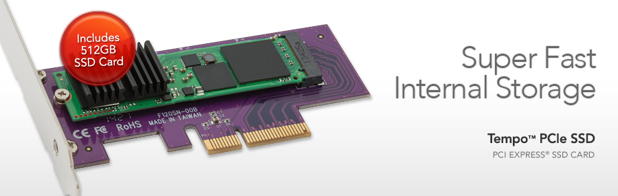

Sonnet Tempo PCIe SSD
Just saw this on Sonnet's website. Not that impressive - oh when will they relase dual-slot PCI-E SSD adapters!? I don't want to waste my PCI-E slot!

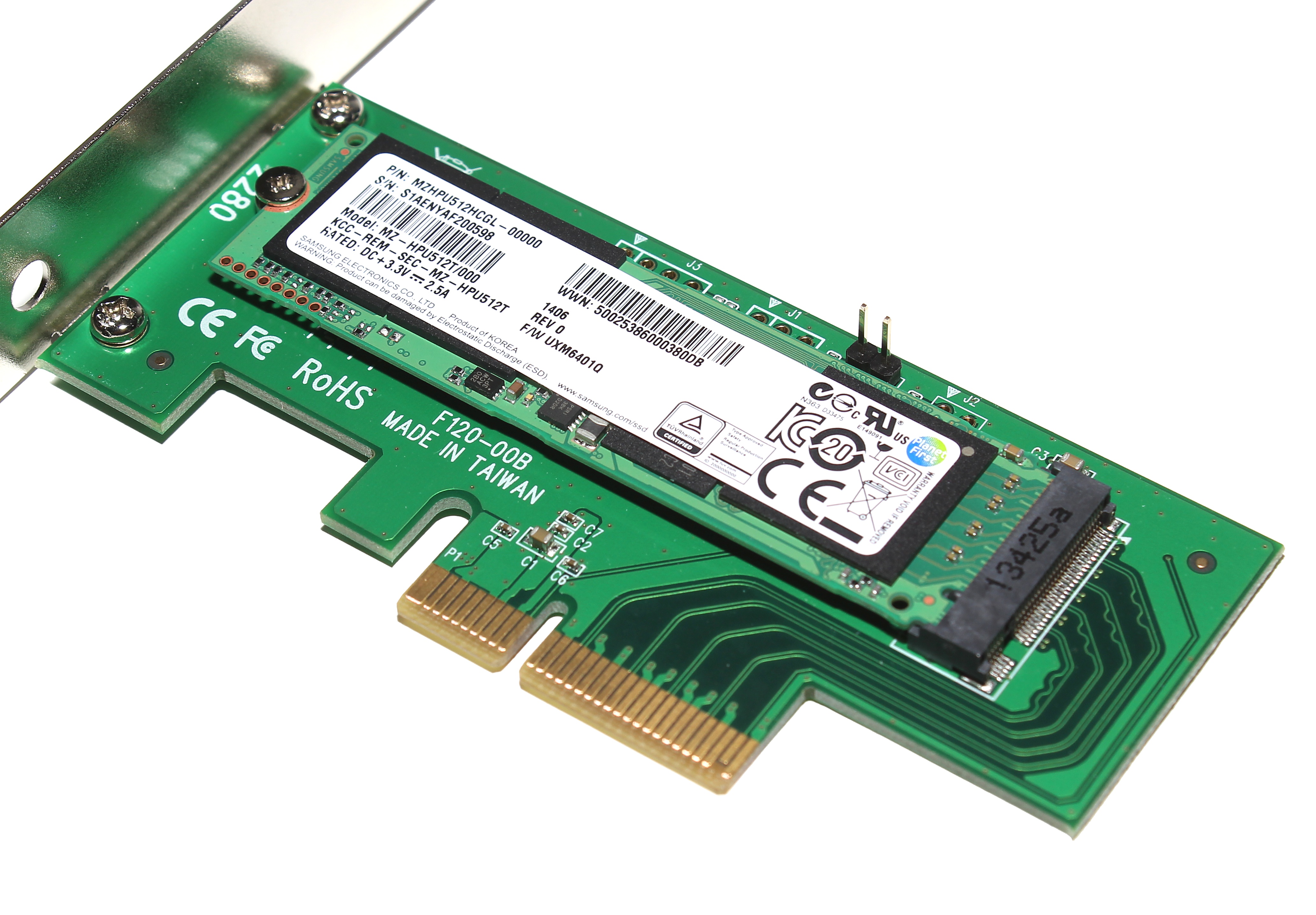

Thanks for sharing! (great posts everyone) Can't wait to see Sonnet drop their prices to be competitive in the market. FWIW.. It's a purple Lycom PCIe SSD adapter, less the LED lighting post with SN added to the part number. Worth $799... Not!!
Smart Purchase: Sintech Adapter $10 + 1TB Apple SSD = $600ish delivered.
Almost Smart Purchase: Lycom Adapter $23 + Samsung XP941 $499 = $550ish delivered.
Sheep Purchase: Sonnet Tempo PCIe SSD = $799. Baaaahhhhhhh!
Is removing a sticker from a XP941, adding a $.05 heat sync and a purple PCB worth $200+?
If they spent .25 more, they could have added a LED light to the back of the card to let users know the card is plugged in.. hahaha. That's that the small hole in the PCIe bracket was designed for.
Sonnet (and also OWC) do not have an unique selling proposition anymore, since people can buy the adapter cards and PCIe SSD's separately. **** happens. :cool: Ok, OWC is much cheaper.
Yep it's pricey and we still have yet to find out how it performs and maybe Sonnet might bring down their pricing.
Performance of the Sonnet is already known (see handheld's post above). Unless purple PCB, lack of jumper and Samsung sticker gives a noticeable boost over DT120 + XP941... :rolleyes:
