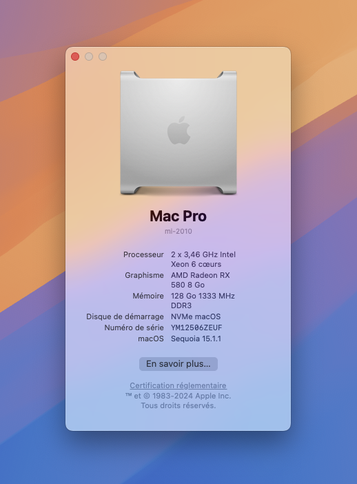

I have the same computer and the same WiFi-Bluetooth chip, and it works for me. Have you tried reinstalling the root patches from OpenCore again? It should show up as 'Modern Wireless.'
If it appears but doesn't work, check to see if any of the antenna connectors have come loose. This can easily happen.
What doesn't work is transferring all the data. You need to do that in Monterey and then upgrade to Sequoia.
In Sequoia, USB cameras don't work yet. However, they do work in Sonoma
Indeed, it works perfectly for me too.
Sorry for not taking the time to come and tell you that everything was working on Sequoia 15.1.1
Except my Logitec Brio Camera in USB connected on a fast USB 3.0 on the backpanel :(
So, still no USB webcams on Sequoia. :( It's cruical for my job to have webcam, so no upgrade for now. Is there anyone with 14.7.1. that can confirm that USB webcam works? I am still on 14.7 because of that.
