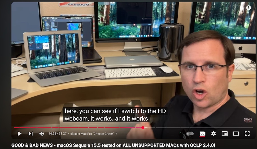

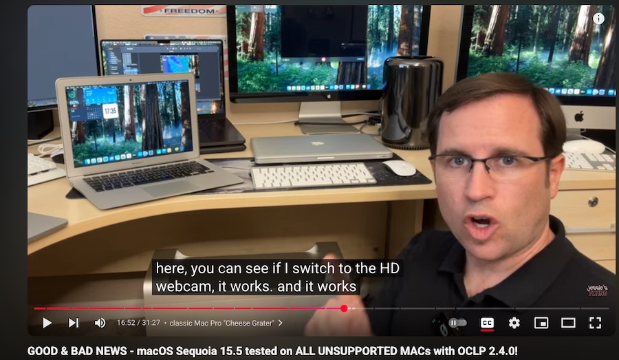

Hello. @Mic-M4c Some great news. Been praying for a fix. A Youtube blogger, Jessie’s Flying tested the OCLP 2.4.0 on his 2012 Classic Mac Pro and now the webcam works fine. The camera also works on his PCIE USB3 card. Below is his video. One note, you’ll need to jump to 16:00 mins as that is the clip he shows the camera works. Thanks @Frixo Cool 🙏 👍
Video on OPCP Test
Reactions: Frixo Cool
I can confirm that the problem is resolved! :) OCLP 2.4.0 allows third-party USB webcams to be used normally. Our beloved Mac Pro 5.1 will live even longer!
