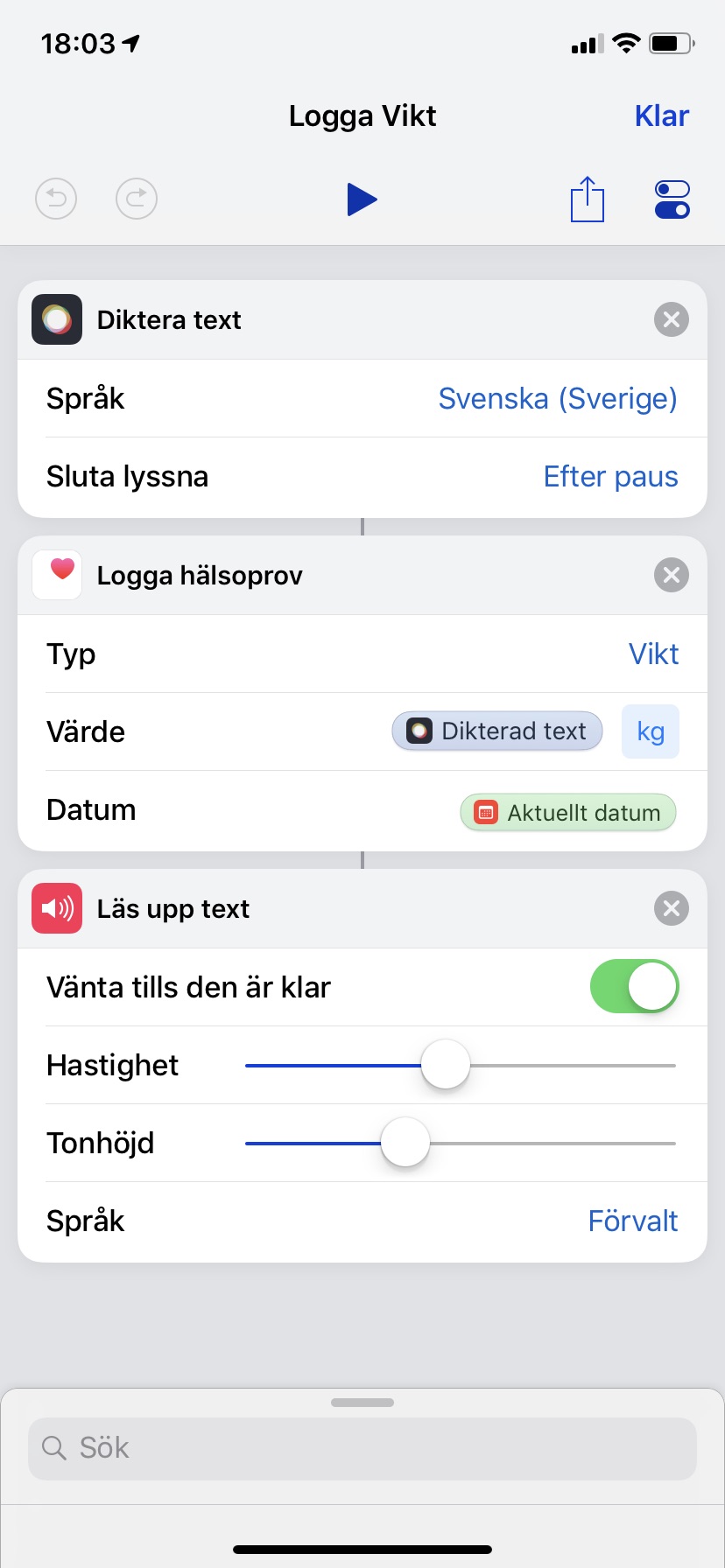

Sorry, here it is:
Version 2.1
Thanks. I just built this same Shortcut (using imperial measures rather than metric). I dictated a measure with a decimal in it and it logged into the Health app with the decimal intact. Using 12.1 and 2.1.
Try deleting and re-adding the Log Health Data action. Who knows, that might reset things.
No difference sadly..

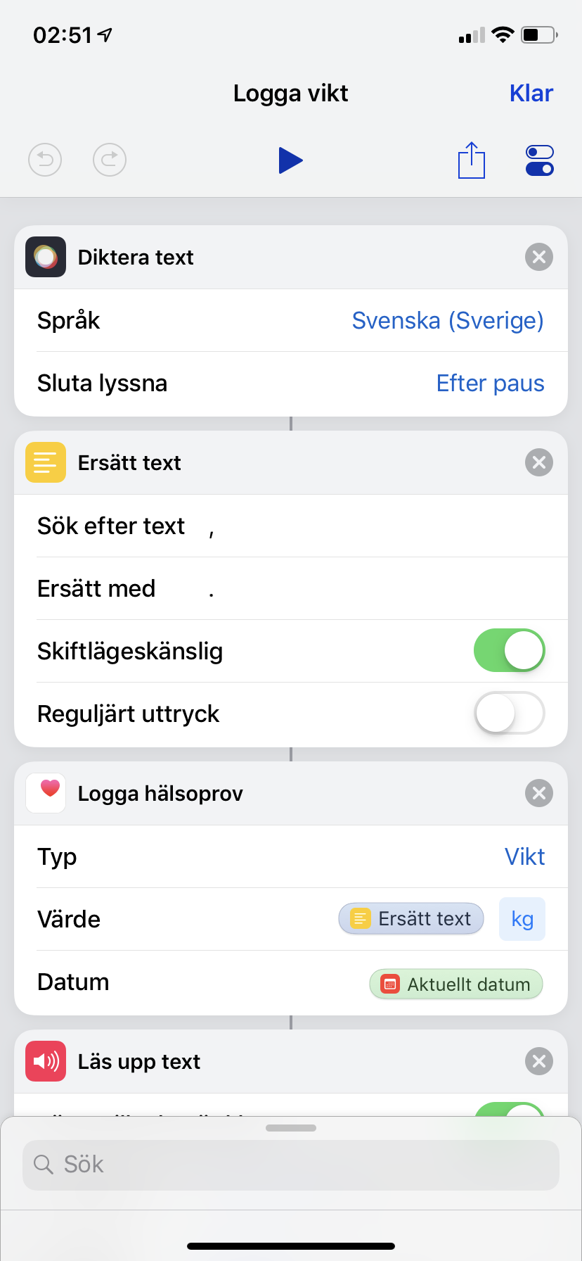

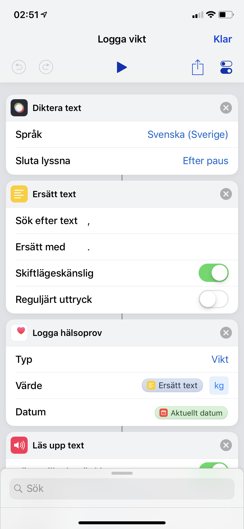

Just a followup.. I solved this by converting the , with a . in the dictated text as in the screenshot.
The healthapp seems to only accept numbers with a ”.” even though it displays datapoints with a ”,”. Must be some regionalsettings”bug” or something since the last 12.1 or 2.1 update.

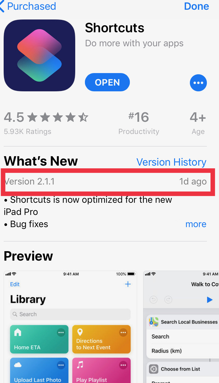

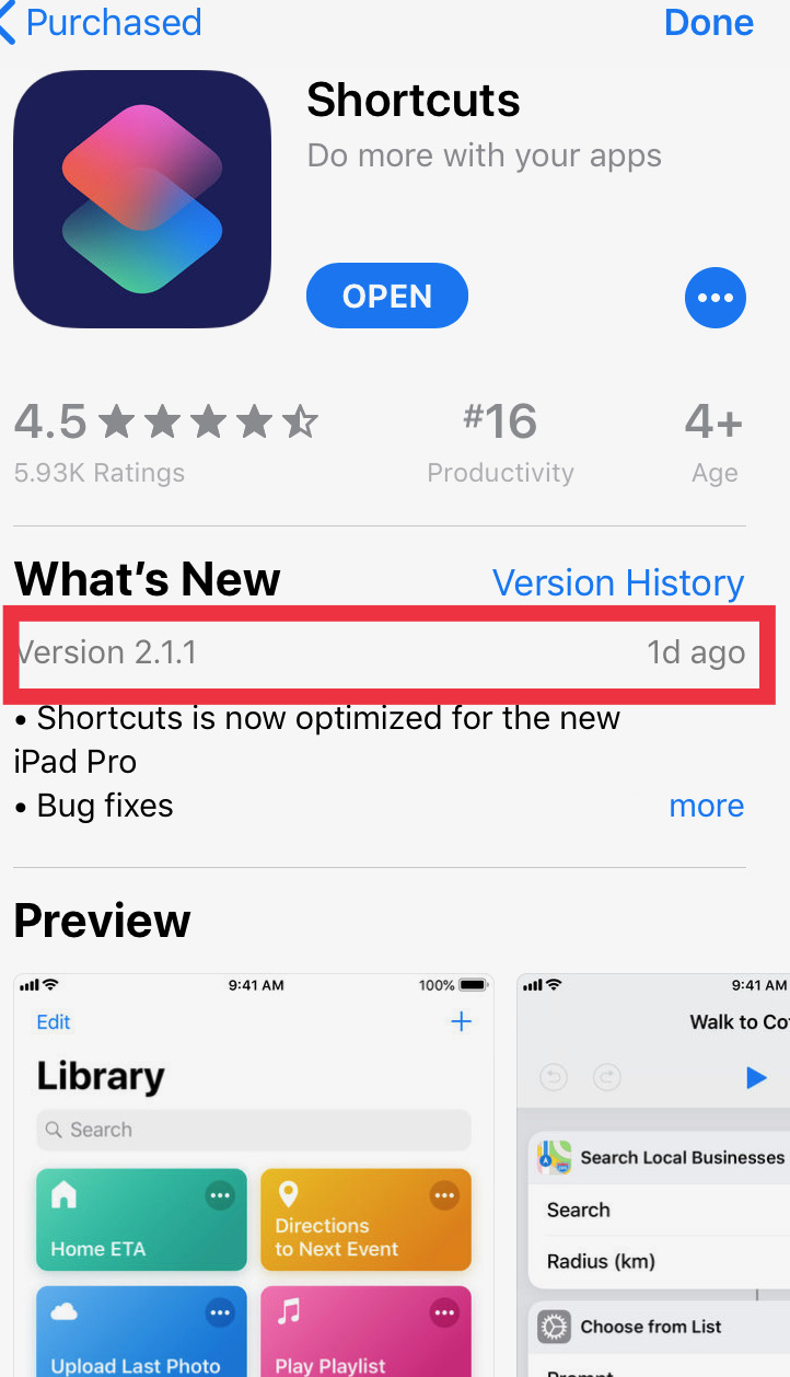

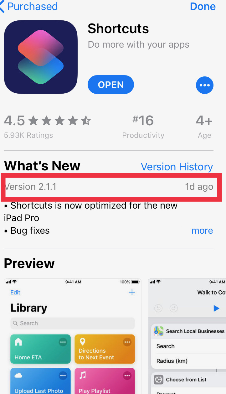

There is a 2.1.1 update today. Among the fixes:
  • Fixed an issue where entered decimal numbers may not be recognized properly in locales that use a comma as the decimal separator
https://support.apple.com/en-us/HT209087
Shortcuts app latest update 2.1.1 fixes the issue with flashlight and it works now.
I actually thought about that but (wrongly) assumed that they had localized Shortcuts/Health. I would report this an issue, if you can.

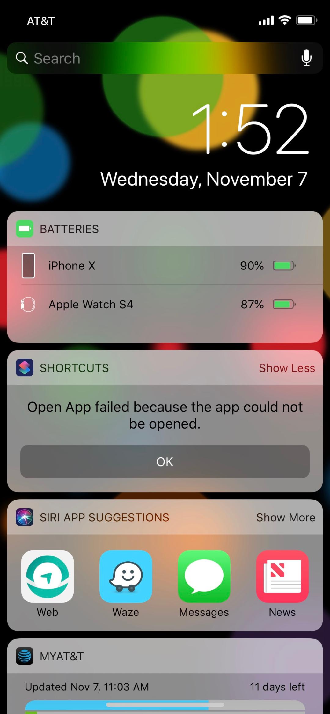

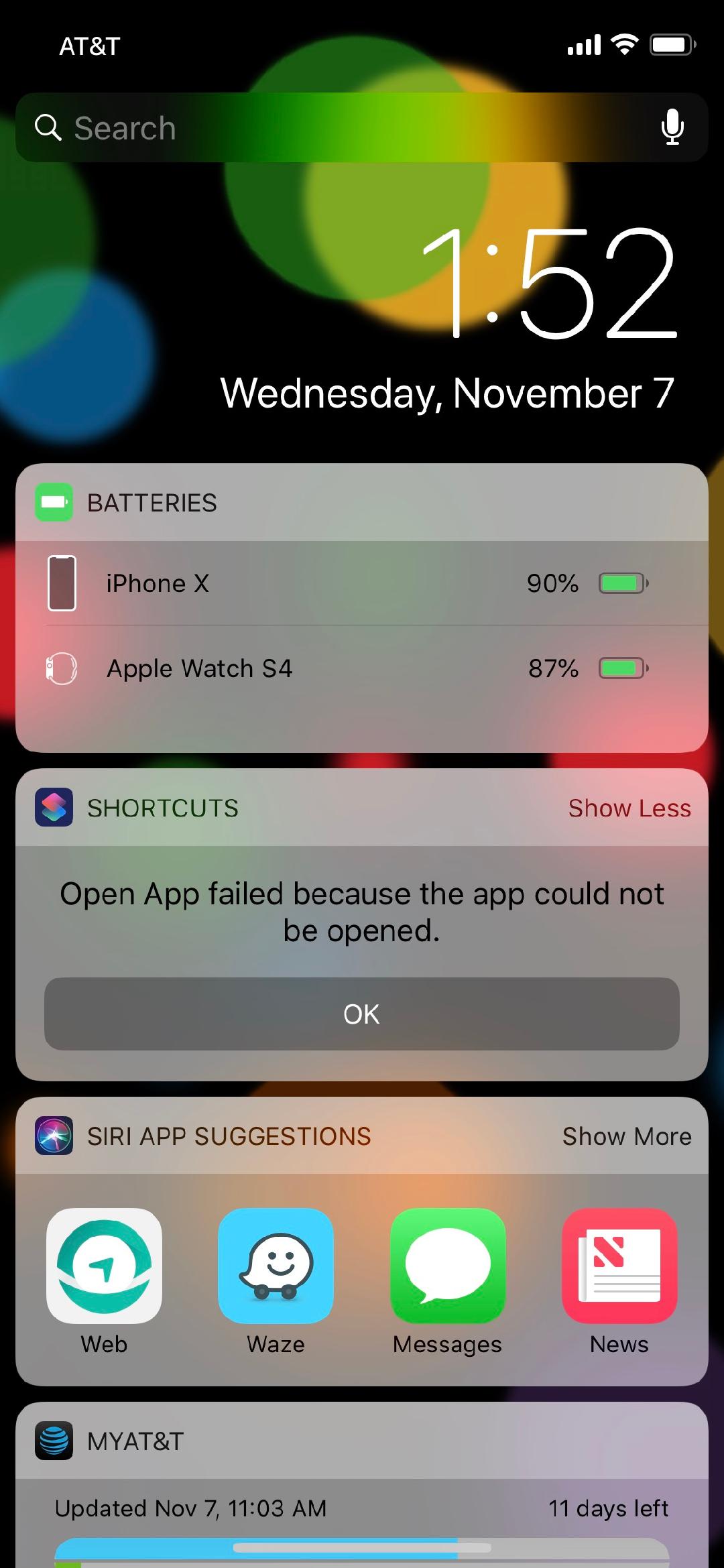

Anyone able to run any apps using Shorcuts with latest update? I keep getting error. My shortcut is just to simply open an App. WTF Apple??
Ran a Shortcut today that launches two apps with no issue. But earlier version of Shortcuts, one of the apps would crash while starting (work-around, temporarily replaced with different app with similar functions) and the second app started, but gave a warning message about how it started. Not sure if it was Shortcuts or the apps themselves (did not pay close attention to when Shortcuts got updated and or the apps themselves).
But, yeah, Shortcuts are a work in progress.
